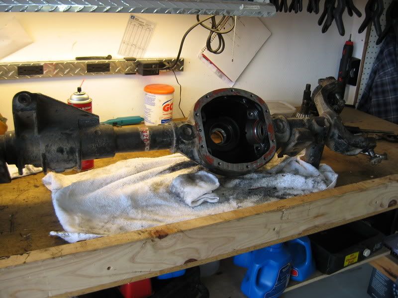

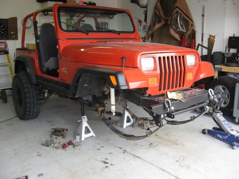

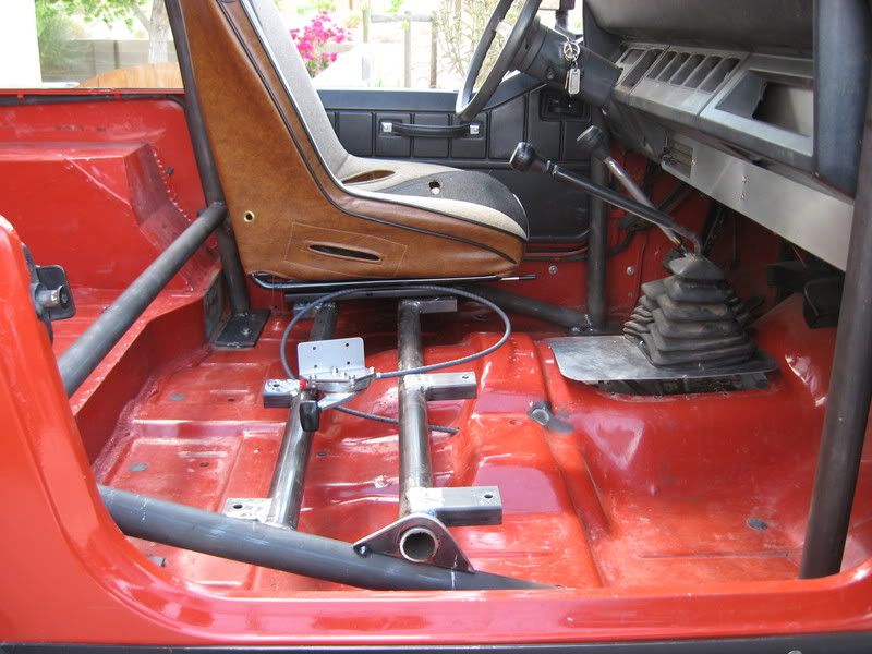

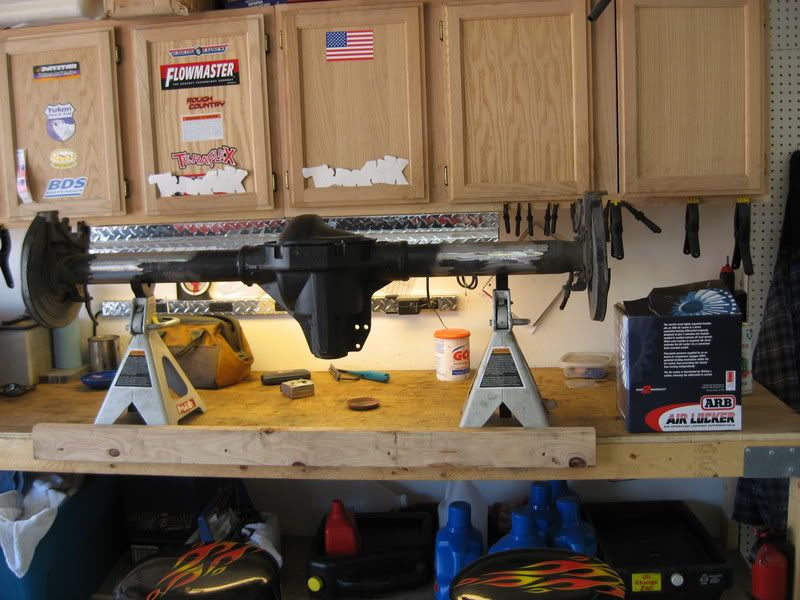

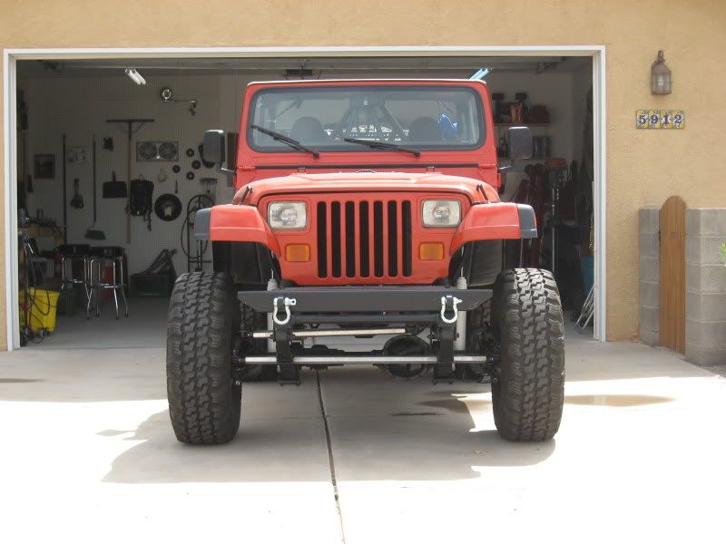

Well it's almost done I'm just waiting for the drive shafts to show up and figured I would post an update. This took a hell of a lot longer than I expected it would but I ended up doing more and things happen but here's some pictures. One thing I didn't do was take alot of pictures.

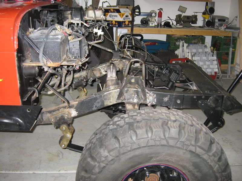

Shackle reversal, shock hoops, moved the engine 8" forward and the axle about 2
Klune and AX 15
The inertia Ring

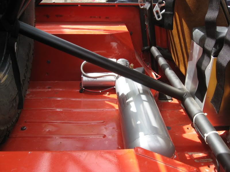

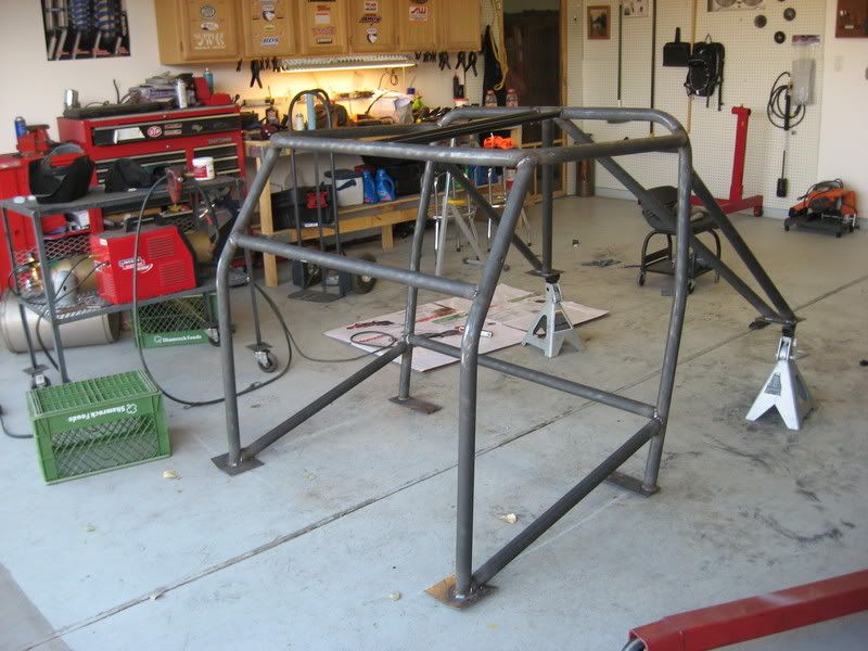

I bought a cage kit from S&W race cars. I made several changes and added a lot of tubing but didn't have to bend any.
Installed Mastercraft seats
Put the spare and highlift inside
Flat skid plate. I still need to cut it for the drive shaft.
Viair OBA. I put manual valves for the ARB too

Teraflex high steer kit

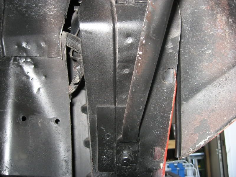

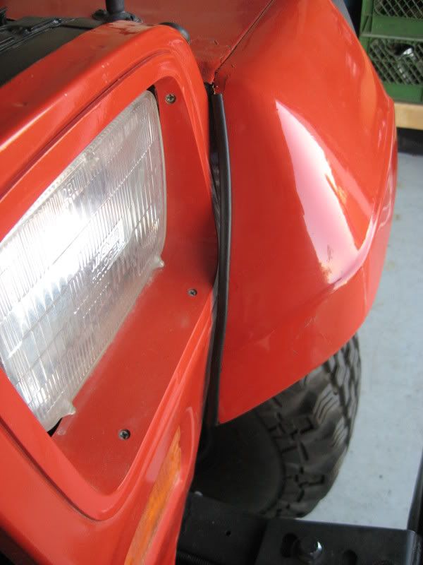

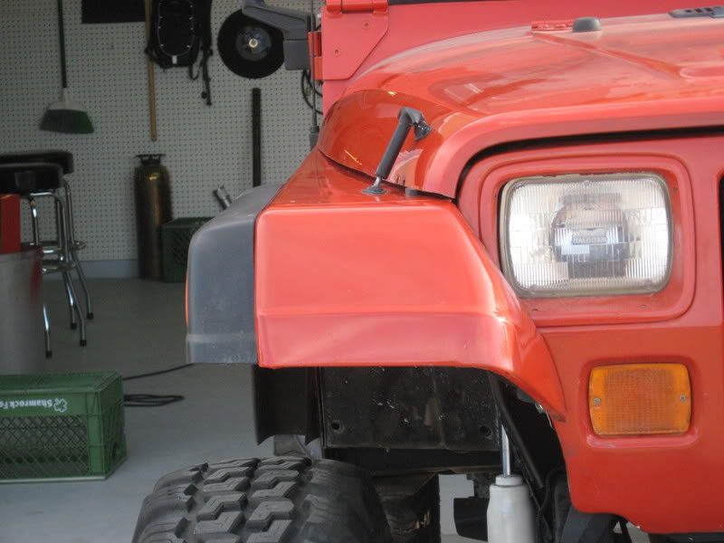

And the coolest thing. Home made highline fenders. I moved them up 3 1/4"
Maybe I can go wheeling next weekend instead of turning a wrench.

you have a writeup for your highline fenders? and some pictures of the inside of the engine bay. I've been thinking about doing this, i wanna see how it looks and changes the engine compartment. i'd be fabbing up flat fenders out of my fenders though, still gotta see it first right

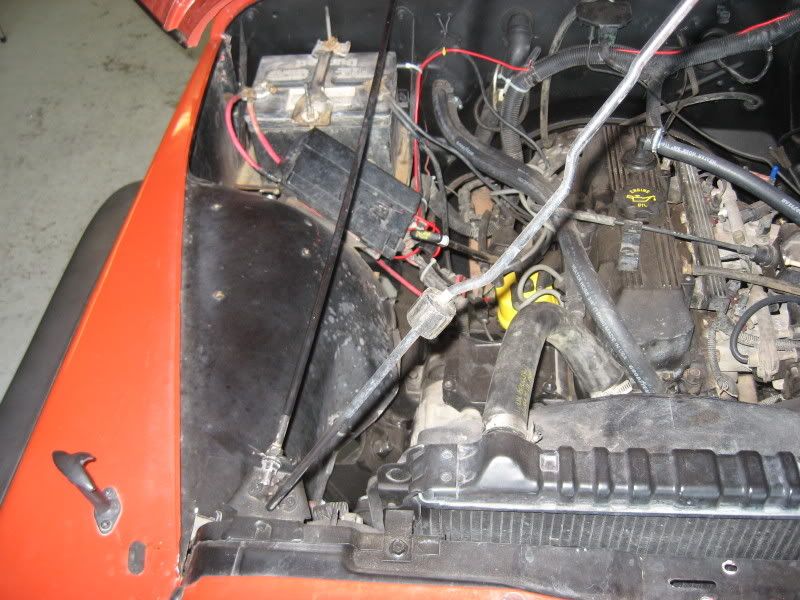

It was fairly simple to do. I just moved the fender up so that the lowest bolt hole matched the next one up. drilled new holes for the ones above it. Then made 2 vertical cuts to allow the core support to slip into the fenders. Then I formed the cut strip of the fender to the core support and drilled some new holes to bolt the fender to the core support. That moved the fender up 3 1/4 inches. I then marked and cut 3" off the hood. I will take some close up pictures tonight and post up.

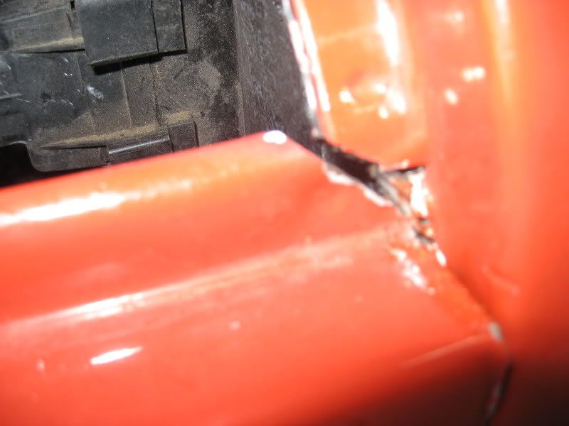

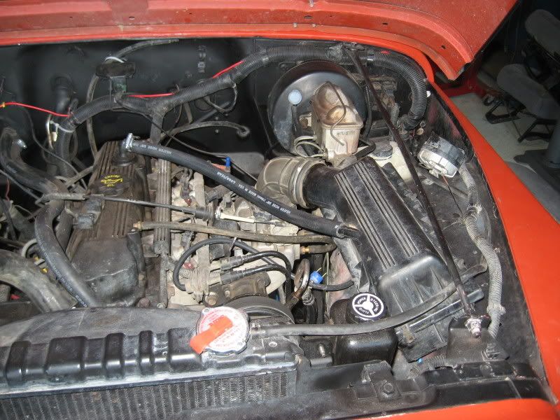

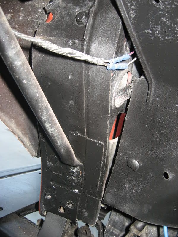

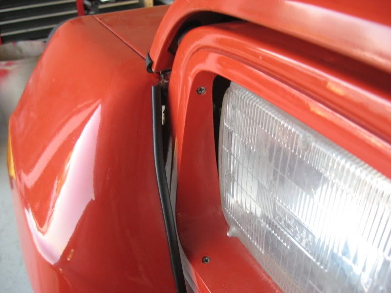

Ok, I hope you can see the cuts from these pictures. I also put some rubber door edging on the fender and hood cuts.
Need to cut the cowl/firewall lip and top lip of the fender
It kind of cramped the engine bay. I had to relocate the fuse box and cut 3" off the bottom of the air cleaner.

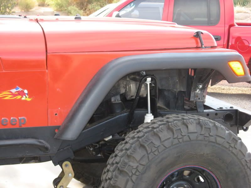

Posts: 227
Originally Posted by Jkanly View Post
That cage with the tire in the back like that is killer! Got a pic of the side of the jeep? I'm planning on doing the same thing with the 8.8 and 2" extension up front
Thanks!

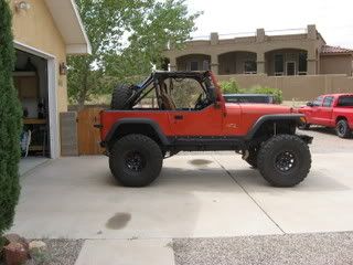

Side shots
