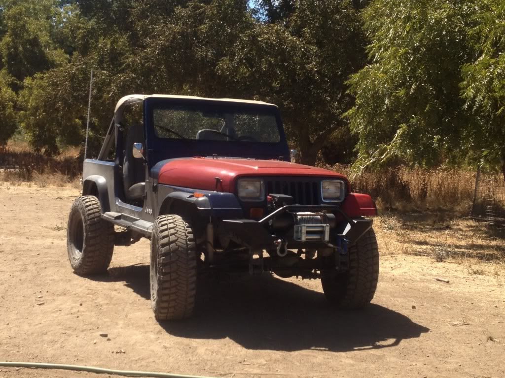

Go with OME or BDS. Here's a really old pic of mine on 2" BDS springs with TJ flares, and 33's.........
