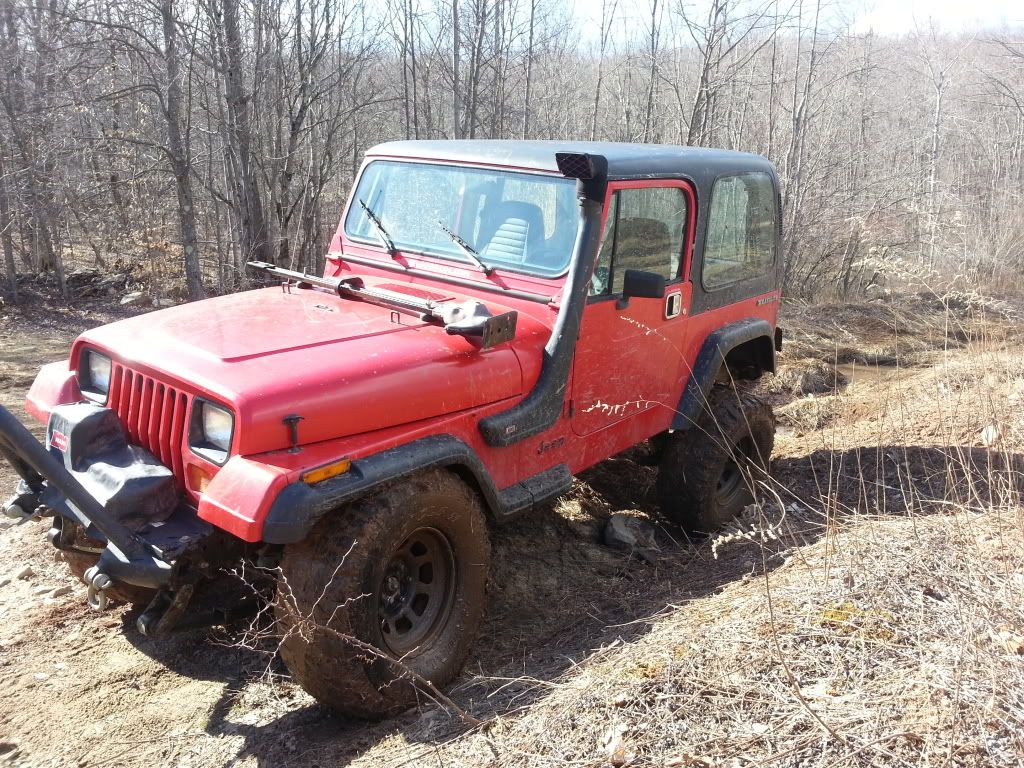

I did a H1 style on mine. Works great and don't get in the way of wheeling in the bush.
Ran the hose down to a spot I could punch it through the firewall and then up to the factory airbox. I went with the Donaldson cap as it keeps most of the dust out of the system before it gets to the air cleaner. Air cleaner element lasts much longer than if it was just a plain cap on it.

That h1 setup looks sweet as hell.... Any thanks for advice that's really all I'm worried about is the cutting but I have heard of anyone having a problem with it.

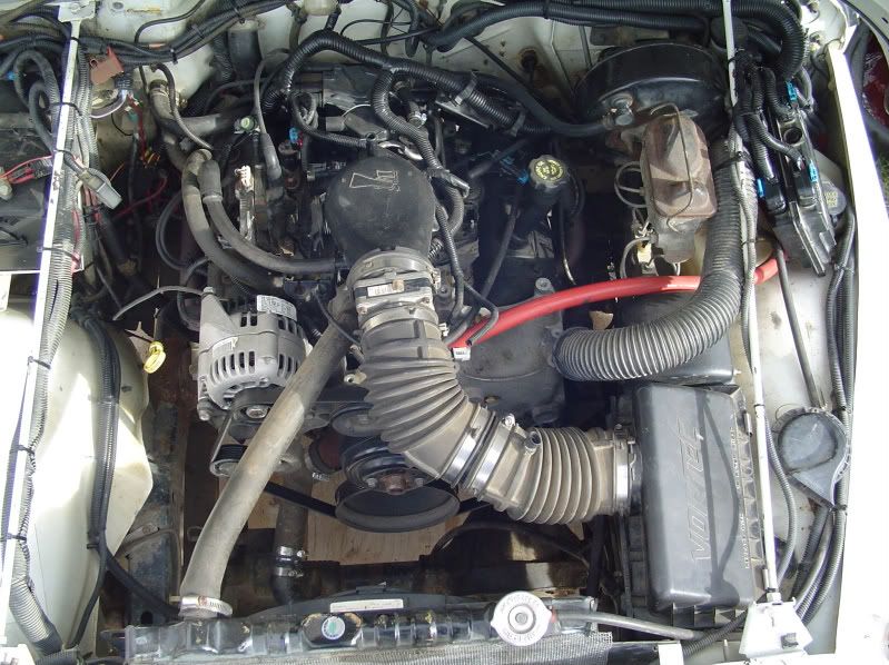

There was no mods or cutting into the airbox itself , just removed the stock elbow infront that originally directed the air from under the headlight, siliconed all the connections and this intake tubing from autozone slipped right on.
As you can see, my engine bay is coved in mud. My airbox used to fill up with mud every outing and I would change my filter atleast once a month. Now its stays dry and I havent had to change my filter since I installed it

You don't have to mod the air box? All the other air boxes I've seen have the air inlet on the side right where snorkel enters the body

You can see in these two pictures that mine does not

Yeah yours is the first I've seen like that. Did it come in the kit that way or did you have to mod that?

No kit, I just bought the ARB snorkel off craigslist for $75, sourced their template online and bought intake tubing, that length of exhaust pipe, hose clamps and silicone from autozone putting me at around $120 total.
FYI, I did have to relocate the windshield washer fluid bottle since thats directly in the way but theres only 2 wires that you have to extend and add in one length of windshield washer fluid hose.
I also saw a part at the store you could use to cut and seal into the side of the air box like all the kits do but I didnt feel like that was necessary, though it would look cleaner.
