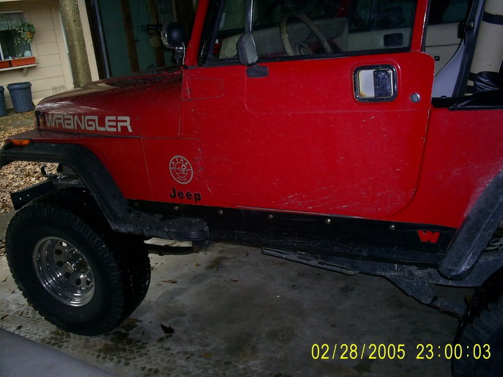

Do not know about smittybilt but I have a set of warn sliders for a 98 tj on my 90 yj. They great and work great as well. Here is a pic.

Smittybilt will not because it attaches to the body mounts and not the tub itself. Trust me when I say that it won't even bolt up to most tjs. It took three hours and the use of my grinder and blue wrench to get it to fit. The side armor on the other hand is interchangeable.
