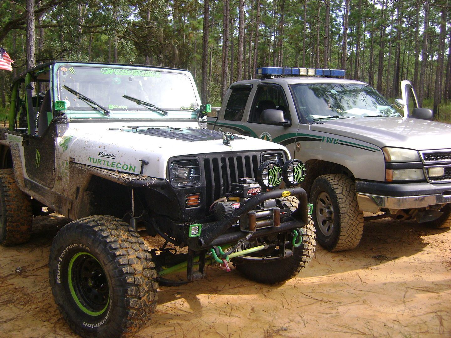

Whats the worst combination for bad acceleration?
Start off with a 2.5L engine with 250k on the odo.
Then add the 3 speed Automatic (30RH)
In addition will be 3.73 highway gears.
Top it off with 33x12.50 M/T and a jeep with surrounded with armor.
So thats what I'm working with..
However I recently had some connections on my ECU "re-connected" I found out that I have an overdrive in 3rd gear! It almost feels like a 4th gear. This is great! But..
My issue is I have what feels like no power from 2,000rpm up to about 3,000. This means accelerating through every gear, even cursing at 50mph I have to put my pedal to the floor just to move.
Before this issue occurred I had pretty decent acceleration, and could rev through my 3 gears very quickly. Now anytime I move I have to put the pedal to the floor.
Any common causes or culprits to this issue?
*pic for entertainment.

...curious... do you have shims on your front axle/springs?
Seems like an odd angle for your shackles to be in when parked on a flat surface
How can you tell? that's so much shackle!

despite that, it definitely seems like his axle is rotated forward.
i dont know what to say about the turtlecon except inquire: did you make this thing yourself? do you know if shims are there or not? Those shackles are leaning in the wrong direction of my comfort
