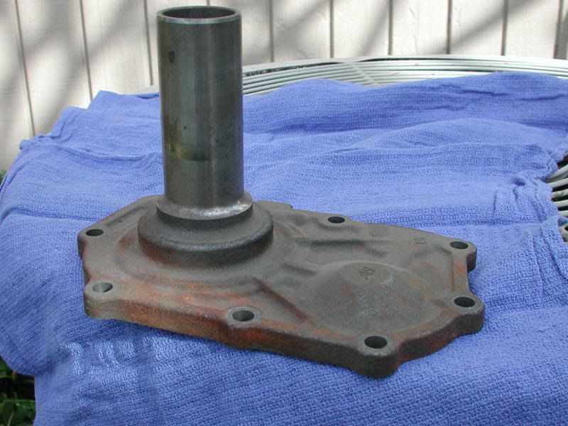

Get this stuff. This is an AX5. The bell, and everything in it you see, but of course don't reuse "wear parts." Like the Throwout bearing you see in this photo. The little spring clip holding the fork onto the pivot ball on the left side of the photo, you need that too, so get it and don't lose it. You can see the clutch fork, but not the front bearing retainer--well, the base plate so to speak but you can't see the long snout. If you're getting the whole shebang, then take it but you don't need to swap out your trans. It works as well as you know it, and the "new" one you have no idea of how well it would work. Don't want to install it and find it is totally boogered and have to swap your original back in. Just use your trans and keep the 95 trans wrapped up somewhere safe. Also, get the shifter/shift tower when you pull it.
Long snout front bearing retainer will look like this when you pull it off.

Ok , I went a different route. I picked up the bell housing and slave (external) for $50. So I need the fork for sure , do I still need to get a new long snout bearing retainer?
