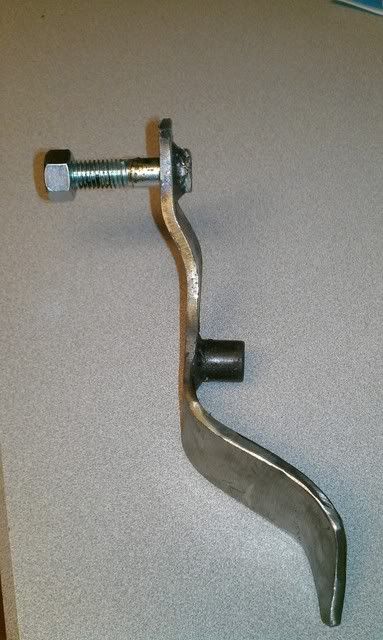

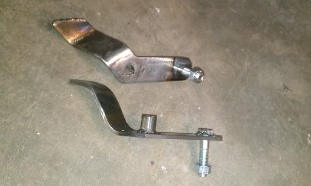

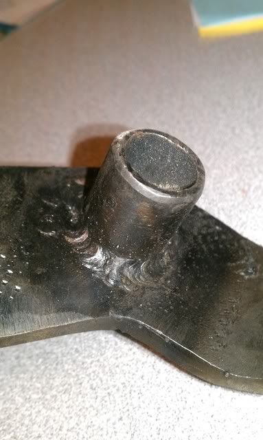

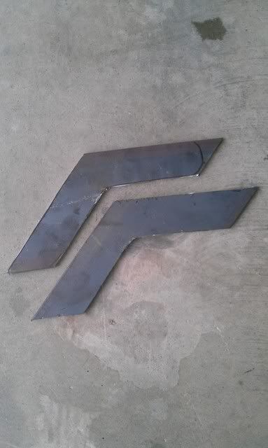

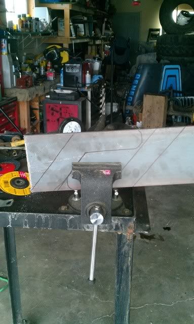

Ever since I installed the 8.8 I have been looking for a cheaper solution to the M.O.R.E. shock extension brackets so I decided to make my own. All it cost me was some scrap 1/4 steel I had laying around, some welding wire, and a few hours of my night.This is how it started.
Then used a BFH and a vise. and Walla!!
I ran out of time but I will get a pic of them installed in mock up.
Still gotta order the new shocks

Those should do the trick. Are you expecting ~2" of extension out of them?

Good job. They look like they'll take care of business. Are you going to weld the bottom end to the frame to keep it from rotating?

Thanks Guys! Both your jeeps have been an inspiration for mine. I think I am going to get about 3" of extension out of them it all depends on where they sit when I get the new shocks and and mounts on the axle. I did this to get the shock mount on the axle to sit flush with the bottom. I am using the shock mount that I cut off the Explorer spring plate and am going to weld it to the axle.
As Louie mentioned I will be welding these to the frame to keep them from rotating instead of bolting them.
I wanted to get the most out of my flex and since I run waggy springs I get a lot of droop out of them. The way I plan it the shock will be sitting at 20" at ride height. with the shocks I plan to get I will have about 4" of uptravel and about 6"-7" down ( I hope). I am running SUA so I want everything up and out of the way. I hope to get some pics up later this evening of them mocked up will my crappy old blown out shocks to give an idea of what it will look like.

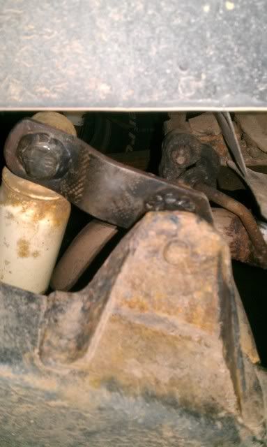

Ok I climbed under the jeep last night and tried a few things. As bgredjeep explained the shocks will be sitting at an extreme angle. I swapped sides with the brackets and angled them back towards the axle doing this didnt help my ride height shock length and may hinder my droop. I will have to run a slightly shorter shock (maybe) I really need to flex it out real good and get a solid droop measurment before I commit. I havent ordered my shocks yet so when I get some solid measurments I will place an order.

Looks good. Honestly, I don't think you would need or ever use the amount of shock travel you were initially planning for with a SUA setup. Not that it won't flex well, but that is a lot of travel, and since the shocks are inside the frame rails (not out by the wheels) you will have a lot more wheel travel than you have shock travel.

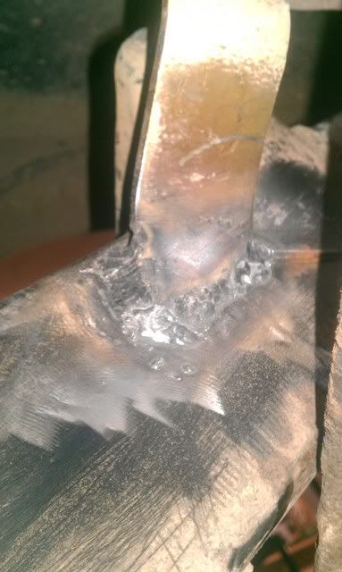

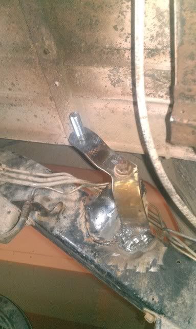

Just got in from burning it all together. It worked out perfectly my shocks are sitting at a nice 20* past perpidicular it was tough welding the upper mounts in though. now just gotta paint it all and wait for the new shocks to show up.
outside looking in.
dont laugh at my upside down welds its tough laying on your back and trying to fit your head and helmet up in a tight spot and weld. I still havent mastered the overhead weld yet
