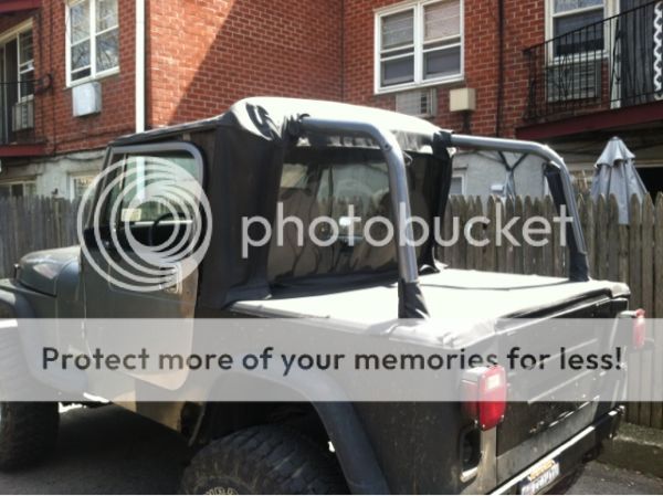

so I picked this heep up a few months ago. the left motor mount broke, so I drilled the bolts and easy outed them and it happened again so I got the brown dog left mount, problem solved. when the motor fell to the left it broke the radiator so I got a new radiator and thermostat since Id be flushing it anyway. the frame was rotted on the drivers side where the back of the side bar attached so I welded a plate there. As far as plans for it, well, that depends but I just sold the front and rear bumpers as well as the side "nerf" steps. ordered some steel for new bumpers. I need 2 shackles and a 2" receiver front and rear and thats it. I may use the front bumper as an air tank. got a few tops for it hardtop will be re-furbished this summer and this top is for sale, I like the standard top. I also need to find a regular spare tire since it didnt come with one

thats a sweet jeep

what brand top is that?

Looks like bestop halftop

The half top is a Rampage Cab Top and Tonneau combination. the rear window section is removable (Looks similar to a windjammer,but the window zips to the cab top). It requires the original soft top frame.
