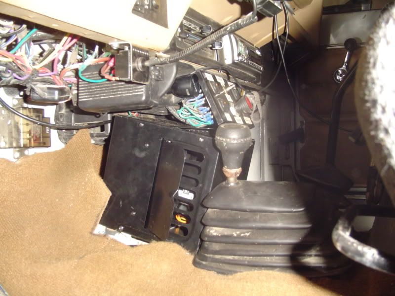

I know this thread is a couple of months old but I just got my hands on an aftermarket aux heater that runs off the coolant from a local club member that was parting out his rig. I tried replacing the core with a new one but it only helped slightly. The worst part of the install was getting the right location for the coolant hoses the first time. I have a 2" body lift so I ran the hoses out the transmission tunnel and spliced it in series with the stock heater with the aux being the first one fed with hot coolant. I put split loam over the hoses to add a bit of protection to them and only used the low and med settings of the fan since the high speed was almost double the currant (5amps) and not much more output than med was. Was also cheaper for a on-off-on switch at 15 bucks Vs 50+ for a off-on-on-on heater switch. I ran 12v from the battery to two relays and a switch running off IGN for power. Took a couple of hours to install and the time from cold to feeling heat has been cut in half. I'm using the aux for the main cabin heat and my stock one for the defrost. Works great and I only need to turn the aux on low for a few min before I have to turn it off because it's getting too hot. One of the best mods I've done so far and it only cost me about 40 bucks total for the install.
