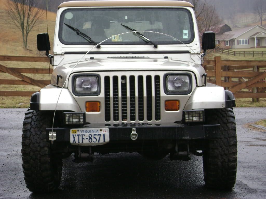

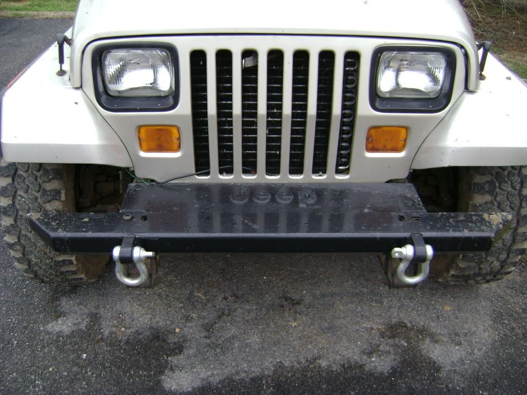

This past winter my factory bumper got tore off (hooked a chain to the D-ring, thought it would give before the bumper did, but it was stronger than the bumper) taking one of the threaded nuts inside the frame with it. I was going to weld the nut and frame corner back on, but I bought a bumper with D-rings and don't want this to ever happen again. After the minor frame repair would there be any major drawbacks to welding the bumper to the frame permanantly? I don't plan on changing it and I do have plans of building on to it. I've never heard of this and I'm trying to decide if this is a good idea or not. The way I see it the "stronger the better". And has anyone tested D-rings on Procomp's rock crawler bumper? They're not through welded, they're just welded to the front.
Pros and Cons would be appreciated.
From this:
To this:

if you can weld, I would just fix the frame with some sort of fab so that you can bolt it up. But I can't weld, so I may not know what I am talking about. Good lookin Jeep though Bro!

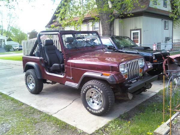

I modded my stock bumper and put D-rings on it. They got their first test the other day and I was surprised to see they held up pretty good. You can take that plastic piece between the bumper and grill off and there's two other bolt holes under it in the top of the frame (at least on mine there is), you could extend the back of your bumper and bolt it in their too.
