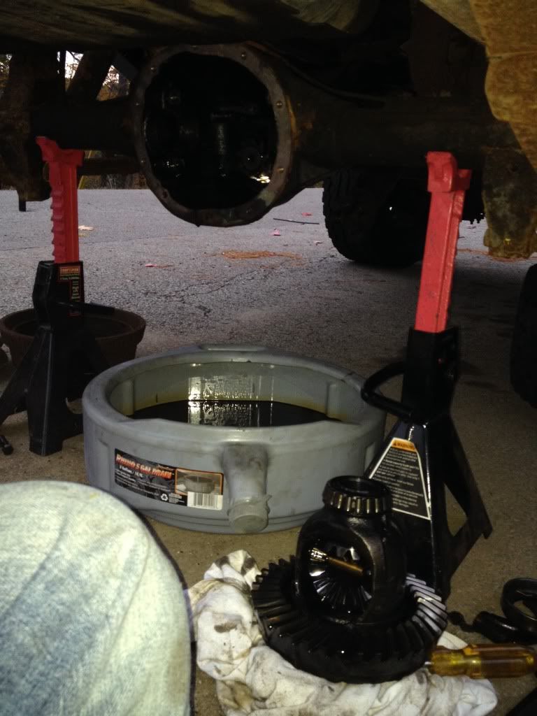

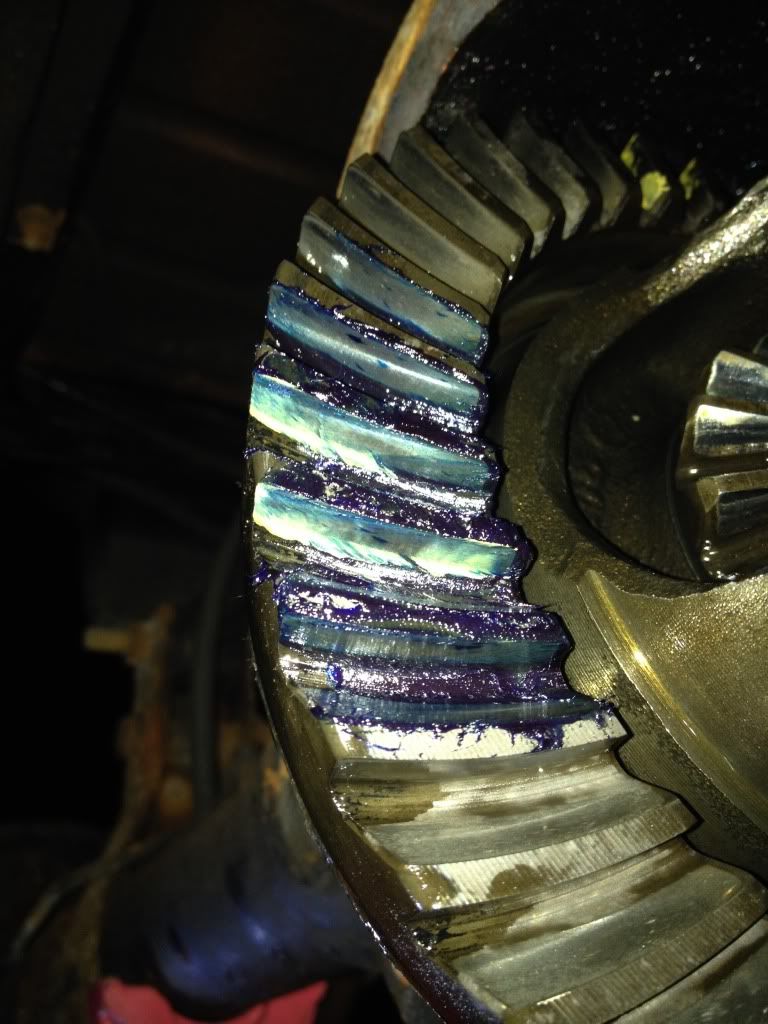

I got home today and buckled down on the jeep. Took me from 5p to 10p but I got both pinion bearings replaced.
My pinion preload ended up at 20 in-lbs which is smack dab in the middle of the range (15-25 in-lbs in the FSM). I will say that making that crush sleeve collapse is a ***** to say the least!
I then checked the backlash and landed on .008" which is within the FSM range of .005-.009". Ran the pattern and it looked good so I decided to button it up and all 4 are back on the ground now. Only thing left is to fill the diff with gear oil and run a test drive to see how good I did.
Here are the pics I have. Sorry I didn't do step by step like usual but I was mostly working in the dark and was trying to move fast
