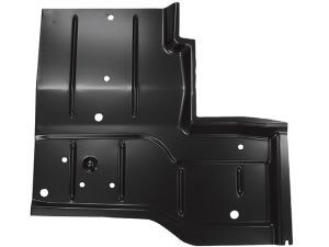

So I've been slacking pretty bad with repairing the Jeep lately due to a busy streak at work. Either way, it's getting warm and I'm getting antsy to do some wrenching.
During my frame repair i noticed the floor pans on the driver's side were pretty much roasted. So obviously I duct taped over the hole and spray painted it black to get it through inspection
Now that I have time to to it correctly, I ordered these from Q-tec
Only the driver's side was rusted through, the passenger was surprisingly intact so I'll be ripping the interior out (3rd time since owning this jeep) and welding in these pans. I'll most likely do bedliner and get rid of the carpet, which more than likely destroyed my floor in the first place.
I've been kicking around the idea of doing just straight black bedliner vs. the Sand interior color of my dash. I think i'll be good either way but any opinions guys?

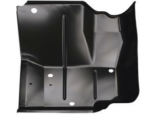

Brown Santa came today with my floor pans
