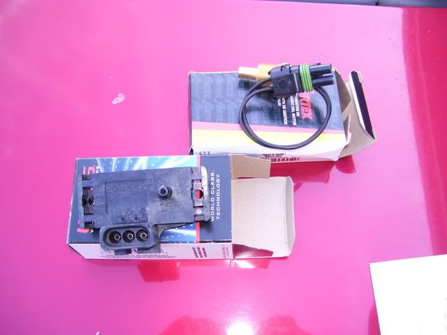

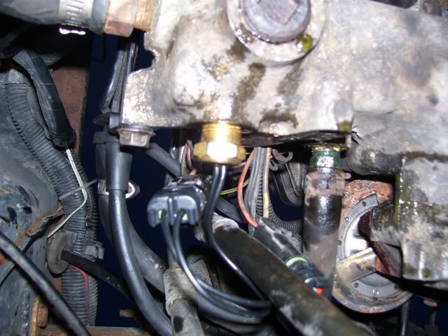

Replaced the MAP, CTS, and IAC components as well in hope of fixing my idle issues. These components helped the Jeep run better overall but the rough idle still continues.. here are the pics from that
New parts

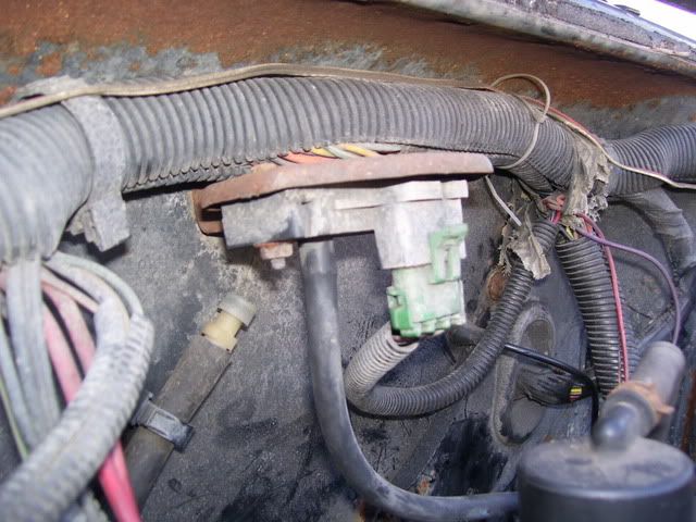

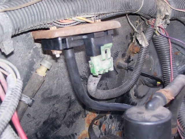

Old MAP and CTS sensor, both look like they've seen better days
Replaced by the new. Like I said previously, these did help out but didn't get rid of my idle problem completely

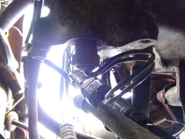

I also found out that my fuel injector was leaking so I replaced that, which removed by "hard start" issue when it was cold and after long runs on the highway. This is a pic from the TB rebuild that shows the new injector.

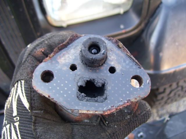

Since my idle was still not smooth i delved into the situation a little deeper and found this.. I'd say my EGR was at little worse for wear

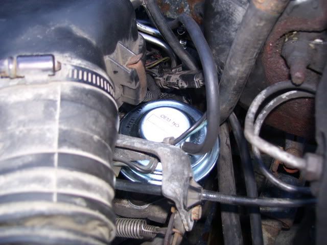

And finally after all the replaced sensors and TB rebuild.. the EGR is what fixed my idle for good. This could not have come any soon enough as I changed the oil in my daily driver this past weekend and came up with this..

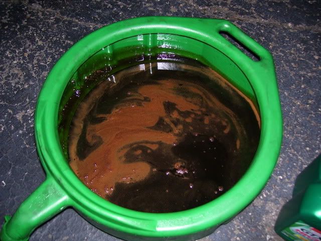

A nice layer of Dexcool antifreeze on top of my old oil.. blown head gasket. The weird part is the car still runs good, the seal between an oil and an antifreeze passage must have blew. The Jeep will now be moved to daily driver status until I can find another car to replace the POS cavalier.

Your CTS should be about 185 ohms at operating temp. Look into that. I've heard that the dealer parts are more accurate than the parts store replacements.

Trouble with the CTS is, that the computer uses it to tell when the engine is warmed up enough to trim the fuel and spark. It won't read the O2 sensor until it thinks its up to 190 deg or so... which is not happening here. Therefore its running too rich when it warm etc. If you want to try it, go to radio shack and get a 180-ohm power resistor for a couple bucks in the parts section. Stick that into the herness terminals instead of the CTS. It'll "fake" the computer into thinking the jeep is warmed up and normal. Only cost $2 to try it and see if any different in running. If it is different, then you know for sure about the CTS.
