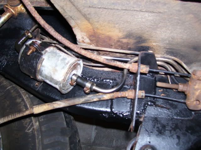

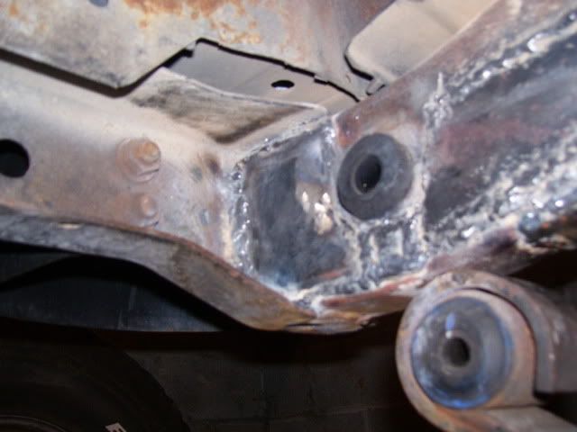

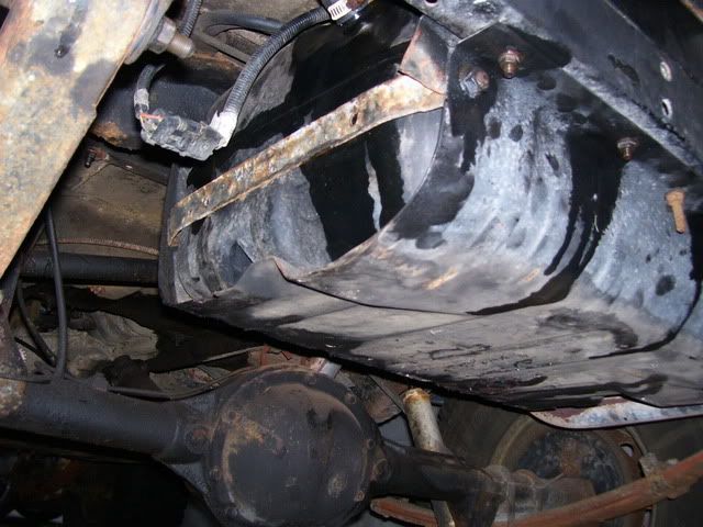

figured I'd start taking time while waiting for the compressor to catch up and start cleaning up some parts

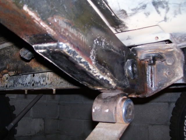

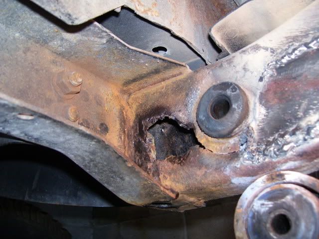

another hole popped up
plated.. couldn't get a tool in there to cut it all out
freshly coated w rust converter
that last pic is the completion of welding.. it's on to reassembly and off for state inspection

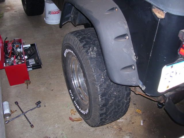

reassembly..
fuel lines/filter
gas tank back in (that's not gas.. it's WD40 to get the hoses back on easy)
for the first time in months.. all 4 tires are on the ground
moved out and idling
next stop.. PA state inspection

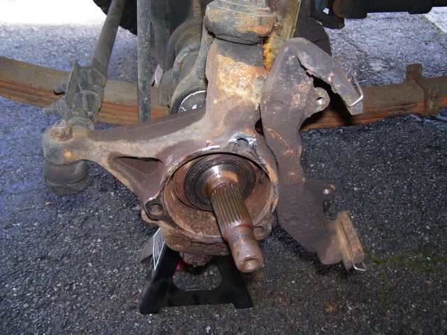

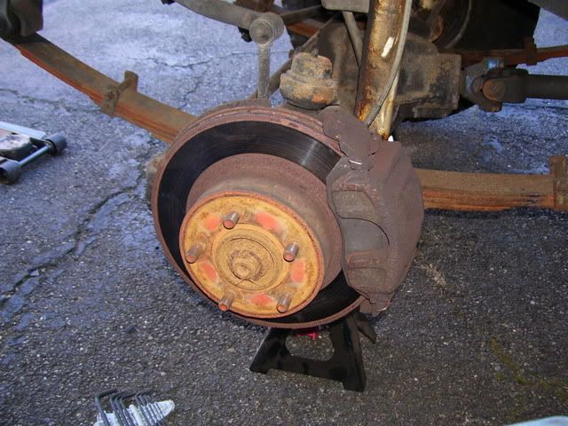

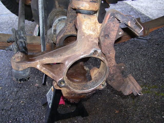

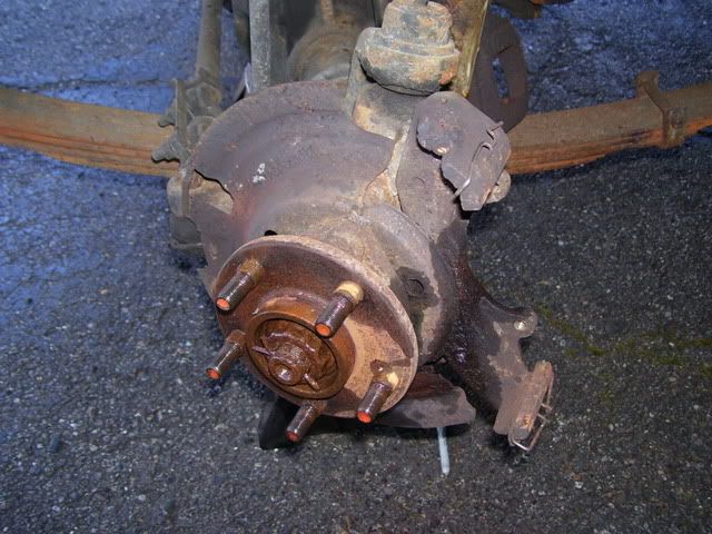

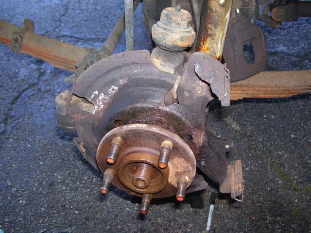

Started disassembling for replacing the ball joints..
took me a little work with a sledge to get the rotor off

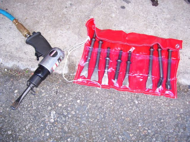

As far as i got tonight, I couldn't get the hub assembly out as it seems to be completely rusted to the knuckle. I'll have to take a trip to the store to look at an air chisel attachment this week.
schaef89 is offline
post #42 of 291 Old 11-09-2011, 12:31 PM Thread Starter
schaef89
Location: Pittsburgh, PA
Posts: 846

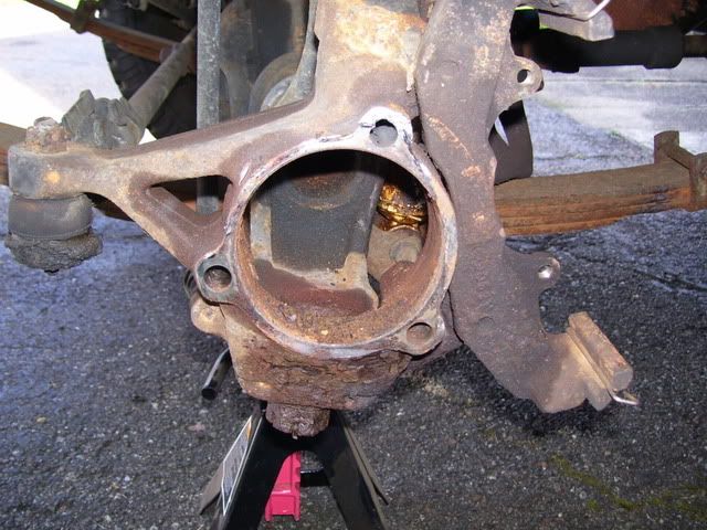

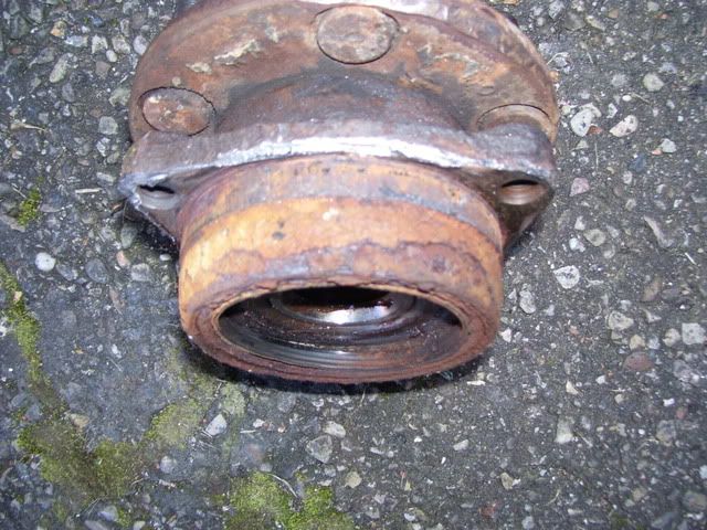

Got some work done on the Jeep today..
Since the wheel bearing would not come out with any tricks i've learned from here.. it was time to step it up a little
And after an hour or so with the impact hammer and a sledge..

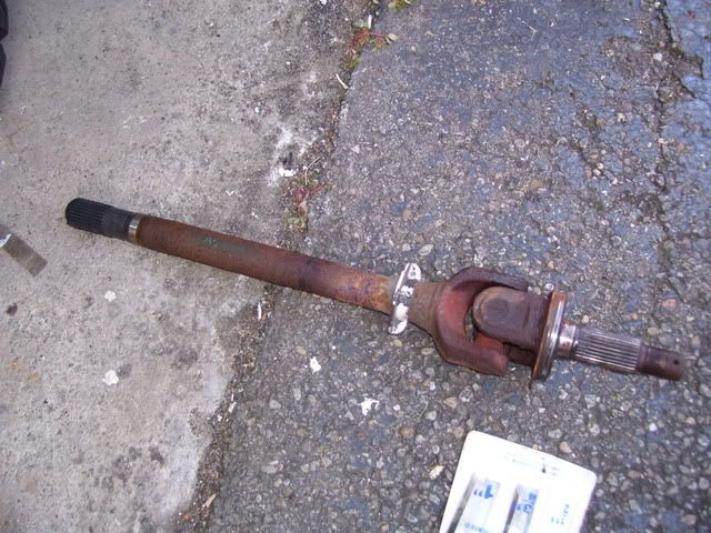

This will get a new ujoint
No wonder it was stuck in so good.. damn road salt

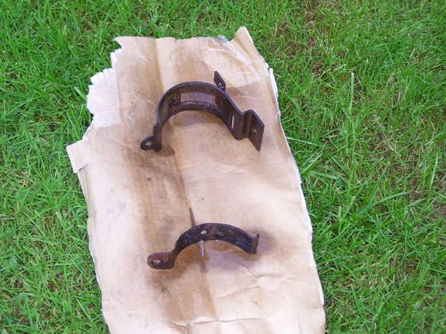

Got mangled a little but still usable.. it's been repainted and drying
Took the castle nuts off and cleaned it up a little.. waiting on the pickle fork set i ordered
Now it's a waiting game for ordered tools/a trip to advanced to rent the ball joint tool

So I ended up getting my tools from the brown santa during the week last week (pickle fork set, ball joint adapter tool for Jeep axles, cotter pins). I held out for the weekend so I could do things all at once and get it done and ready to take back to the inspection shop. They said when I take it back, all they'd have to do is a visual check to make sure I've completed what was required to pass inspection and they'd slap a sticker on it. I have a decent sized update from this weekend, so I'll get to it here..
The pickle fork set definitely was a saving grace getting the knuckle off.. it was stuck on there pretty good

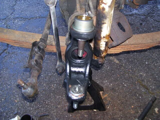

Here's a picture of the Jeep adapter for the Ball joint press. I ended up biting the bullet and buying the adapter, but I rented the press from Advance
Both ball joints came out fairly easy.. I was expecting a little more resistance considering the difficulty I've encountered getting to this point
This is where I came to my first speed bump in this installation. My FSM calls out a special socket to remove and install the set screw for the lower ball joint, shown below. First one is the one in the knuckle and the second is the new one that came with the new lower ball joint.
Now since this special tool costs about 90 bucks and is a really rare part.. I decided to sacrifice one of my impact sockets to fab up the special tool.
Here's a picture the old set screw coming out
And here's me using my modified socket to screw in the new set screw. The socket is basically just four nubs in a cross pattern across the socket's center
After I got that all taken care of I turned to installing the new ball joints. I didn't run into any really big issues with this, especially with the use of the adapter kit. Ended up going with Moog for the ball joints
Then I moved along to replacing the axle shaft u-joint since it wasn't as moveable as it should be
Definitely not in the best of shape.. haha. On the two rusted sections, the needle bearings were actually rusted fast to the inside of the cup and to each other
Installed a heavy duty u-joint and repainted the axle. I ended up having to make an emergency run to Advance to find u-joint retaining clips that hold it in the yoke, my u-joint did not come with them and i broke two removing the old one.
And here's where the pace started to pick up because I could start to see the finish line

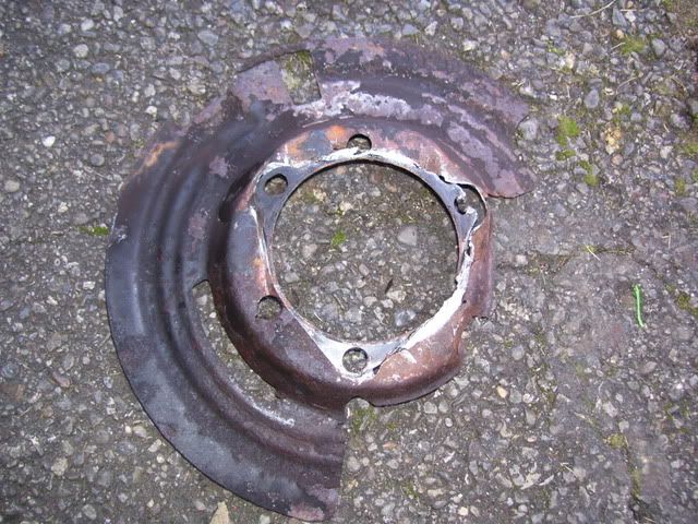

Dust shield and new unit bearing installed and tightened down
And here it is all buttoned up and the axle hub nut torqued down. I anti-seized the hell out of the unit bearing and knuckle opening. Hopefully that will help me out in the future if I ever have to take this apart again. I also went through and made sure the ball joints and the tie rod end were fully greased

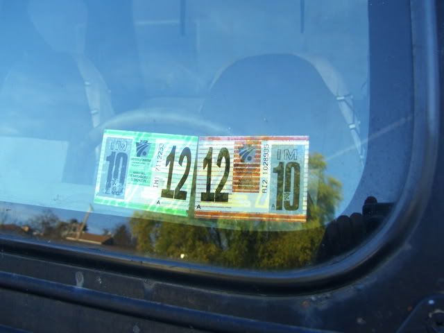

Definitely a good week.. got it yesterday

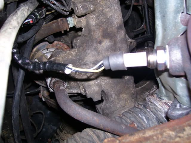

Now I have the sticker I can get around to fixing some drive-ability issues with the fuel/air system. I haven't had the smoothest idle since owning this Jeep and let it go unattended for a little too long. I've decided that now's the time to get the situation under control. I've started to replace some of the sensors after reading through my FSM, starting with the 5 year old Bosch o2 sensor. Replaced it with an NTK yesterday.
Based on my symptoms with the idle and overall rough running I decided that a Throttle Body rebuild was in order.. the Jeep is 22 years old after all. It'll also be nice to know that something as simple as a bad gasket/fuel regulator was the issue instead of replacing sensors.
