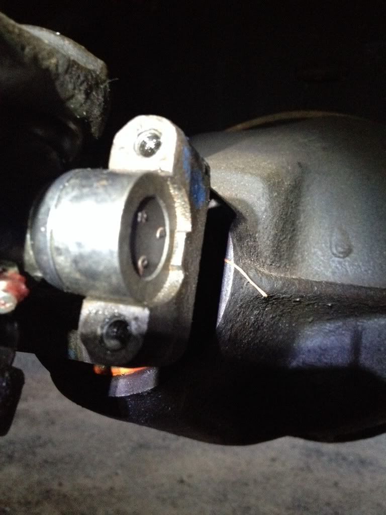

I went through the diff and took it for a drive after refilling the gear oil. Noise was still there so I started by checking the u joints on the rear driveshaft to rule things out. I found that the one u joint i hadn't replaced had a damaged spot on one of the needle bearing surfaces
So i replaced it and when i was strapping down my yoke I noticed something. The first picture is the way it should look
The ear for the u joint is worn down. At this point I was thinking that this was making the clicking noises/growling. Took it for a ride and.. noise was still there.

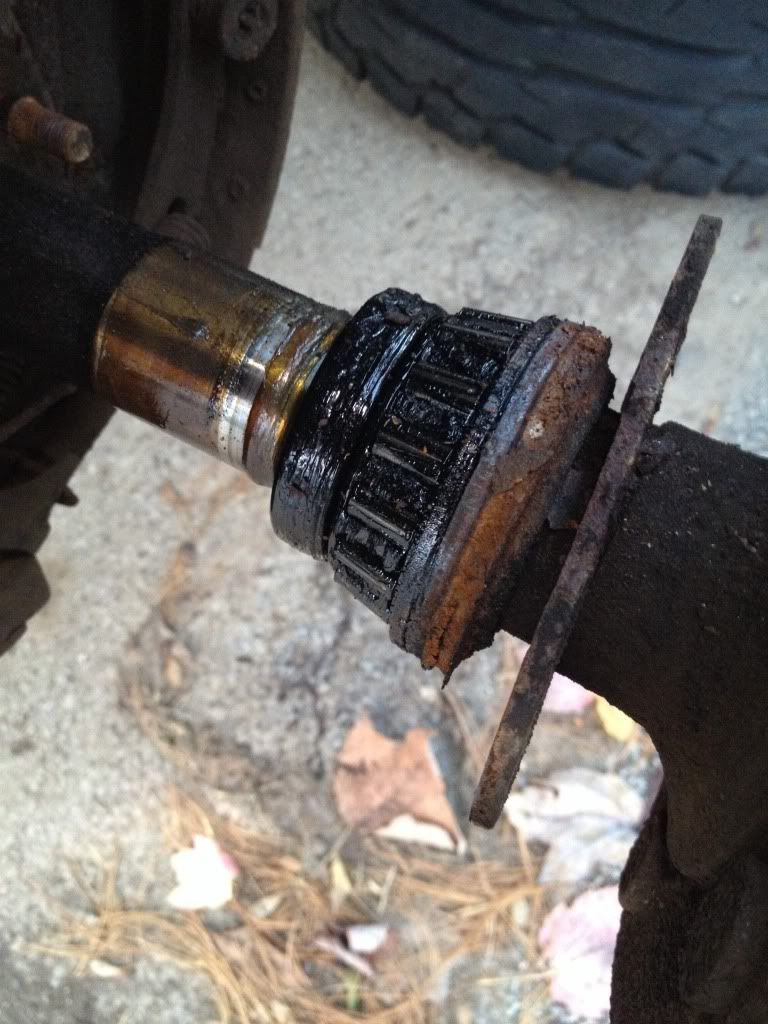

At this point I thought I was hearing the noise more towards the passenger rear wheel. I figured at 25 bucks for the bearing and 8 for the seal I might as well replace it and see if it quiets up. Below are pictures followed by a video of how loose the bearing was on the race and noise while turning. Hopefully the videos work correctly
Threw the axle back in after the new seal and bearing install and the. noise. was. still. there. : I think regardless if the bearing was making noise, it should have been replaced. Either way I was really hoping that was the cause.
To be honest I have no idea what the cause is and I'm severely starting to doubt my diagnostic abilities.
I'm going to replace the 10w30 in the trans with gear oil because I hear it mainly coming from the trans hump. That and the trans is the only thing that is not known to be good. I've already gone through the rear and tcase and the noise is still present so my next step is to change the fluid to see if the noise decreases and maybe narrow it to a bad bearing in the trans.
My driver side axle bearing was in similar, but slightly better shape than shown above so I haven't replaced it but I may decide to do so if the gear oil doesn't change anything. At least I can say that the rear was gone through when I go to sell it during the d44 swap. Hate to admit it but Sooner was right about having to dump more into the d35

I went over to Advance a couple days later and got what I needed to replace the driver side axle bearing and seals. When I got it out and inspected it, the bearing only had gear oil on it and no bearing grease as well as the inner seal being toast. Replaced all that and it made the noise quieter and less noticable, but did not get rid of it 100%.
With how many times I'm replacing bearings, I got that procedure down to 45-1 hour from the time the tire is off the ground to the time it's back on the ground. Only thing left I can think of is my carrier side bearings since it now is more noticeable down to 30 mph around town driving. I did think about replacing them while it was out but decided against it. I'm kicking myself now for not doing it because now it's getting too cold to be messing with that again for a second vehicle even though I have the bearings from the rebuild kit.
