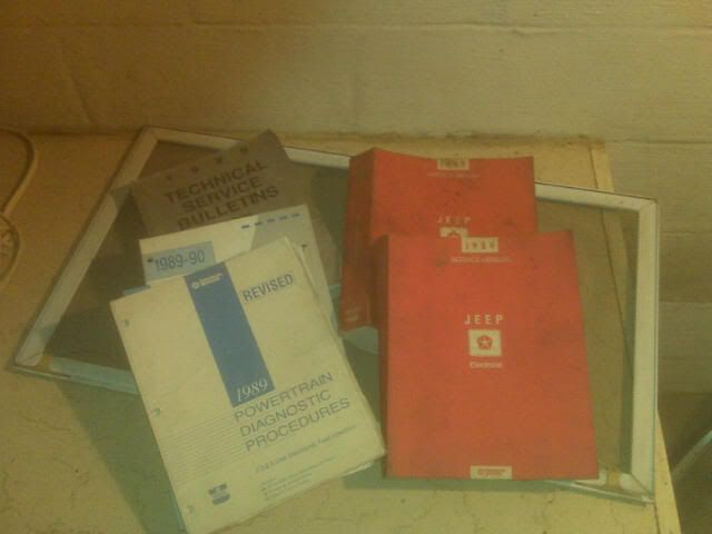

Ended up scoring some Factory Service Manuals for 1989 Jeep vehicles off Craigslist.. this will help me out tremendously.

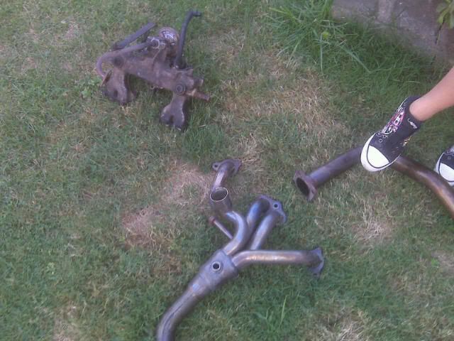

Bye Borla.. you leaky bastard..

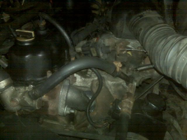

All buttoned up with the new stock manifold.. kind of a crappy situation going back to stock but i'd rather have stock than a horrible leak.
Sorry for the cell pics.. I'm in the process of charging my camera batteries. I still have to get the stock downpipe installed and then i'll be dropping the tank/removing some fuel lines, and welding the frame.

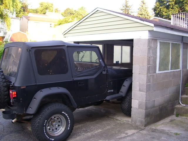

Got bored today so I rolled the jeep out of the garage.. probably the first time in it's life it's been under a shelter
got my camera batteries charged so we have some decent pictures now.. So since I pulled an idiot move and bought the wrong size hardware for the cat flange (forgot to take an old bolt with me) I decided since the downpipe was out I'd do some overdue cleaning..

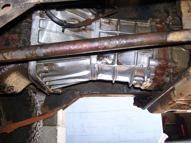

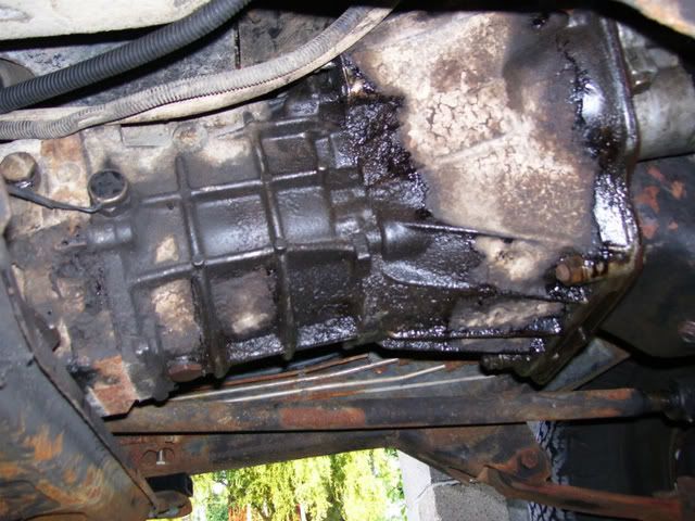

what my trans looked like before

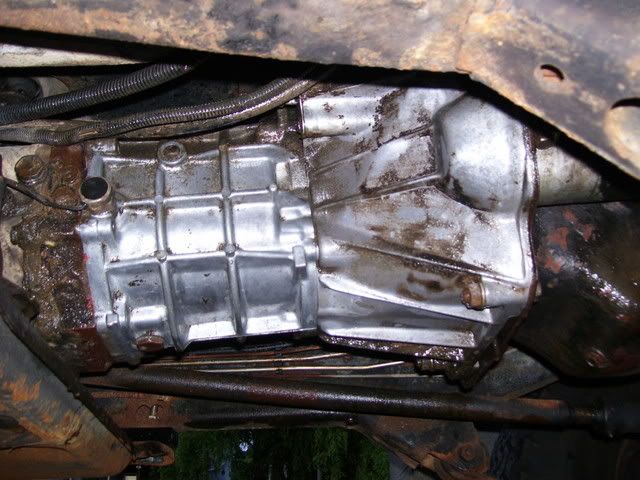

and after using a whole spray bottle of Simple Green I ended up with this
I think it turned out really good compared to what it was.. I have to get some more simple green to do the other side since one bottle wasn't enough
Only thing wrong with cleaning is that it makes the other parts look like crap and I feel like i need to just keep cleaning.. someday soon I'll have to drop the t-case skid to do the rest

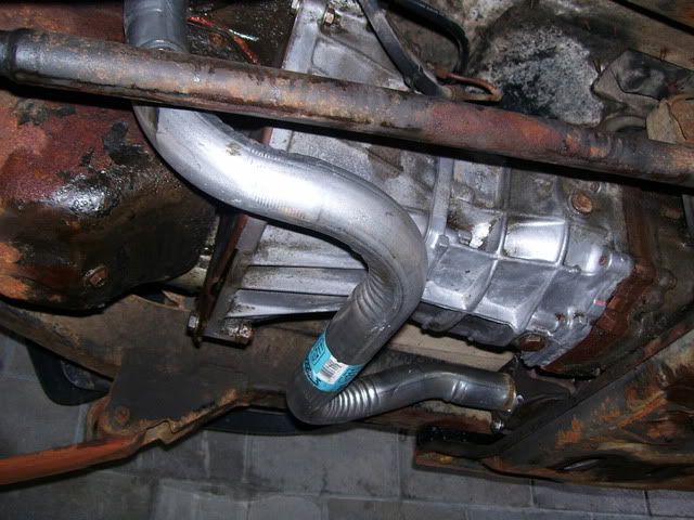

Got the rest of the trans degreased
and the downpipe bolted in

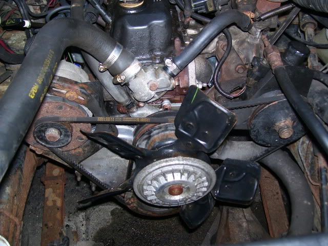

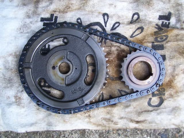

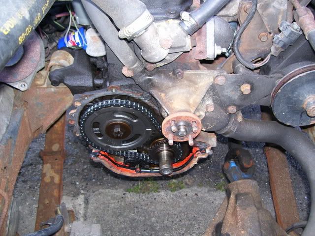

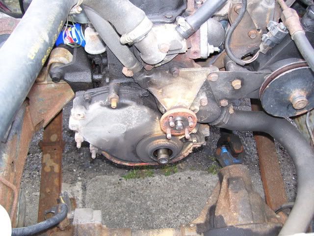

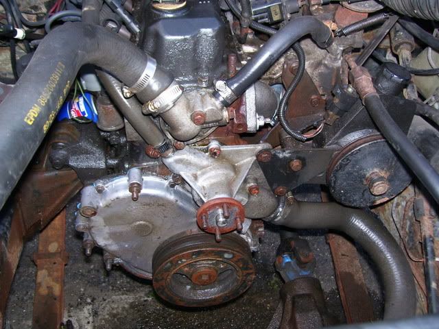

So since i've had a problem with how the motor runs since i've had the jeep I wanted to peg down the situation. Last time i did the timing chain I knew the sprocket positioning didn't coincide with what my haynes manual said. I played it safe and put them back in the way they came out. When i got a look at my FSM it backed up the positioning of the timing chain at 20 pins between marks like the haynes said. So it was time to dig into it again.
As it came off my motor.. 21 pins between marks and not 20. A PO must have done a sloppy install at some point.
Took some time to clean up the front of the motor once it was reinstalled correctly
job done.. alot cleaner than before

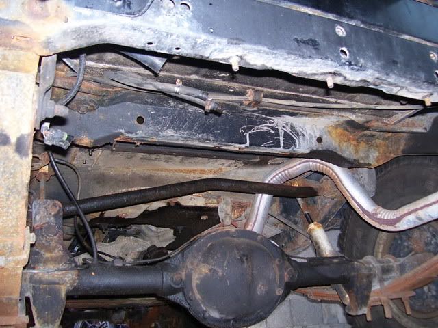

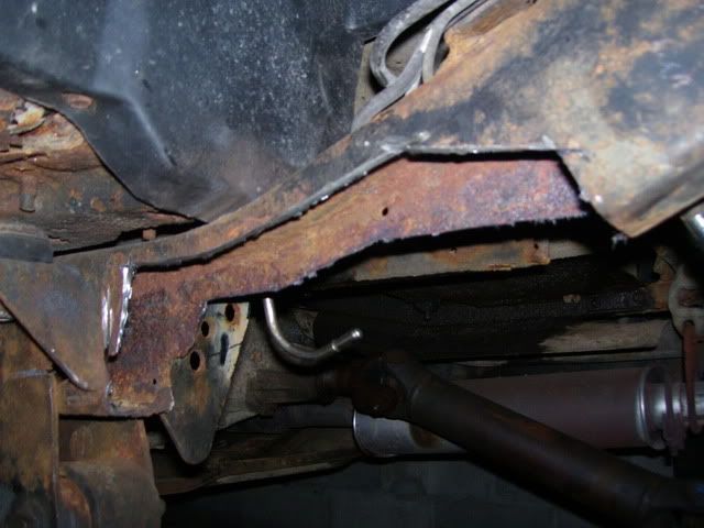

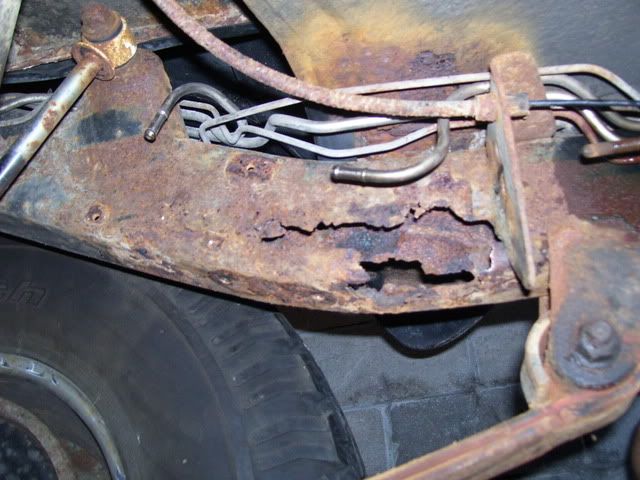

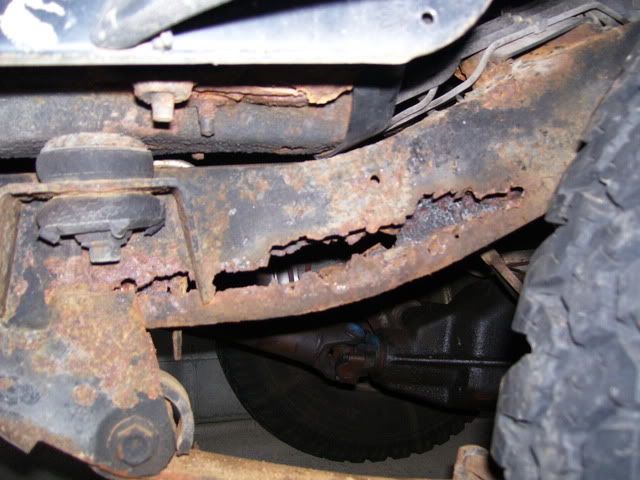

Finally got some time to start disassembly for frame repair..

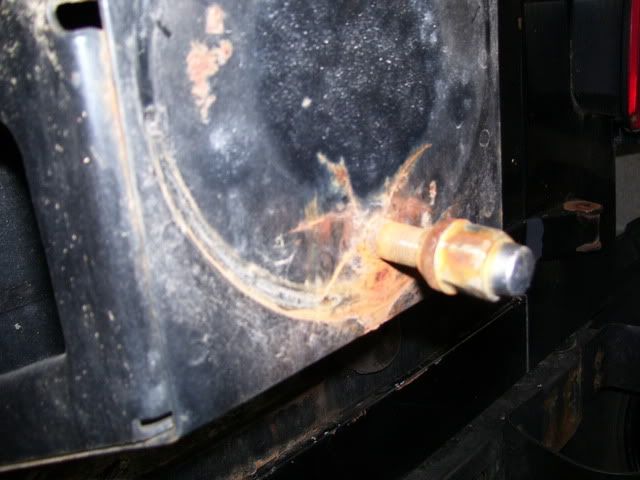

Found out why my spare tire makes so much noise all the time.. the sheetmetal is cracked
got the tank out.. i expected the crossmember to be gone but it was in surprisingly good shape

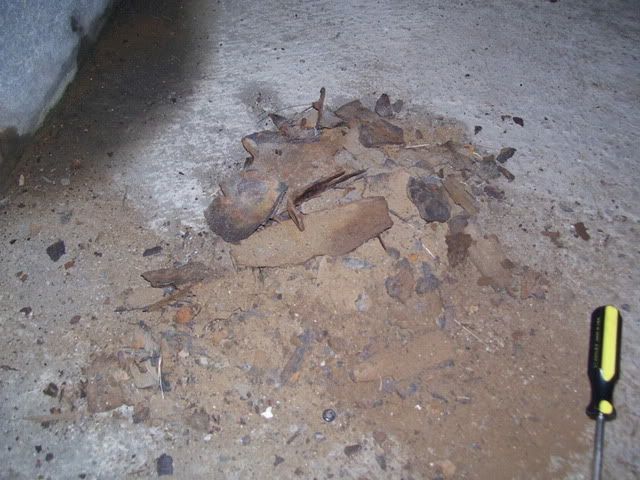

guess where this came from
mostly metal chunks and dirt..
outside rail
inside rail
that's as far as i got. It's a lot worse than i thought it would be so I need to revise my plan of attack here. I have a welder and a replacement section sitting in the garage waiting

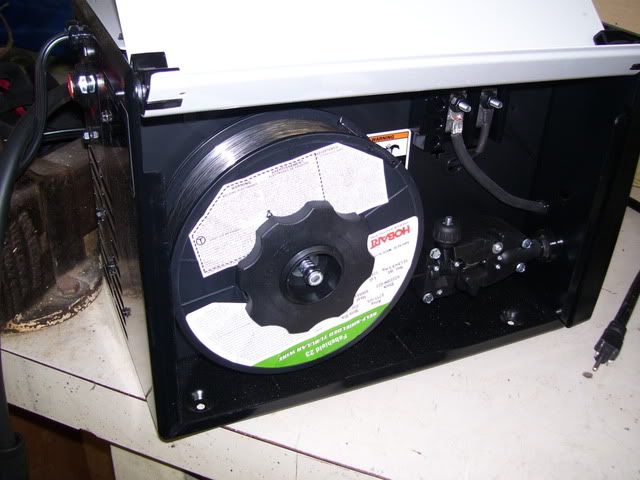

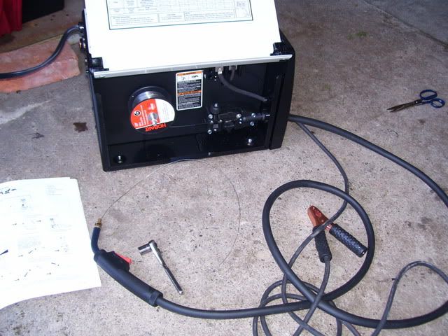

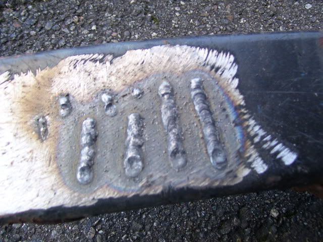

Had some free time today to get some progress done on the frame, finally unboxed the welder and assembled it
did some practice beads to re-familiarize myself with welding again.. I got the hang of it again by the fourth weld (on the right). I'll get better the more I do it so they won't look too bad in the future
As far as I got with cutting material, had to stop because the steelers are on tonight . But you can get the idea of what i'm cutting and replacing

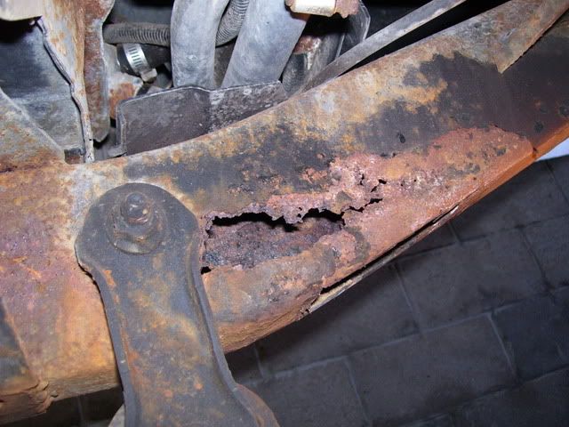

post #23 of 291 Old 09-27-2011, 06:29 PM Thread Starter
schaef89
Location: Pittsburgh, PA
Posts: 846

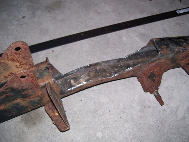

got some more progress done on the jeep tonight
more cutting

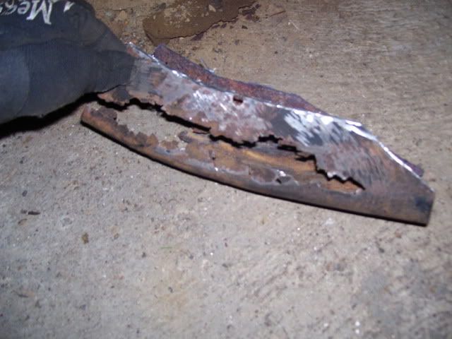

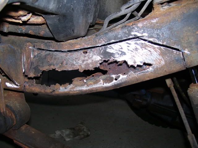

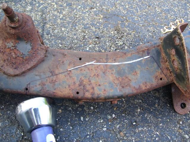

rotted piece
cut section
and tracing on the solid frame section with templates

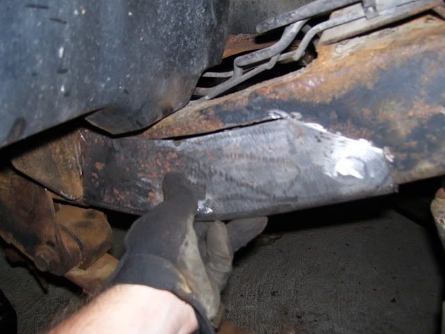

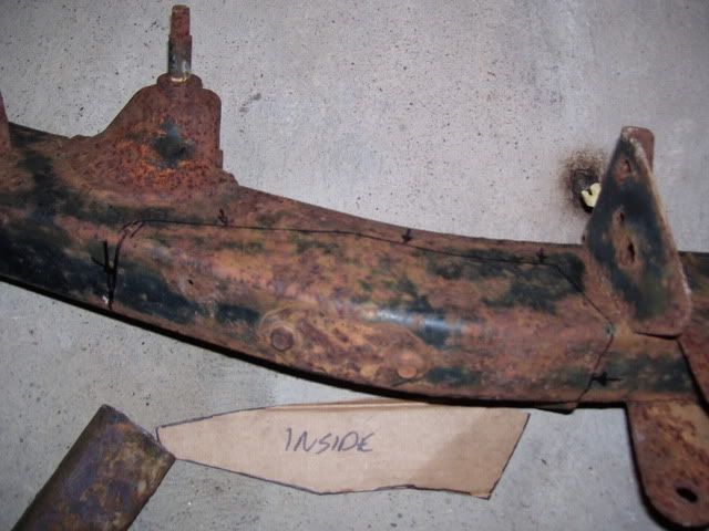

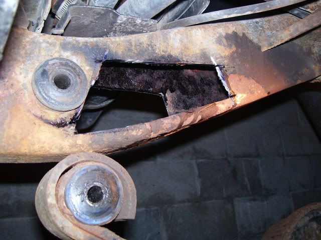

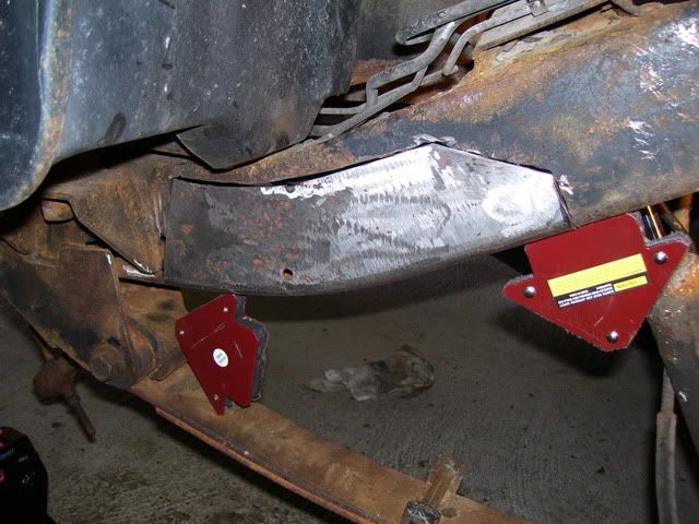

started cutting the good frame section
this one was in a LOT better shape than mine, uniform thickness the whole way around
took me a bit to get the shape correct
fitment is good, ready to weld

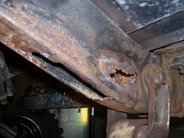

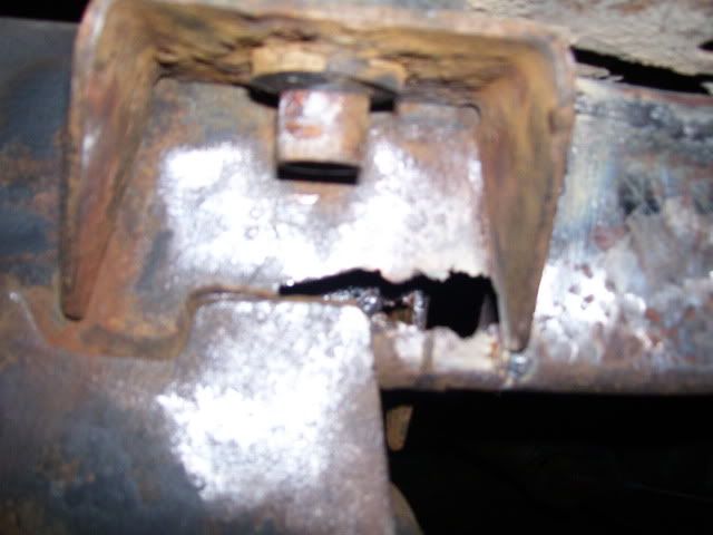

I wanted to spray some rust fix inside the rail before i started welding and ended up finding this little guy.. looks like I got another patch job to do
Rain halted my work today since i'm using all power tools in a seepy carport, more soon

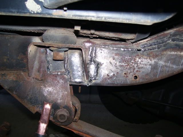

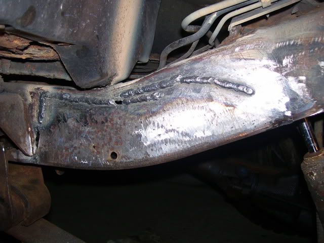

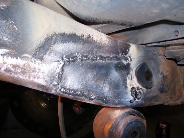

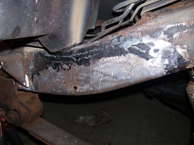

tacked up

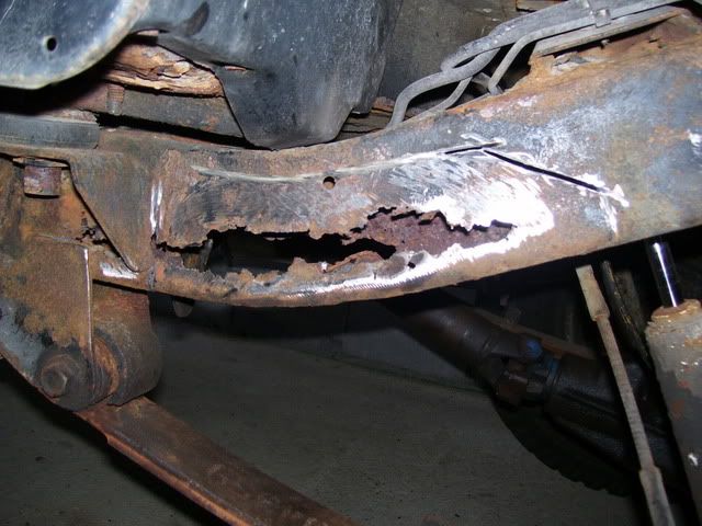

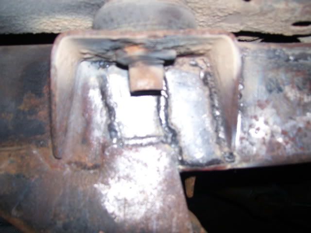

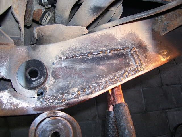

I got the outside completely welded but wanted to check penetration so i ground it all off to check
Some sanity welds just to make sure
And the inside.. the inside is not very pretty but i got good penetration on them. It was just awkward to lay under the car and get a good angle on the gun

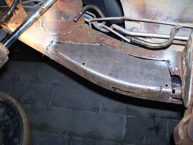

before
after
I ran out of wire in the welder sooner than I would have liked today.. More updates when i get a new spool.

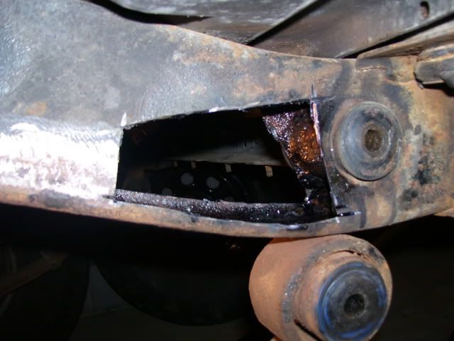

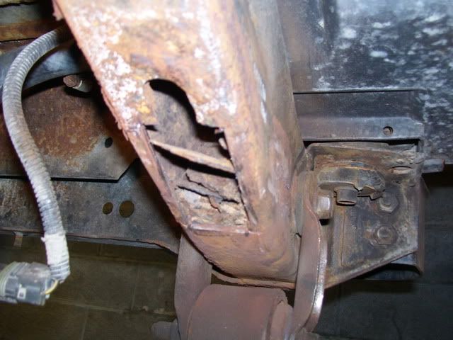

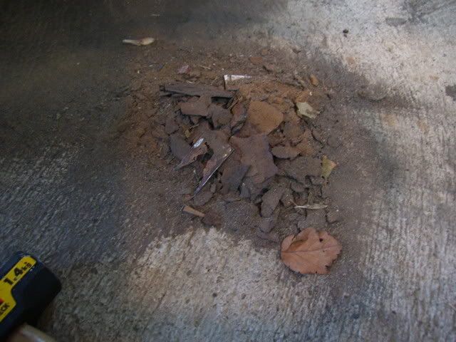

cut out the bad hole in the back, found all kinds of metal chips in there so i decided to start hitting it with a hammer
this is what resulted from the hammer
this is where it came from
after I saw that I realized I wasn't completing all the necessary welding today so I swept up and called it a day. I got the original patches covered with rust preventative and later will get a coat of enamel

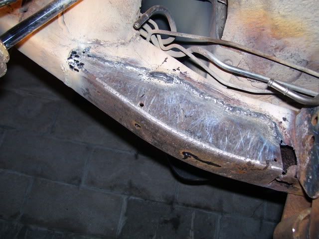

post #30 of 291 Old 10-14-2011, 12:33 PM Thread Starter
schaef89
Posts: 846
update time..

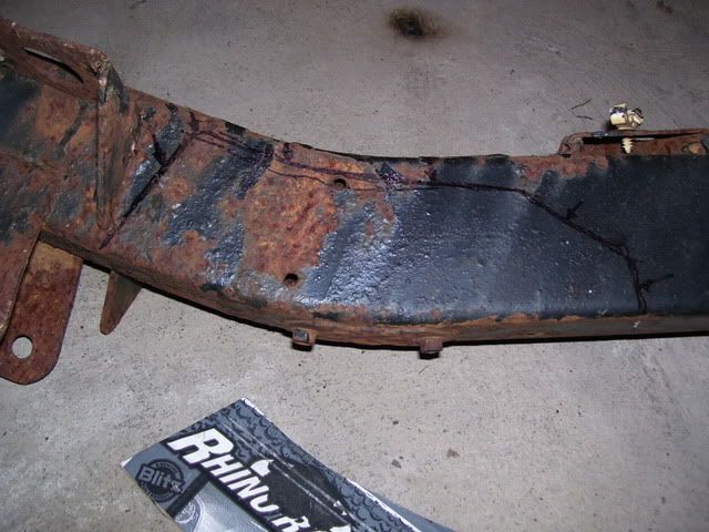

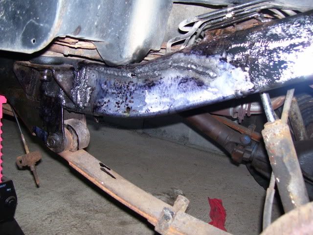

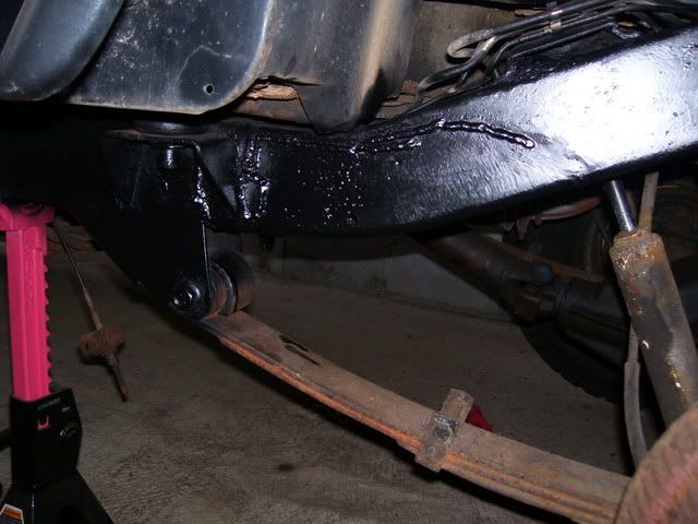

coated with rust stop
semi-flat enamel

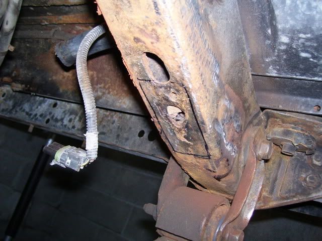

bad cut out
good welded in
still having trouble with welding laying down..

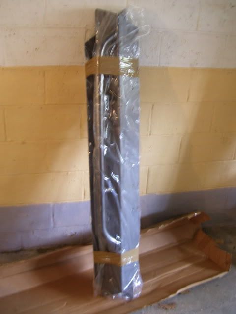

And here's a peek of a future mod fresh off the fed-ex truck
schaef89 is offline
