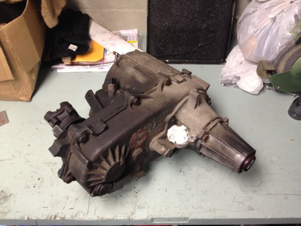

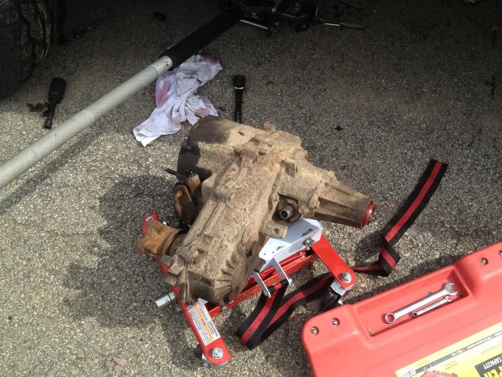

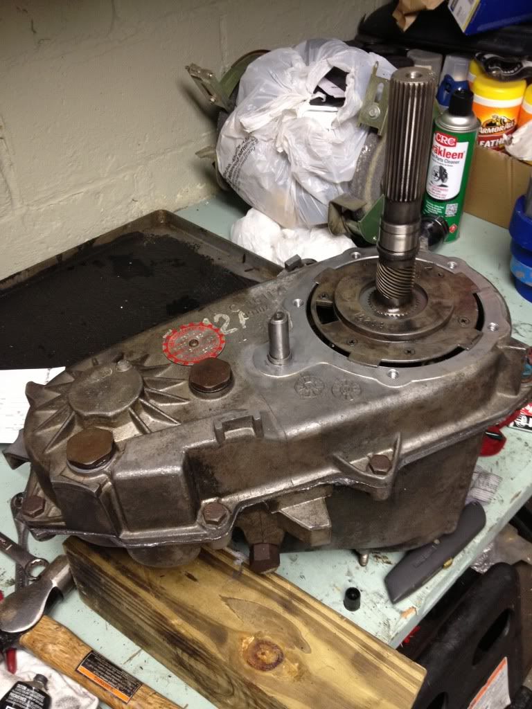

231 tear-down

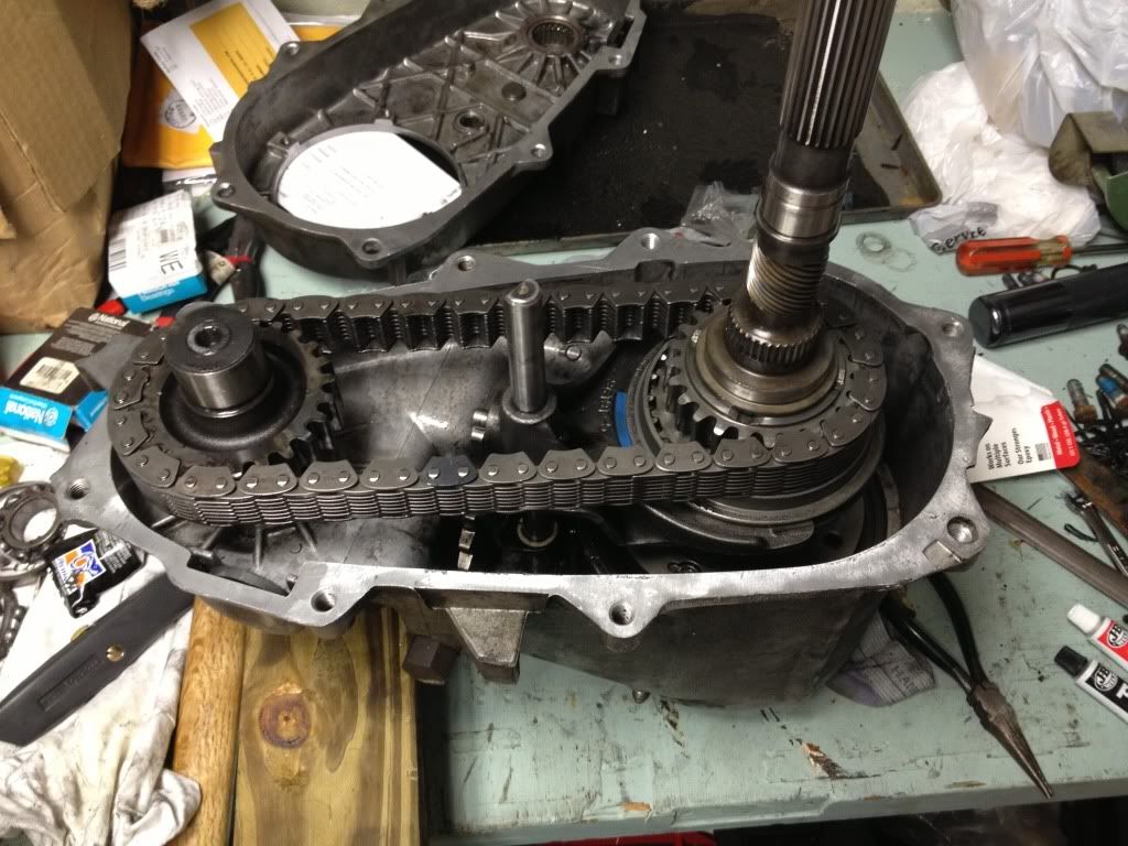

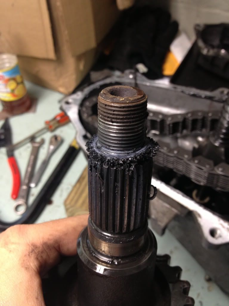

Well I got my brother's old tcase from my parent's place over the labor day weekend. It was known to need a new front output bearing and today I finally got around to tearing it down

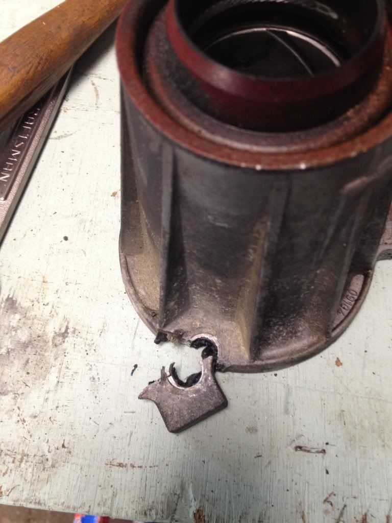

tail cone was broken : I'm either going to JB weld it or hopefully someone with one laying around will respond to my help thread and let me take their extension housing off their hands.

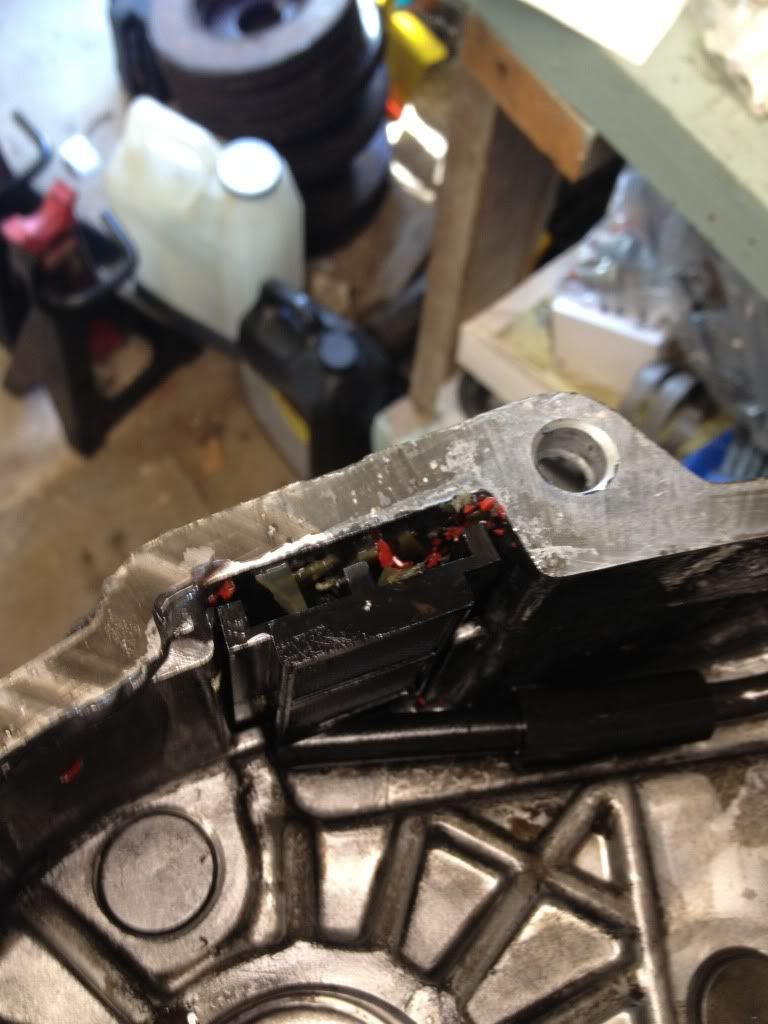

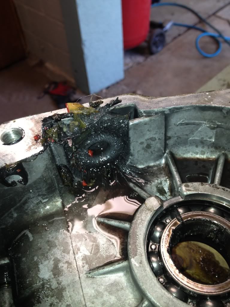

under the pickup filter on the back-half
Anyone know if this is RTV or a special washer?

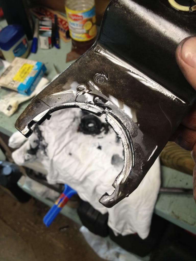

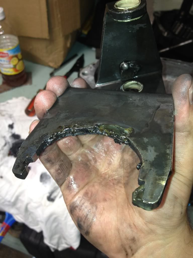

Pads are toast on this fork only
looks like it was rubbing without pads for awhile

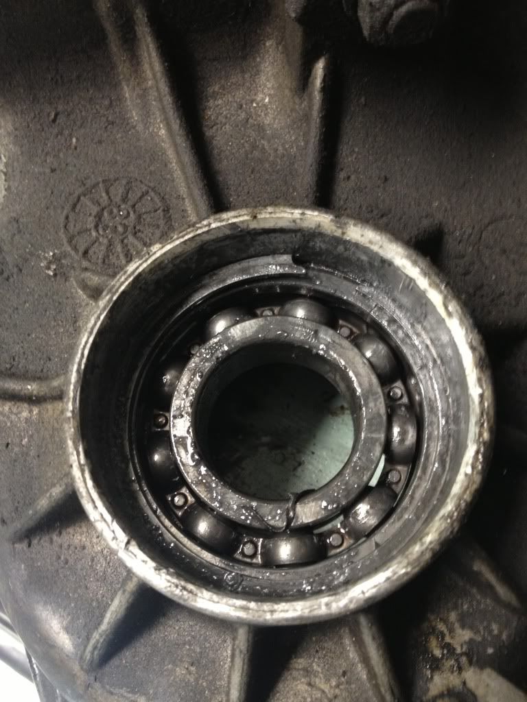

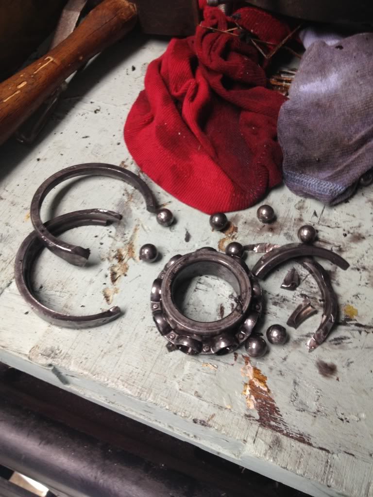

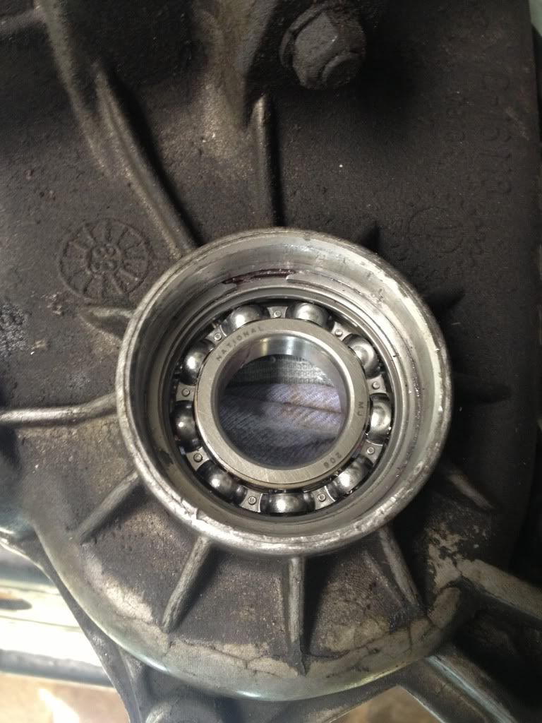

bad bearing
The outer race was completely cracked/shattered. I've never seen a bearing this bad. This was how it came out
New bearing installed
I have to order some parts so I'm hanging it up until they come in. I think the bearing went due to lack of fluid delivery. When I removed the pump, the tube was not even connected to the pump and there was no O-ring. I'm assuming all the metal on the magnet was from the bearing since I could move it with my fingers 1/4" in any direction and all the balls were pitted.
Someone was definitely in this tcase before though and it seems they did not do a good job .
It's a little rubber washer, has serrations around the outside, kinda like the teeth on a circular saw blade, but it's all soft rubber.
I have a tail cone sitting in my pile-O-parts for free, but not sure you want to pay shipping cost from HI to PA. Would likely fit in flat rate priority box either medium or large so would be $16 max-ish. If you can't find one closer to you let me know, it's been laying around since I did my SYE.

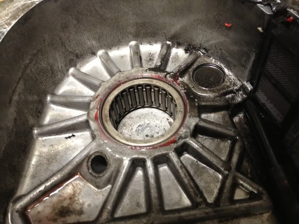

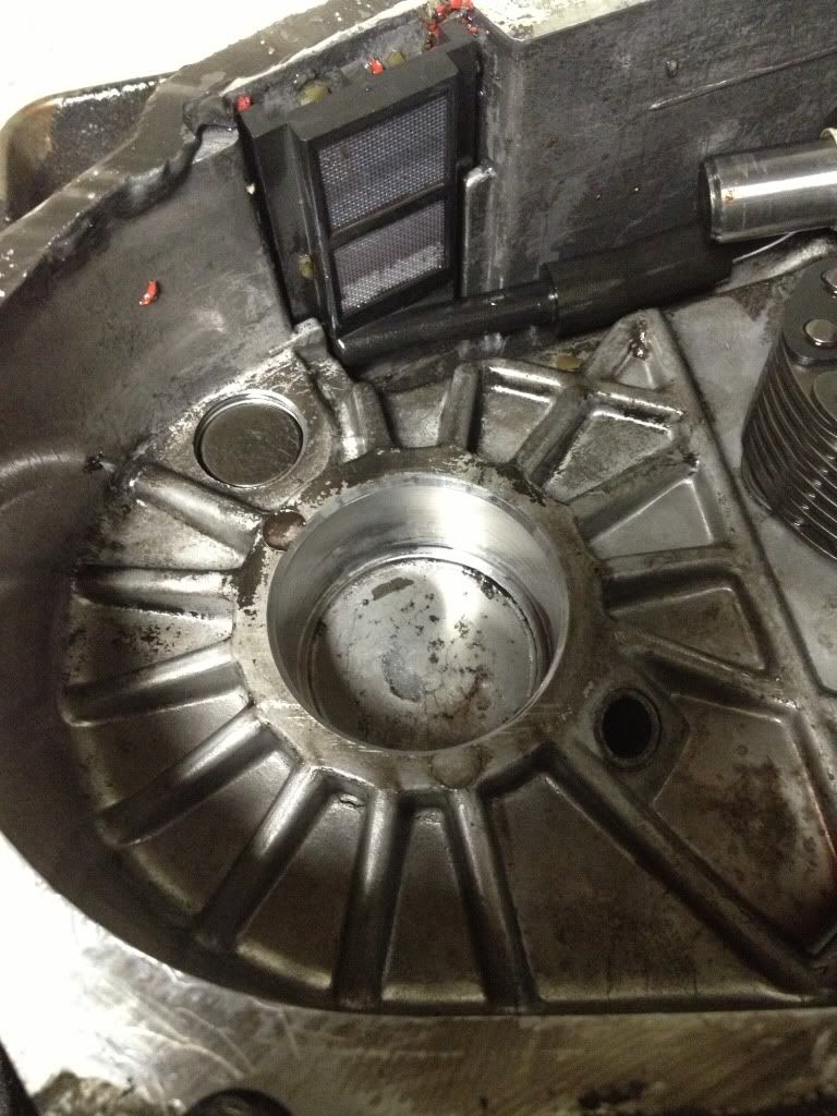

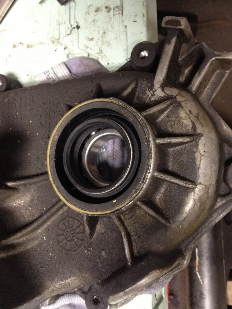

I realized this morning that the back half of the case was completely missing the output inner bearing. Too late to order since I put my parts order through last night to q-tec. Called Advance and they should have it in tomorrow morning
How could someone possibly do that???!!!!! Hopefully it wasn't run that way much as it will/would wallow out the recess and the bearing wouldn't fit right. When I rebuild stuff, I just get the whole entire rebuilt kit that has everything in it, tear thru the case and replace all the bearings, seals, the synchros, etc. Ends up costing less for me that way. Gotta admit though, those sunken case bearings take one hell of a pilot bearing puller to get those things out. At least that one you don't have to fight with to get it out........

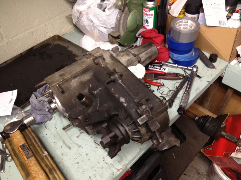

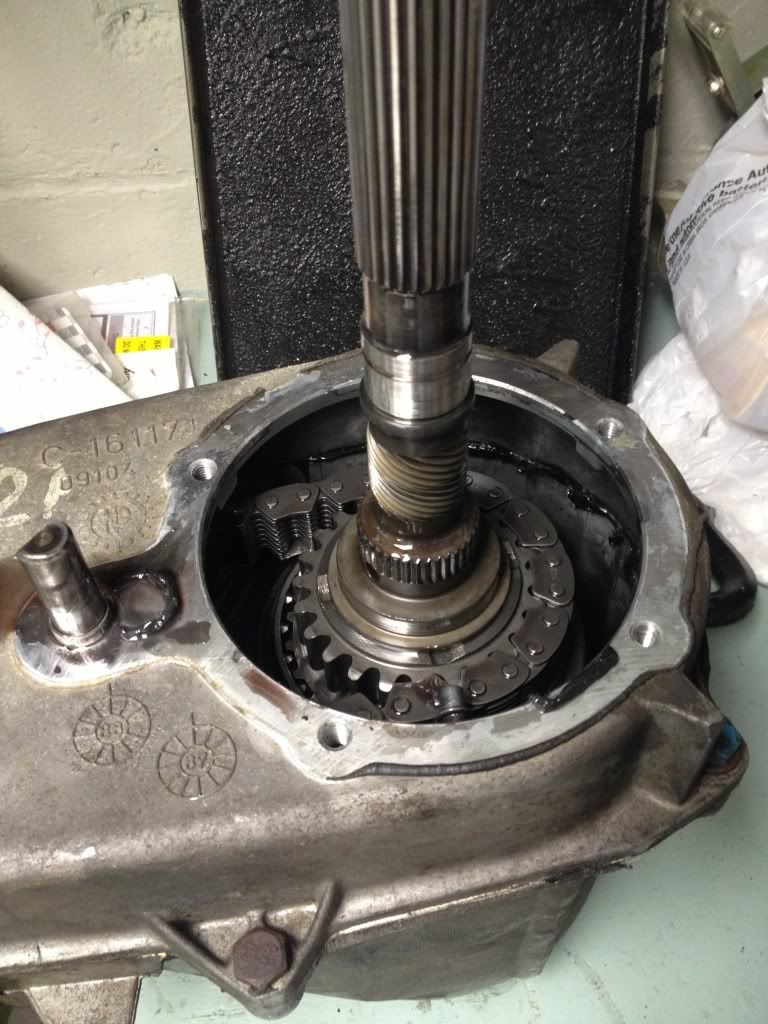

I got my parts in from Qtec a day early and had some time after work last night to start reassembling. I had to add the missing pump o-ring, missing inner output bearing, then replace the front output bearing and mode fork pads on the inner fork.
New front seal
New output inner bearing. Good thing I had a shop press for this or it would have been difficult
Getting there. I installed the spring on the shaft after I took the pic
Back half on. I'm assuming the pump tube install would be easier if you put it on the back half before mating it to the front. Got it on there tho
And done! Going in the jeep this weekend after I grab some fluids from the parts store. Maybe I'll scrub it down with simple green before install
All in all I'm about 85 bucks into this case with the cost of the case and parts combined. Hopefully it treats me well until sye time comes
