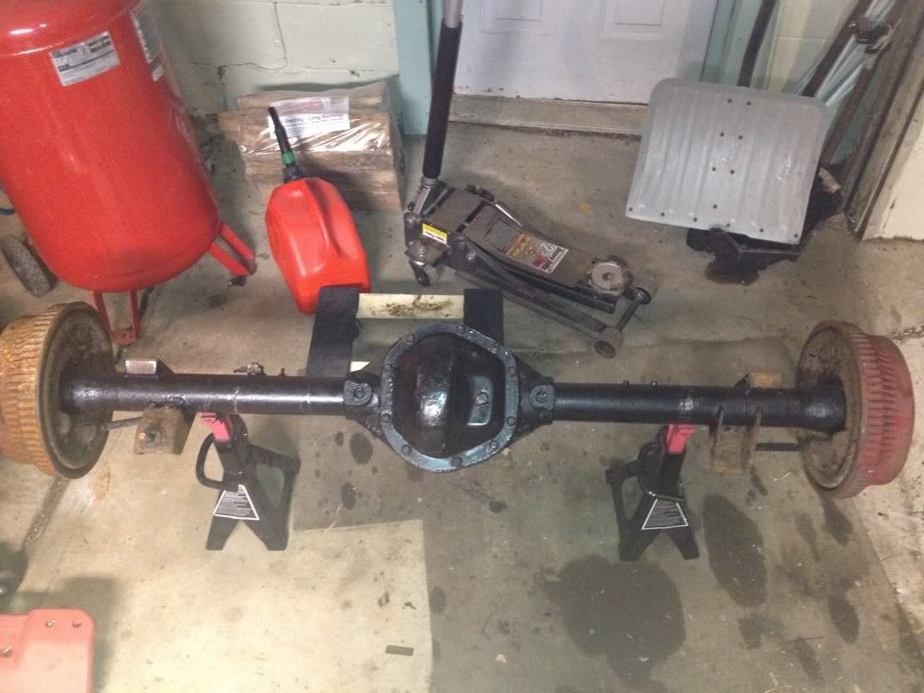

Well I just got home last night from vacation in Wyoming, so today is most likely going to be a lazy day. I do plan on jacking up the rear of the jeep to see if the "highway noise" is in either the transfer case or the rear end while it's running in gear. I should have more info on that by the end of the day today.

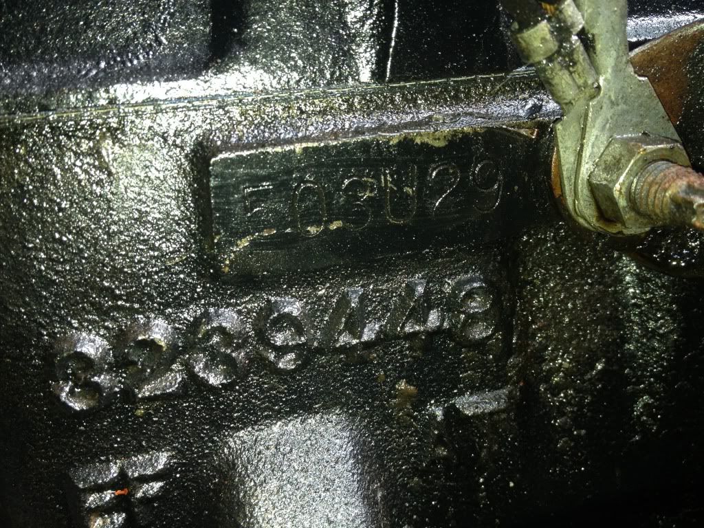

I was doing some JF surfing last night and landed on some info on how to find your engine's build date. So I ran out to take a look
Casting Number points to 1983-1988 year range and the 503U29 decodes to a 150 C.I.D. 2.5L built on March 29, 1985
When I had the cylinder off, I saw that the pistons were .030" over already pointing to a rebuilt motor. So it did not surprise me that I had an engine built in 85
The Cylinder head has casting # 893 with a year stamp of "85" towards the rear. It would seem that both cylinder head and block are from an 85 build date, 7/16" head bolts

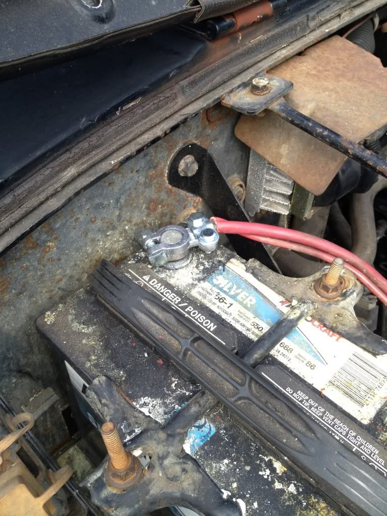

I am also having starting issues again. If it does the clicking/no start deal, I can jiggle the positive battery cable and it will turn over. I'm going to go ahead and replace the terminal connector and see if that fixes it. It does look cracked at the tightening bolt and kind of "rocks" on the battery terminal. I might just replace positive battery cable all together if that doesnt work. The whole thing sounds like a bad connection or short somewhere in the battery cables

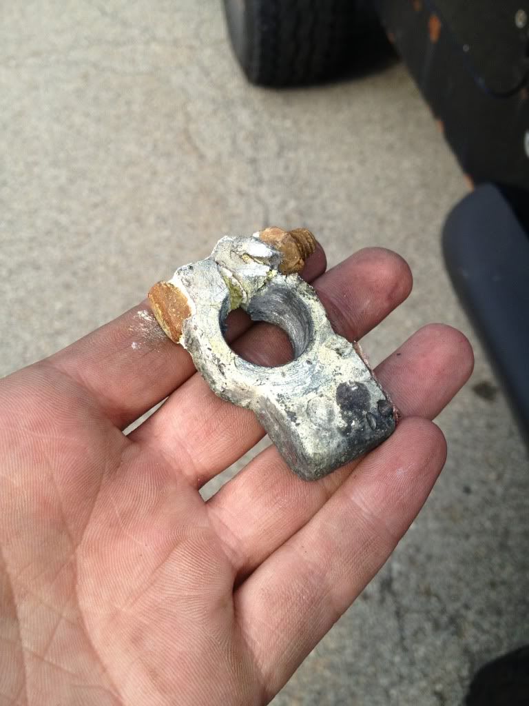

I ended up replacing the positive battery terminal and haven't had a problem starting it today, but I'm going to hold off saying "it's fixed" since it has been a tricky problem.
This was the old one
