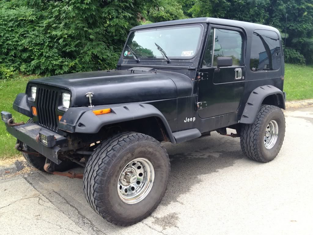

So I ended up canceling the inspection to get tires. My brother schaef81 found some in Harrisburg for 300. He was nice enough to run out and grab them before his trip out here to pick up his 8.8 that I had previously picked for him
They're falken Rocky Mountains with good tread life on them yet

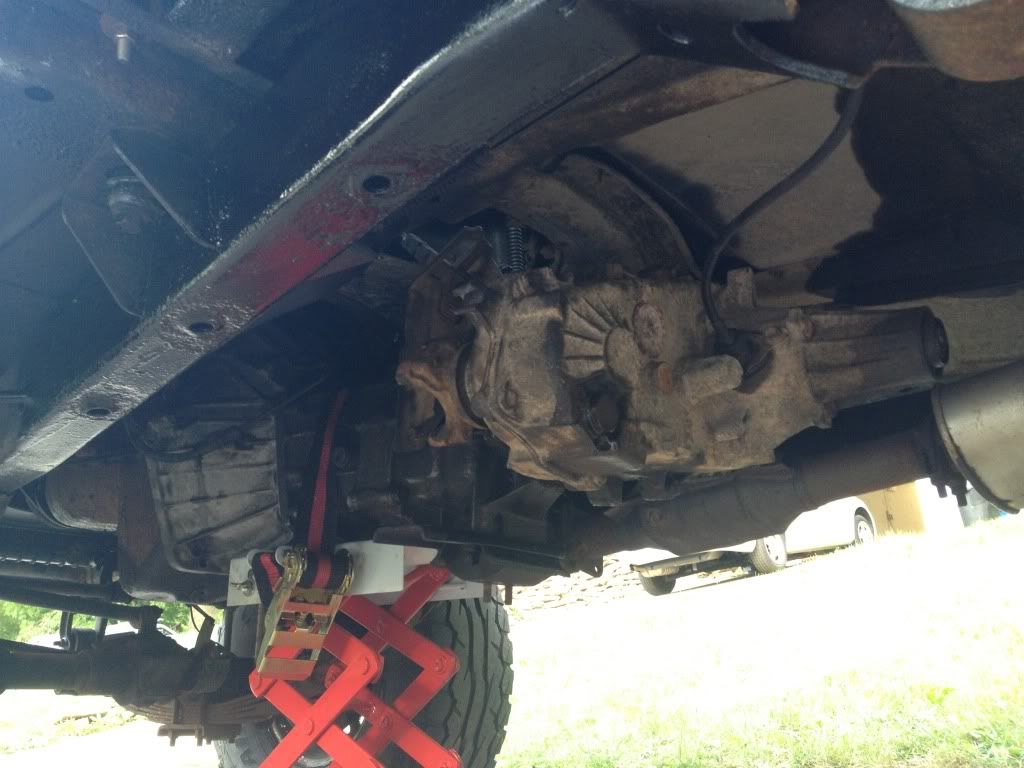

This was the status by the end of Saturday. I had about 4 hours into the removal (had some craigslist dealing to do that morning too). The original one on the left, the "new" one on the right.
I ended up messing around with spinning the input shafts and listening to the transmissions. The "new" one sounded alot tighter and quieter than my old one. I could definitely hear a bad bearing noise inside when I turned it.
I also noticed that the clip holding my throwout bearing was completely off and laying in the bell. It was also all wet again with oil (unknown origin, but probably my valve cover)

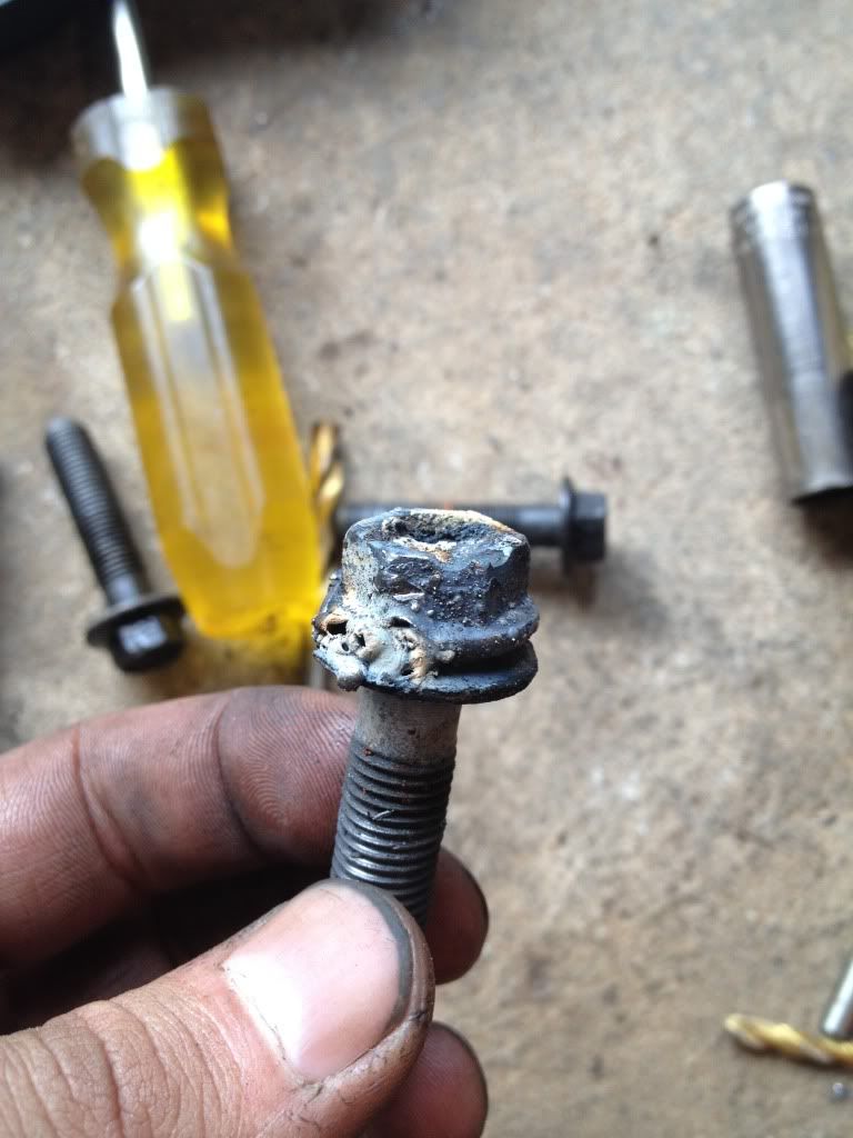

The impact wouldn't work and nether would the breaker bar. I decided to break the heat out to heat the aluminum in hopes that would free the bolts. This worked great until my 13mm 6pt socket cracked in half and completely rounded off one of the bolt heads : After wasting time trying to drill/grind i came to the conclusion that my drill bits aren't worth **** when trying to drill out bolts, and my cutting disk couldnt not get in the area.
Ended up welding and nut onto what used to be a bolt head, heated up the trans housing extra long, literally gave the socket a kiss for good luck, and it finally broke free lol. Pics of success

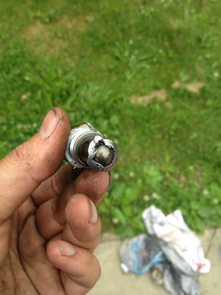

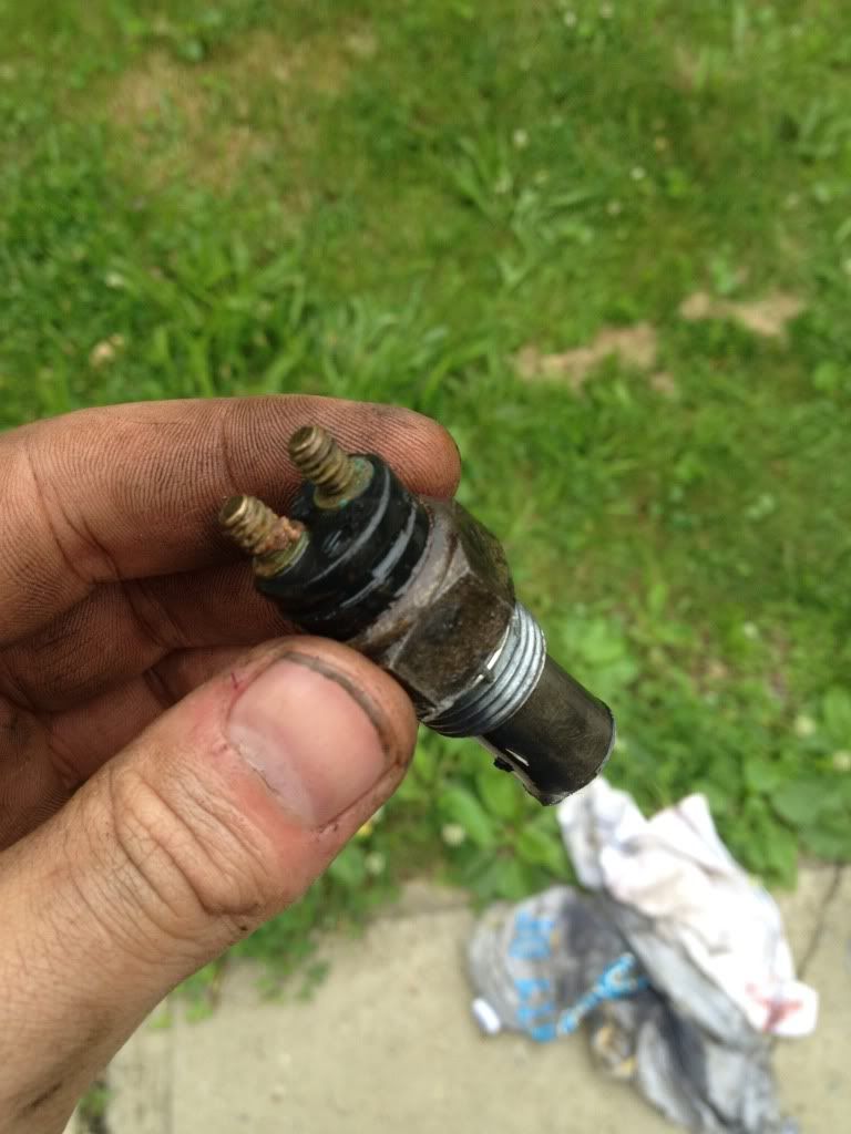

When i swapped all sensors over to the new trans i didn't think about the differences in electrical systems. I guess the shift indicator hole is supposed to be plugged on the new YJ transmissions because while it was in there I could not shift into 1st, 2nd, or reverse. It struck me that the newer YJ speedo and tach are electrically controlled. So I removed it after thinking that it could be the reason it isn't shifting and saw this.
I guess there was an internal change between ax5 years. Or I just screwed it in too far. Either way I removed it and replaced it with a plug for now and everything shifts fine. Who needs a shift indicator that lights up at 2000 rpm anyways

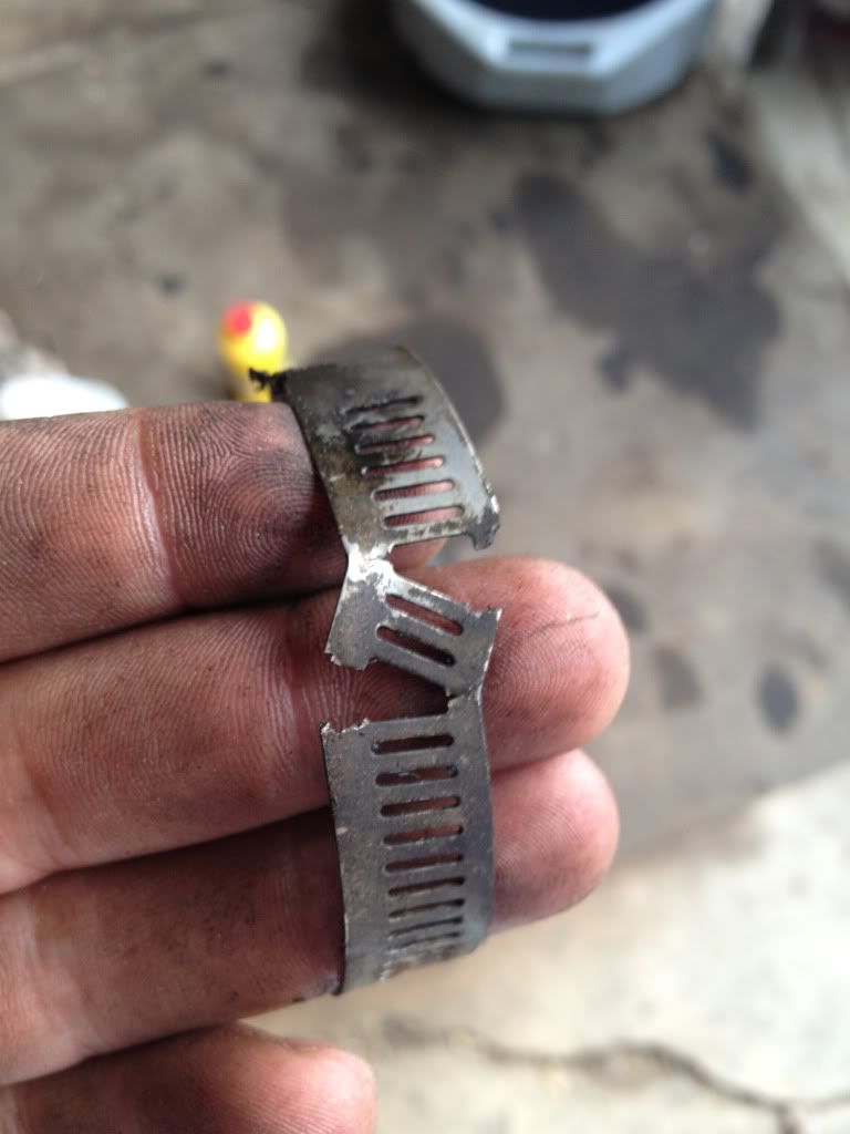

I ended up checking the hoses because I could smell antifreeze when I drove it to inspection and found a broken clamp on the tstat housing. I've never seen the screw type clamps fail like this, just thought it was strange. Going to pick up a new one today after work
