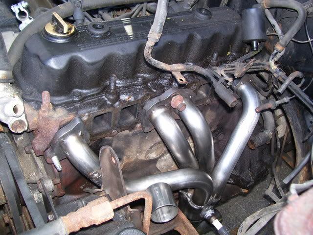

Turns out the EGR tube gasket for the TBI setup is about as easy to find as a unicorn since Mopar discontinued it.. This is as far as i got with the Borla install until my gasket comes in from a dealership in Connecticut

I was initially planning on dropping the tranny and doing the clutch but I wanted to see if the header would be in the way first (didn't want to get ahead of myself with starting more than one project). Turns out the collector and 90 degree turn would cause some potential headaches with getting the trans out. Also turns out my power steering bracket needed some modifications for clearances.
This is for anyone who's curious about what all needs modified for a borla to fit on a 2.5 with power steering. I know that I couldn't find anything with pictures or information as to what the actual modification was to the PS bracket. All I ever got was "yeah it needs modified" lol. Pics show how much material I had to take off the bracket itself and weldnut for the tensioner bolt. The bolt also needed an angle ground into it. I don't necessarily like how much material I had to take off but once i started it was too late to turn back.
Looking down from the top of the engine
Borla mocked up with two bolts loose in the block for correct alignment
