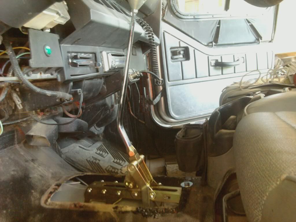

And i finally got my shifter in. Lokar 16" for the 700r4...

And what you doing for your t-case shifter? It doesn't look like you have a stick on the floor.

My tranny mount pic is right about my last updates... And ill have my 4x4 shifter in tomorrow. I had to cut it up abit... If you go with a shifter like i did, get the cable one, not the solid linkage. They are about the same price... Cause damn they are expensive.

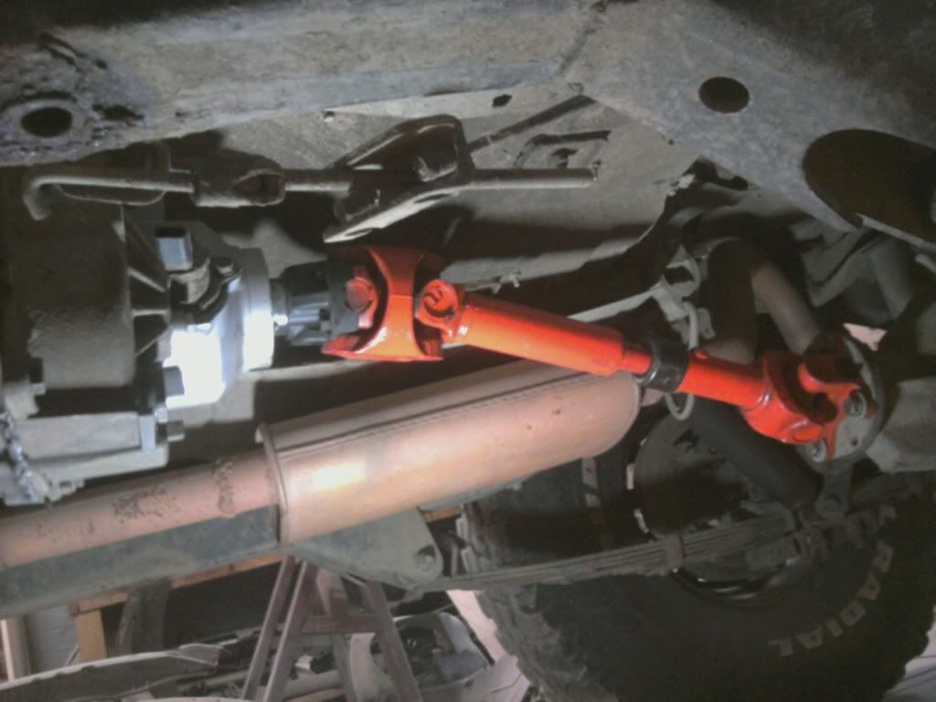

Yeah its good. I have driven it around the shop parking lot a bunch. I just got the tube to lengthen my front driveshaft today, so that will be done this weekend. I need to redo my rear axle spring perches as i have to much angle on the driveshaft right now. But ive been waiting on the front driveshaft to finish it up so i can make some exhaust. But everything is good. Just had a bunch of other $#!T that keeps getting in the way....
