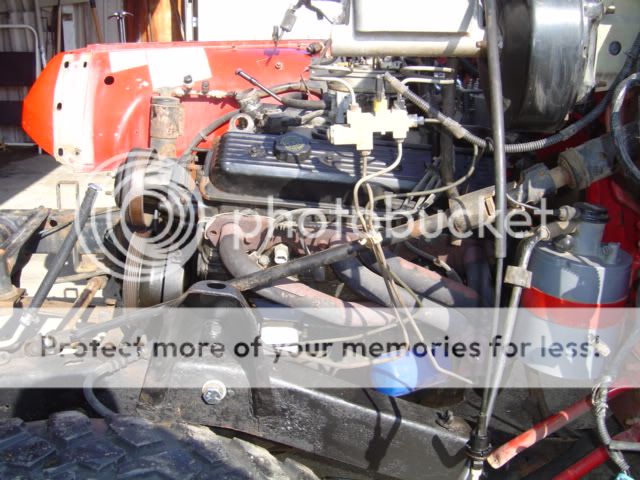

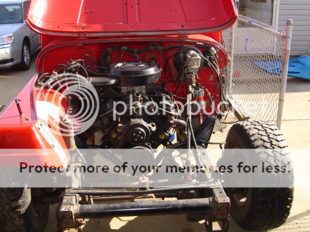

[IMG][/IMG]
This is as far as I've gotten so far. 94 5.7 TBI, NV 3500 just got put in yesterday. I still have to put the tranny mount in and get it bolted down, I really want to make sure it's straight. I have a 241 case now, but I am trying to find a 231c to do the c/j hybrid. The 24 is about 20" long.
I never realized how saggy my springs were until now.

what motor mounts are you using? (looks like the advanced adapters kit) And what headers? And GOD i cant wait to have my motor sitting in mine!!
I bought the Trans-Dapt mounts from Jeg's. http://www.jegs.com/i/Trans+Dapt/969/4566/10002/-1 The headers were on the motor when I got it, 94 Chevy truck. I think they are pacesetters.
The headers clear the frame, but not by much, so I may not be able to use them. I need to get the t-case in first to see. The collector is about 1/4" from the fuel lines.

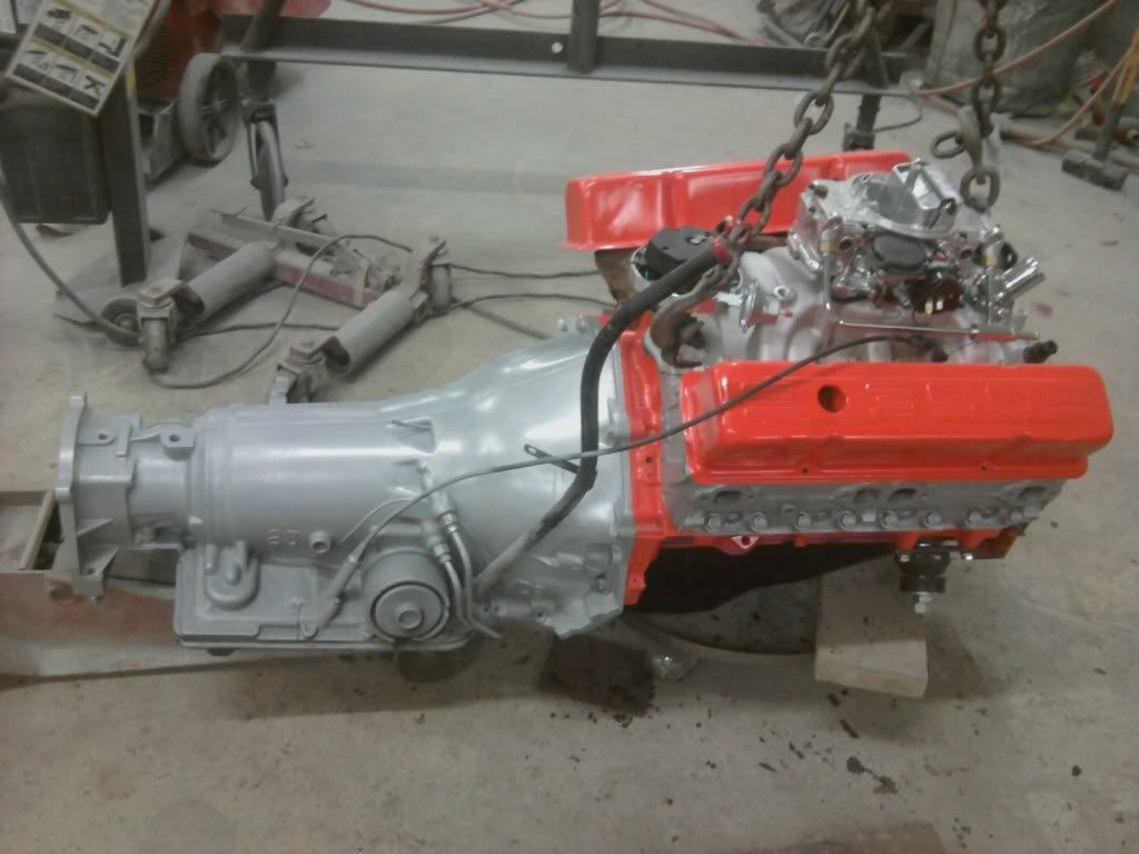

Well i got some more done monday night and tonight...
1. Monday night - i did my timing, put my new cover on, and all my new gaskets in. (rear main, oil filter inner, oil pan, timing cover, water neck)
2. Tuesday night - Took all my brackets off the donor motor, and sand blasted them and painted them all black again. And finally got my motor and tranny bolted together.
3. Wednesday(?) - Get my motor set in and my mounts tacked in place. So i can remove my motor and get it all welded up good...

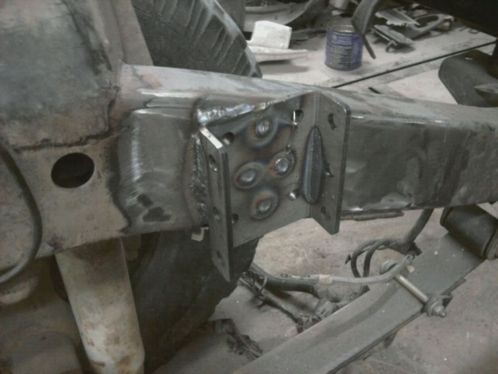

well here is the final welded mount for the frame...

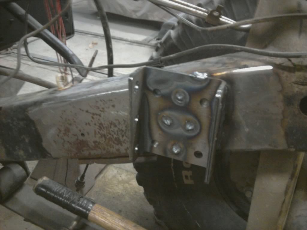

And the motor in its final resting place!!
Got my fuel pump for the motor today, and my starter... And got all my front acc off the donor motor so im hoping to get everything together this wekend!!
