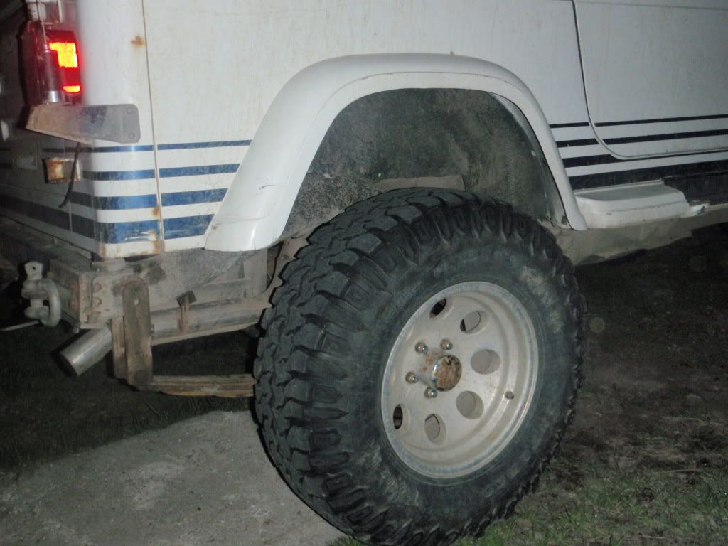

Evolutionof lift pics...
Sorry about the size of this post, but I got pic happy looking for decent examples of before and after. Alrighty, so few pics to show the new spring pack and a few older pics to compare the lift from the mods I have done over the last couple rounds of modification.
Before and after 1" body lift.
1.5" Shackle lift installed w/previous 1" body lift.

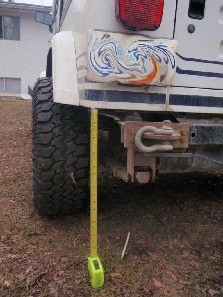

Parked on a gentle slope and you can see how the springs sag and invert with no flexing at all.
21.5" + 2.75" for the tape measure = 24.25" on the high side (passenger side was about 23" Also notice the gap between tire & flare, flat springs, shackle angled out from jeep.

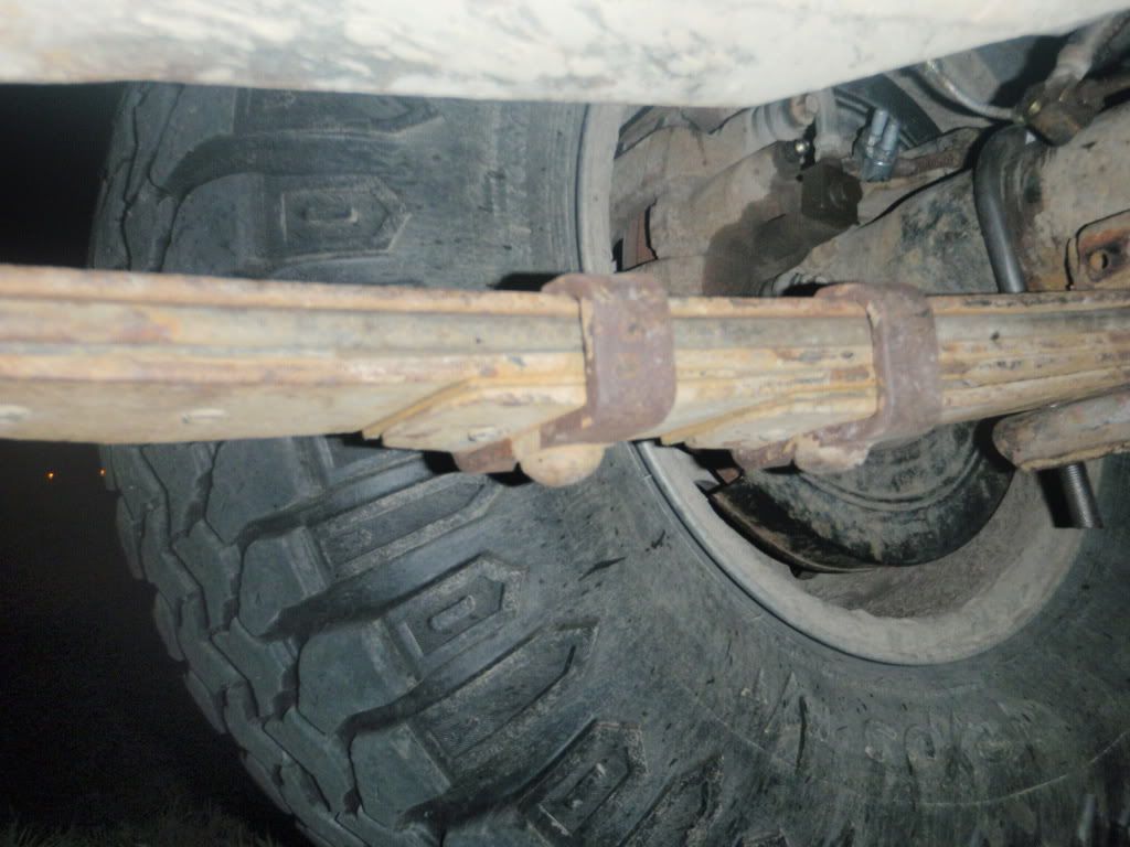

Outside view of Bastard pack.

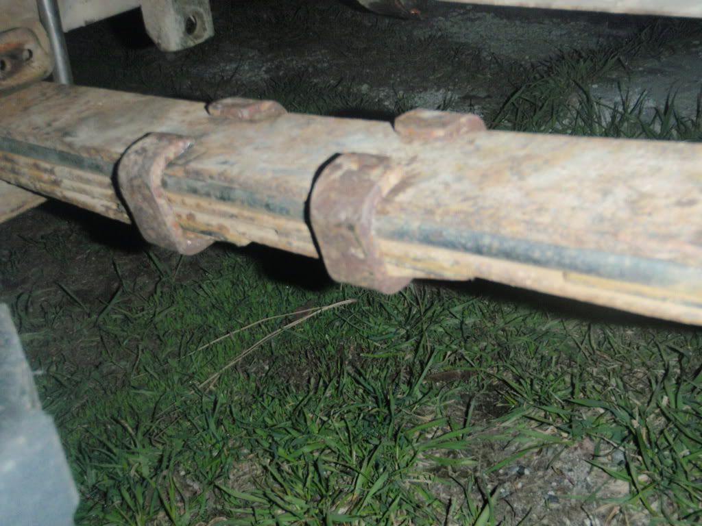

Inside view of swapped out 2nd leaf in the bastard pack.
Rear view of new springs installed. I think I can comfortably run 33's and get a bit more flex without worying about completly inverting. The terrible spring wrap I was getting before has subsided immensly. I think the case of beer I traded for the springs was for sure worth every drop!

Is that last pic at ride height ? It does provide some nice arch to the spring now but the shackle angle looks like it suffers because of it.
