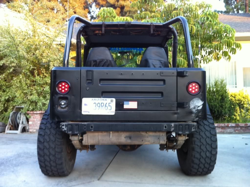

old thread i know but heres mine, bought at o'reilly when i worked there. employee discount ftw.
optronics LEDS.
i relocated the license plate since then. all i did was just unhook the old lights and cut the tub, solder in the new ones, hooked it up and popped them in place.
didn't buy anything else for the flashers or anything. these lights are sort of "plug and play" if you will.
