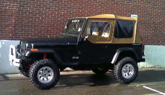

Installed just two weeks ago and have not been out wheeling yet. Installed easy enough except for the drop pitman arm ending up cutting it off. Everything elase went smooth. Opted out for custom longer brake lines and it was worth the money. With the four inch lift and 33s I got what I was looking for clearance and some good looks.

Nice looking yj. Like how is sits with the setup.

Looks like it is almost rubbing in the back already.
