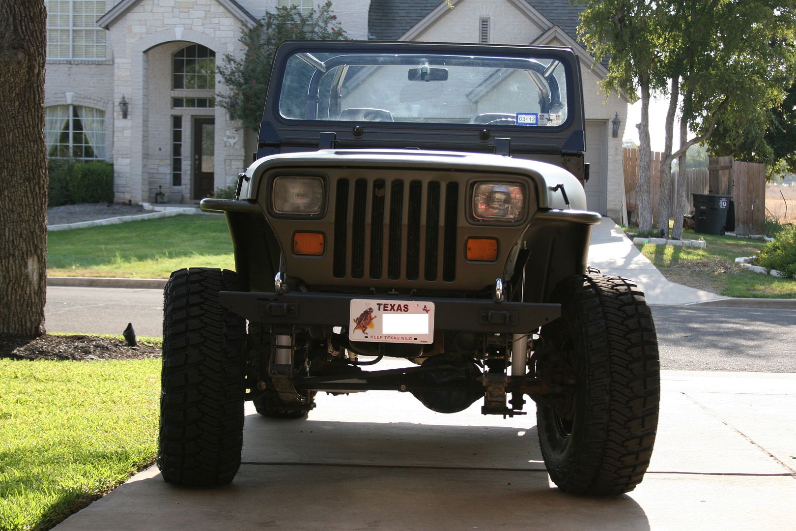

Ill trade you my made in Canada 2.5 kit for two OME 2.5 front heavy load springs and install it if you buy the plane tickets I bought my YJ in July of last year and it has been in the garage being rebuilt since then. The PO bought the spring during the 09 christmas sale, his post is in this thread. That put just over 1.5y of use on them when I bought it. Here is what the ride stance looks like along with a pic of the bent leaf. The PO told me that he called RC numerous times to try and get them replaced. I also sent a few emails and a PM, none were replied to. Camera was on a tripod, driveway is level.

My front driver's spring bent just like that when I had the 4" kit on. Nothing to worry about.

Above is tue; nothing to worry about.
I'm driving like this for two weeks now ( see previous post) and it's coming back a bit already... I hit a dune with my shackle :-( It's actually my wife's car for work and I only use it in the weekend to go dune bashing!! That's the fun of Dubai ;-)
