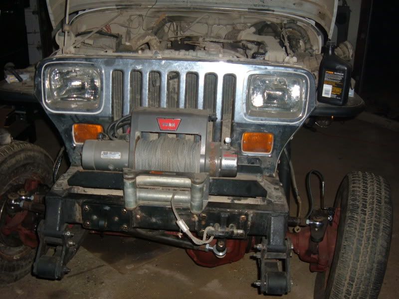

I think you would call mine a rock crawler bumper. its 1/4 2x4 tubing and does not go past the frame rails. Winch is tied into it. Front shackle hangers are on it.
It's harder to call any YJ front bumper a rock crawler bumper because the leaf springs hang down. they really hurt your approach angle and are easy to nail on rocks.
