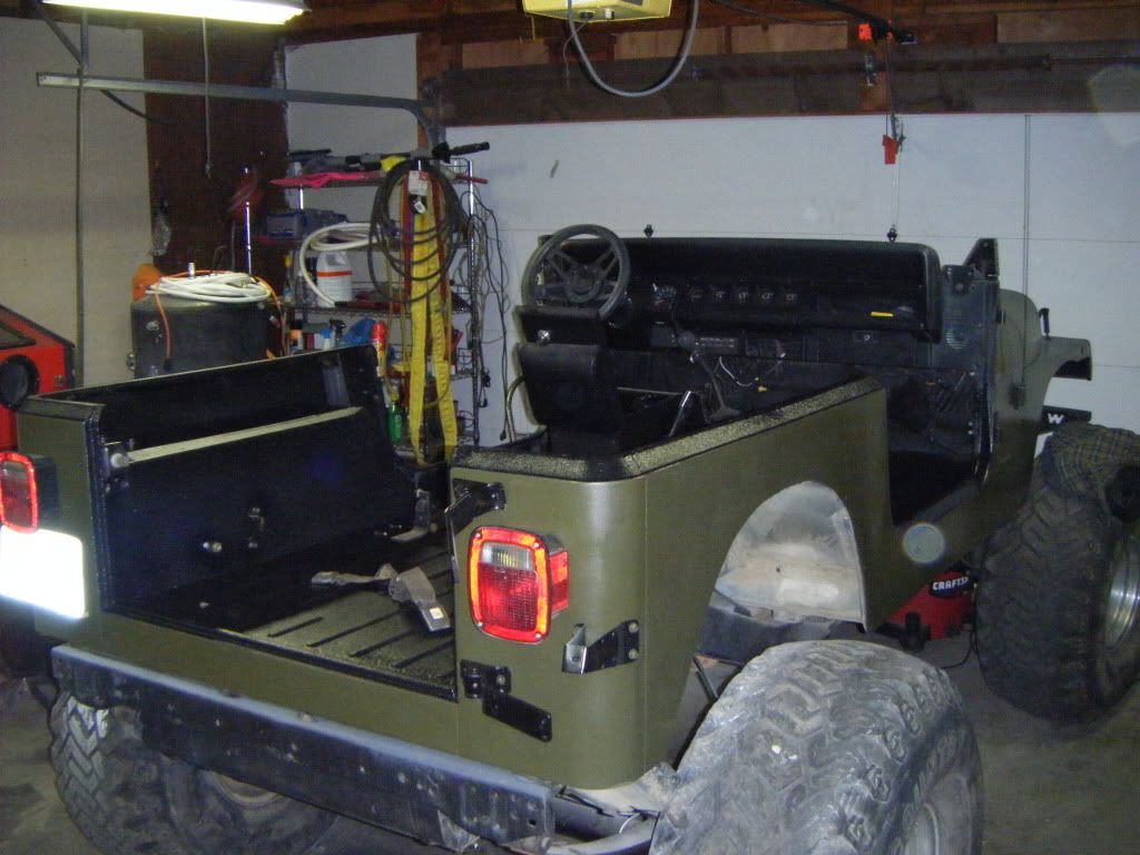

Herc'd for $85 and a days labor. 2 coats and its solid...
No compressor needed
Over the rails as well..

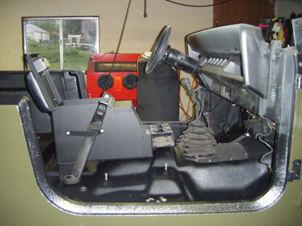

Here's my Rhino lining job... in my opinion this is top notch!
