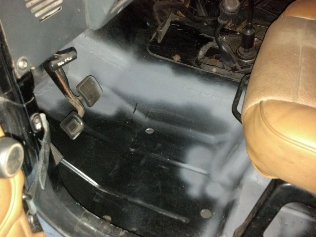

I bought new key floor pans. They have a lip on the front. How much of the new pan did you use when replacing yours. How do they intersect up front firewall, and toe support?

Here is how much i used

Did you or should you have replaced floor supports?

no the brace did not need to be replaced just cleaned up and painted

I used as much of my new pan as possible.
Cut maybe an inch off the top so it butt up to the firewall nice.
