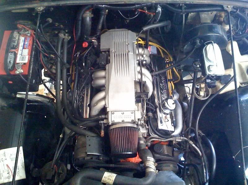

the original 305

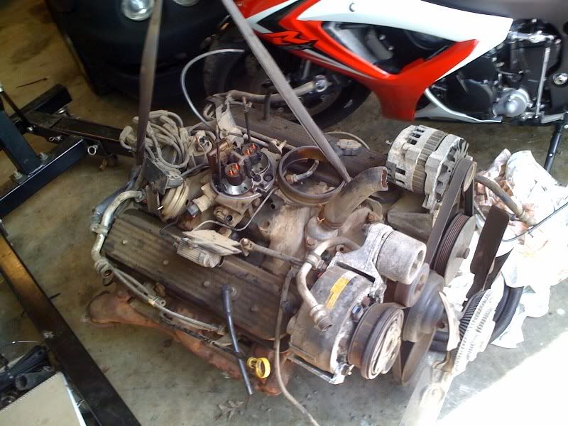

the new life blood. a 350 out of a 95 silverado 2500
next up: the rebuild! deciding on what direction to go. keep ya posted!

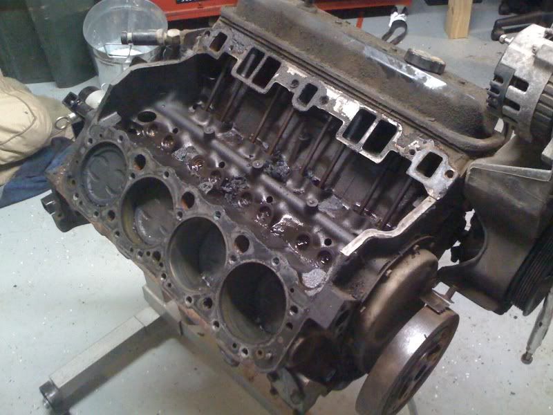

started the tear down of my new 350 (gonna rebuild it while it is out) here are some pics
stuck right now though because this stupid power steering pulley bolt is on tight, letting it soke in some pb blaster hopefully i can get it loose soon

you know that pulley doesnt unbolt like that right? its pressed on and needs a puller to be removed, they have cheap ones that work ok at advance for about 30 bucks.
+100
That's not a bolt it's a shoulder for a puller to grab onto

It is deceiving though it looks like an allen wrech would fit into the center of the pump shaft.

The intake will bolt up. The heads are the same. It's only the older pre-efi smallblocks where you need to drill the center intake bolt holes to fit an efi intake on.
the pump will come right off with a pulley puller.

Thanks for the info on the pulley! Wow I feel like an idiot! I was hittting that Allen with an impact and a big ol torque wrench, no wonder that went no where! I'll get a puller this weekend ( got to love the loaner tools at autozone)
