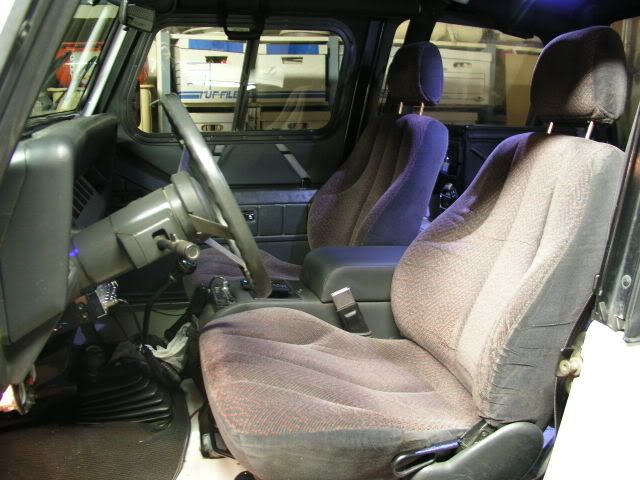

this is strange. are the seats any different than the 98 grand am seats?
I just put seats from a 98 2door grand am into my 93 YJ, and they bolted right in.
I just pulled the stock seats, moved the jeep sliders to the grand am seats, and bolted them back into the jeep.
I don't remember the bolt measurements at the moment, but I can check tonight.
here are some pics,
Those are the exact same seats I got from the '98 Cavalier. You have the same center console too. It's kinda tight, but it works.

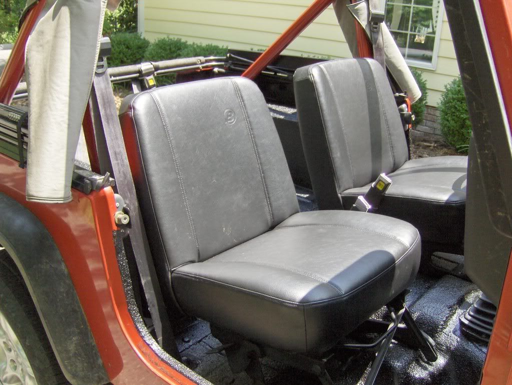

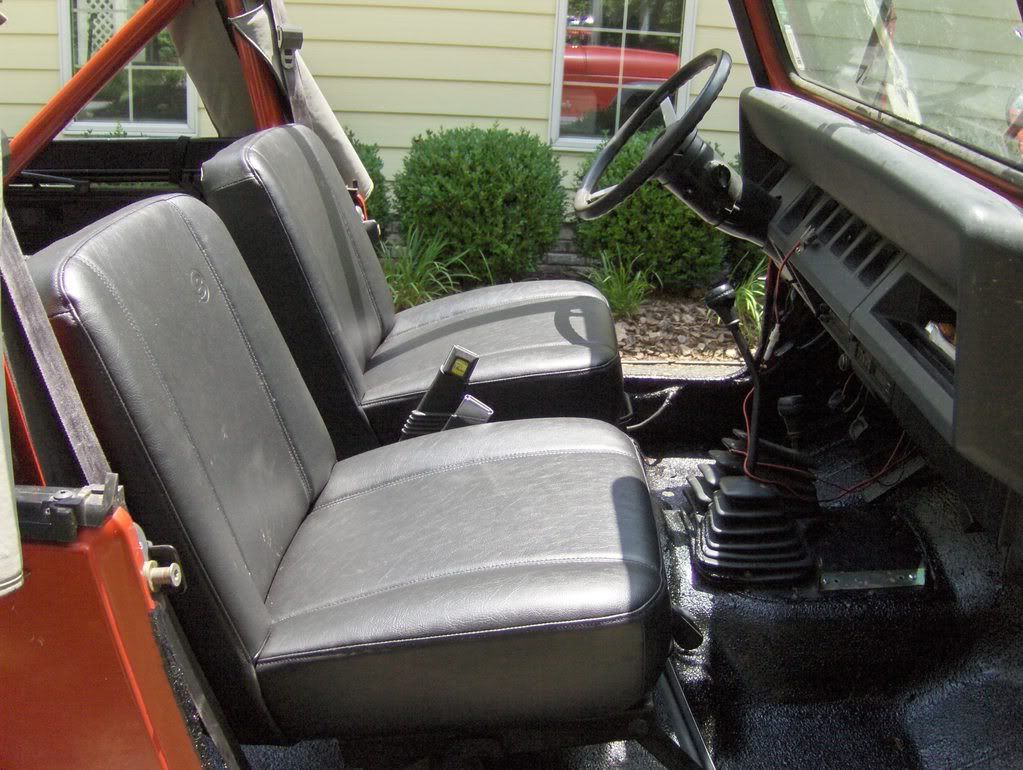

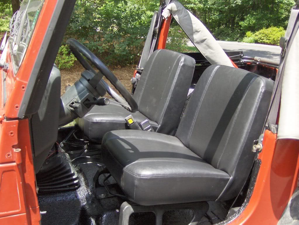

Bestop Low-backs...direct bolt in

those lowbacks look good, not very safe, but look good.
When thou walkest through the fire, thou shalt not be burned; neither shall the flame kindle upon thee ~ Isaiah 43:2 ~
Originally Posted by Bnabb View Post
it bolted right up, except one bolt but i didn't need it anyway
