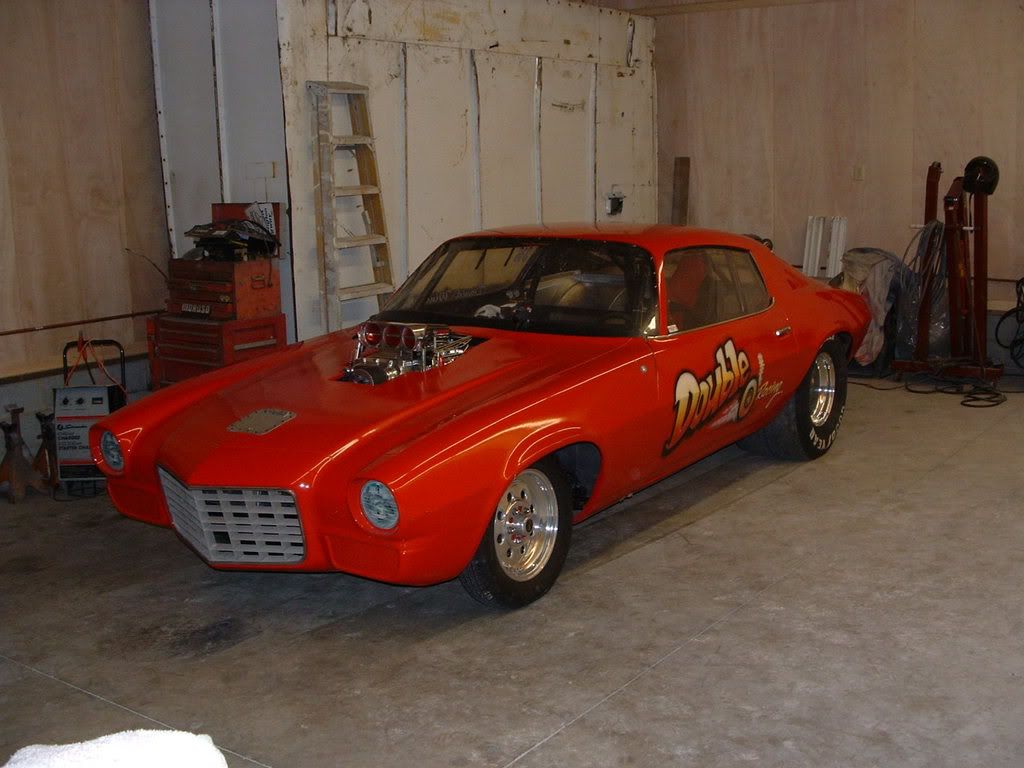

Fab skills, I got some. I built this:

post #113 of 539 Old 03-29-2008, 12:11 AM Thread Starter
rustywrangler
Got my eye on you.....
rustywrangler's Avatar
Join Date: Apr 2005
Location: Syracuse, NY
Posts: 18,613
show off.
