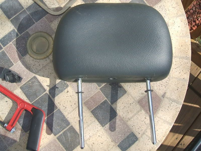

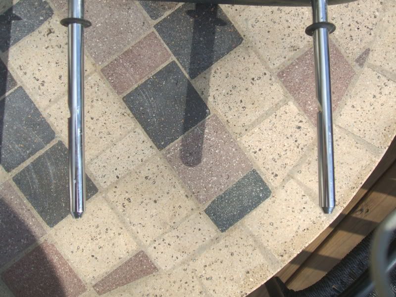

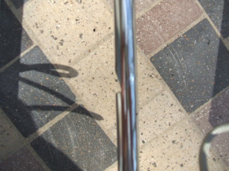

How to remove the headrests on the cavalier seats:
You have to really pull upward and work it from side to side. There is a notch that you can't see until the headrest is removed. They point to the right on both seats, and once you clear it, the headrest will pop right off. Hope this helps.
