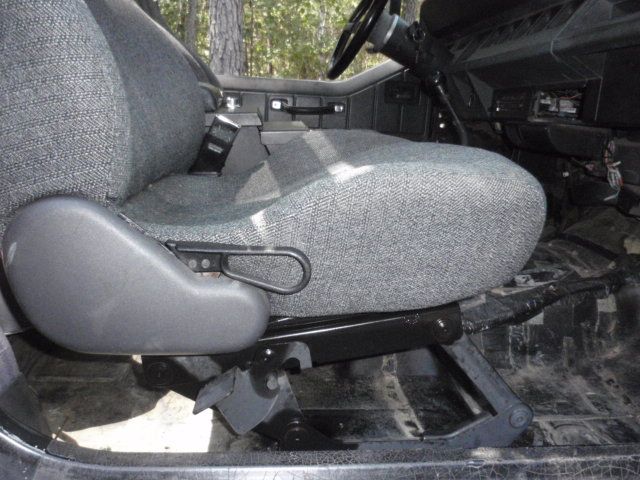

I went with seats from a '03 Cavalier 2-door, and they worked perfectly. The Jeep is a '94, and all you need to do is unbolt the Cavalier seats from the factory sliders, and they bolt directly to the Jeep brackets (no need for drilling).

Jason, the Cavi seats I picked up were he same year as to seats you picked up. The driver's seat, fixed bracket, bolted up no problem, the passenger side , tilting bracket, is waaaaaay off. I can get 1 bolt in, I'm going to need to drill a second in the front, and fab a piece of metal for the rear. I don't get it........ Same seats, 1990 YJ, and they don't go in the same.......

Just to confirm, you did take the seats completely off the Cavalier sliders/seat brackets and bolted them to the factory Jeep sliders?

Yes, the Cavi seat for the passenger side tip up was #1 too long for the Jeep sliders and #2 too wide in the front and too narrow in the rear. Was't anything that a piece of sheet metal and a drill press couldn't handle though. I'll post a pic of the finished product with the measurements in the morning.

Sorry, Cavi mounts too narrow front and rear. the Cavi measure side to side 13 5/16" the sliders are 14" and were too short by about an inch and a half. And yes, 2 door. cramped as hell in the back of that thing too. I took the back seat upholstery too and have a guy recovering the back seat of my YJ with it for $50.

Now the fun begins, as I am going to bolt them in, passenger NP after cleaning up the bolts, driver's (houston we have a problem) I forgot about cutting out the floor and patching, the outside of the seat I have no holes!!! then I realize after drilling, that the rear hole is in a support channel....with an itty bitty hole for access... I need itty bitty fingers.......... not fun with the sausage mitts I have!!!!
