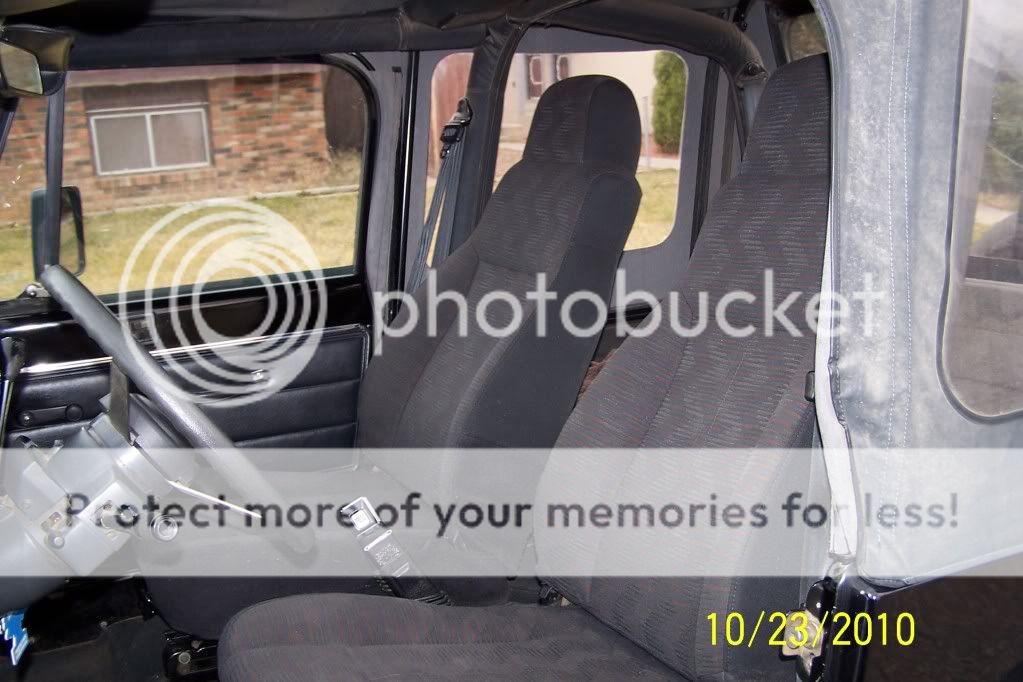

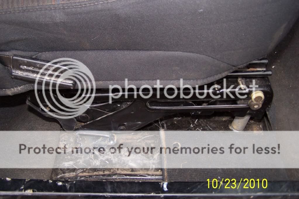

clarkjdg
clarkjdg's Avatar
Location: Plainview, Texas
Posts: 347
My seats on a 88 YJ, Before, and after!!!!
LIVE EVERY DAY LIKE IS WAS YOUR LAST...
What seats are those?
Zombies hate fast food.
RJC#512
RikRotorhead is offline
post #313 of 535 Old 07-19-2011, 10:48 AM
glenn-91YJ
glenn-91YJ's Avatar
Posts: 997
New seats look GREAT! What are they out of?
Interesting "WEAR PATTERN" on that old driver's seat!!!
