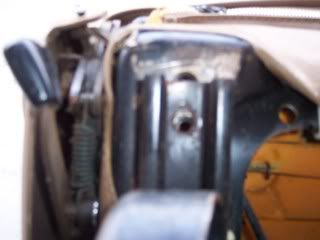

Here is the difference in the holes on bracket and the mount

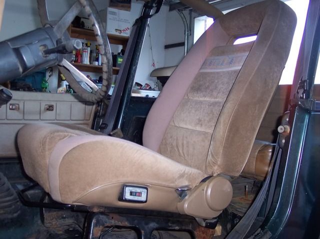

here is the driver seat out of the broncoII installed

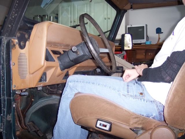

Here is the leg clearance my 18 yr old daughter has
