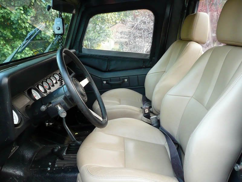

2005 Pontiac Grand Prix leather seats.
I unbolted the whole Grand Prix mount/slider assembly from the base of the leather seats. The rear seat mount holes lined up exactly with the stock Jeep mounts, all I had to do was drill 2 new holes in the front of stock YJ mount/sliders which were about 3/4" toward the back from the original ones and bolt them up. The stock sliders still work and so does the tilt forward on the passenger side. There was no way to use the Grand Prix electric slider without fabbing up entirely new seat brackets, and I didn't feel like doing that.

Alacran
Join Date: May 2007
Location: Buena Vista, Jalisco Mx
Posts: 403
Man! Those are nice looking seats. Almost too nice. I'd be afraid of getting them dirty. If you don't mind my asking what did they run you?

Posts: 557
Thanks! They were $265 including shipping. I got them off ebay.
