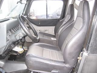

those Explorer seats do look good. For replacement seats, I'm a tall guy and can't afford to spare any more height in the YJ. I'd also like to keep using the stock sliders.
Think I'd be better to try replacement seats or something aftermarket for this? I'm not sure if it's possible to put a more comfortable/supportive seat and keep it roughly the same thickness as the stock ones.

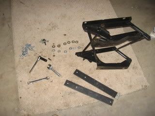

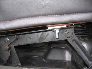

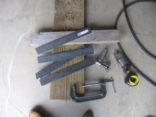

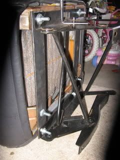

TJ Seats mounted on YJ risers
This was done over this past weekend. After "crawling" around different forums I finally installed TJ seats onto my YJ risers. Fab'd up brackets using 3/16"x2"x15" flat steel and using 3/8 nuts/bolts to secure. PITA!!
Now these things sit up a bit...actually a lot higher than the stock seats but these are too damn comfortable!!! Now gotta fiqure out how to go about modifying the risers to get em out of the sky a lil bit

Originally Posted by 93jeepyj View Post
looks good man, do you sit higher now with the tj seats. I think it was the 95 yj or maybe it was the rio grande package that used seats that look really similar to tj seats too.
Thank ya thank ya ...I sit up quite a bit higher..maybe an inch or two?!?, but these darn seats are the poop! really comfortable..I am actually thinking about modifying my stock risers to get them out of the sky a bit..

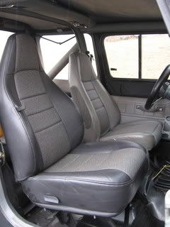

I put '04 Rubicon seats in my YJ. Here's a link to a pic that was posted from last years PA All Breeds Jeep show. http://www.jeepfan.com/offroad/pajee...eps08_0301.jpg It took a good bit of "fabbing" the risers since the TJ seats are about 4 inches thicker on the a$$ cushion, but, it was well worth it. Everybody that gets in my Jeep is amazed that it is sooo comfy. Plus I can wheel all day without the dreaded backache and "numbbutt"
