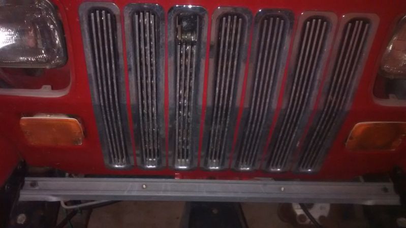

How in the world do I get these off with out removing radiator or grill? They don't seem to be snapped in.

Some I've seen were just clipped on. I'd probably just break them out or cut them out.

If there not snapped on its probably some kinda adhesive either glue or tape

push from the inside out... they clip in... maybe someone glued them too? but they should snap in... if you dont care about them, then it should be easier...

Last ones I saw were glued in with construction adhesive. Nasty mess. Check for clips on the back side. If none, start prying. Gently at first...

Mine are the aluminum ones and they are just press fit in through the backside of the grill. Those look different though they still look like you should be able to push them out from the back of the grill towards the front.

These are exactly like the ones I have in my YJ but mine are designed for the YJ grill. They work extremely well and look great.
http://ok4wd.com/drake-off-road-blac...ep-wrangler-jk#
The only thing that has ever dislodged them was a sizable hunk of ice that flew off of an SUV (who's owner was too much of a ******' to clean his vehicle off properly) and smacked my hood and grill at 55mph. I didn't even know for a couple days that I had lost 3 of them until I pulled into my brother's driveway and he handed me one that had fallen off in his driveway. I walked a 3 mile stretch of highway until I found the other two. One had been run over and flattened but it easily bent back to it's original arched shape. Both were all scratched up but a quick shot of rustoleum fixed that quick, fast and in a hurry. Not one fin had been bent on the radiator so I'm going to say they do their job well.
Edit: Mine aren't even installed completely for that matter. You're supposed to press them into the slots of the grill and then bend the inner corners of the grill slots behind the inserts to retain them. They're such a tight fit that I never bothered with bending the sheet metal of the grill in behind them.
