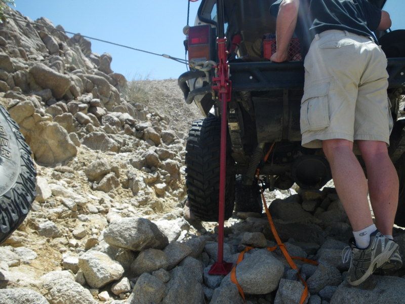

I don't have a "Hi-lift" jack, I have a "Jackall" jack. It's the Canadian version of the Hi-lift. At least it used to be. It's made in China now. Mine is quite old, but has never failed me. But I think the last time it was used wheeling, was when an XJ lost his front drivers side spring. Yep, no limiting straps.It's also been used a few times to get a couple of D35's up off the ground when they broke their axle shafts. It'll get it up high enough to throw a log under the axle.
In theory you are supposed to be able to ratchet strap one to a tire of a D35, with a broken axle, and it'll keep the tire on. But I've never seen anyone do it.

you mean like this?
don't have a picture from after the test fit with the handle and mechanism removed, but it does work.

Yeah, that's it.
It looks good in theory, but did it actually work? Driving forward, the front part will want to push the jack down. It looks like that part is addressed. But what about the rear wanting to push the jack up?

drove it out 4-5 miles like that. I think we wedged the jack handle into the spring or something to hold the back down; don't recall exactly.
Long story short, I have about 4 hi-lift jacks because people keep giving them to me after lugging them around for years and never using them. There have been a few times when it was just the tool for the job but mostly it's about jacking up the jeep and constantly trying to keep from having it fall over.
