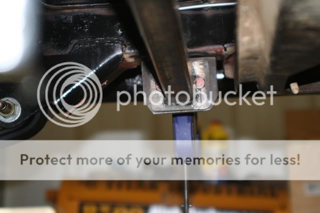

I have the MORE traction bar and I am very pleased with the work. Noticed a difference as soon as I drove out of the garage with out even getting on it.
I have the 7" long perches and they don't do anything when you get on it.
Here's the MORE traction bar installed on my 8.8
Shouldnt the shackle be going the other way (traction bar on top)?
