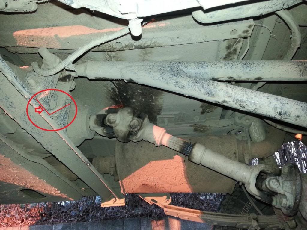

I dont know, I guess maybe it isnt limiting flex, but that it just looks small since I have 31's on it. My rear spring is inverted. I would have done the same to the other side, but I couldnt find a spot where I could pull up like this on the pass side. You see my lower shock mounts are as high as I could get them without limit travel too much. Plus the Teraflex bar helps. It also doesnt look as flexy since the passenger side wasnt able to go down, I could only pull up on this to see how high I could get the driver side to flex up since that is the side my traction bar is on and the side that would be the most restricted.
I really hate these pics underneath BTW, it all has nice paint and looks almost new. That mud is irresistible though.

U sure ur shackle moves?U have it mounted insider he mount, that's sort of unusual. Mayb loosen it up a little n see if it helps, make sure it swings nice n freely

Yes my shackle moves. Greased not too long ago, and not overtightened.

Can not tell are you running boomerangs in the rear?
I run a high misalighnmet hiem with spacers at the front part of the traction bar.
Seems to help.

My bar looks almost the same as yours. Bushings on axle and and pivot has a heim, except I run mine on the passenger side. I was curious about flex when I first got going so I tried flexing the rear. Did it once, measured then disconnected the heim end and did again. Got about the same measurements surprisingly. Running RE 1.5" springs.
Also out of curiosity, what angle is your pinion at compared to your output yoke? Looks a lot lower than the 1-3 degrees recommended.

Nope, angle is fine. Pic is while it is flexed so it looks weird. I have no vibes at all. It is 3 degrees on the dot. I mounted mine on the driver side since the 8.8 is offset a couple inches to the passenger side. That way I kept it as far towards center as possible.

Looks like the angle of the shackle might be hitting the crossmember at full flex. If it were me I would try drilling a new hole further away from the crossmember so there was no chance of contact between the two.
