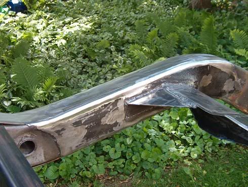

Make one, it's not that difficult. Here's a picture of one of the last frames I've rebuilt & this one has both rear X-members. The one at the rear is made from a piece of 2" x 5" x 1/8" rectangular mild steel tubing - I get 2 out of 1 piece of tubing, I cut the tubing in half length wise. The next one in (the one in front of the fuel tank) I make from 4" x 4" x 1/8" square mild steel tubing, again cut length wise. In addition, I use a few other bits & pieces for brackets etc to finish them off.
Before you start to cut, measure the old cross members & transfer all the measurements to the steel tube (measure twice) and then cut it all to shape, cut all your bits and pieces, and then weld it all together. I weld all the pieces into place on the frame before I smooth it. For smoothing I like 60 grit flapper disks for my 4.5" angle grinder. I mark and cut the body mount holes last to get the spacing proper (use a hole saw for the holes).

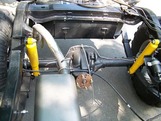

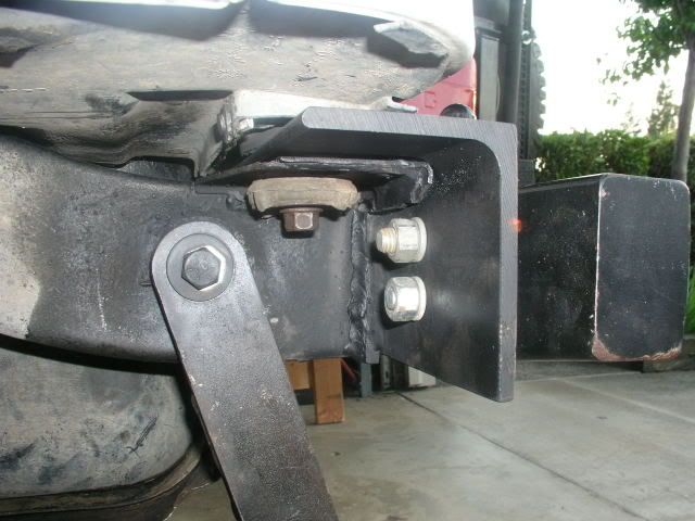

Here are a couple more pictures for the x-member in front of the tank:
This one shows you some of the extra bits I welded on to make it look like the original - I found that some of the strange shapes actually had a use when I got around to re-assembling this jeep.
This picture shows a gusset I welded in to reinforce the corner at the frame - similar to the original.
This is one showing the painted frame and the tank, axles, etc., installed:
