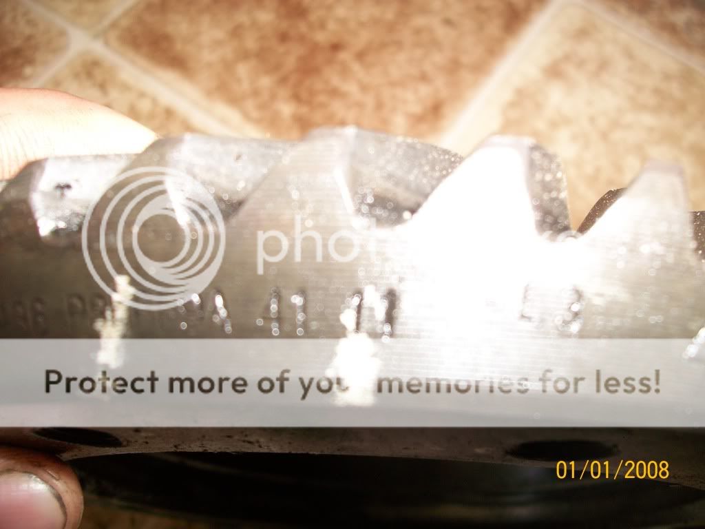

What the easiest way to make sure of the gears that I have in my axles?
Dave83 is offline
post #12 of 117 Old 11-21-2011, 09:01 PM
94chb
Location: Whitwell
Posts: 1,936
open the rear cover and look at the numbers on the ring gear, the last 2 big numbers are the # of teeth divide the numbers and thats your ratio
41 11 = 3.73
39 11 = 3.55
40 10 = 4.10
and so on

post #13 of 117 Old 11-22-2011, 10:09 AM Thread Starter
Dave83
Location: Midland
Posts: 62
Ok so from what u said mine reads 43 14 and that comes out to 3.07 does that sound right?
Dave83 is offline
post #14 of 117 Old 11-22-2011, 10:40 AM
94chb
Location: Whitwell
Posts: 1,936
yes thats right, the 5 speeds came with 3.07s
