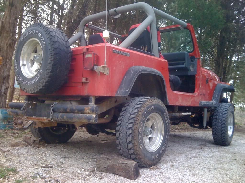

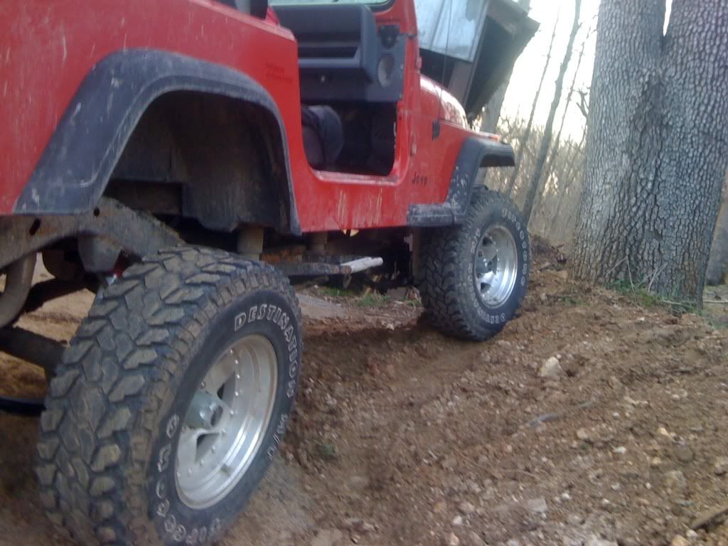

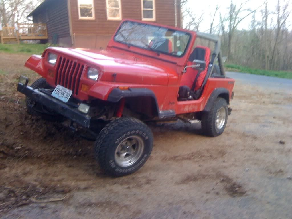

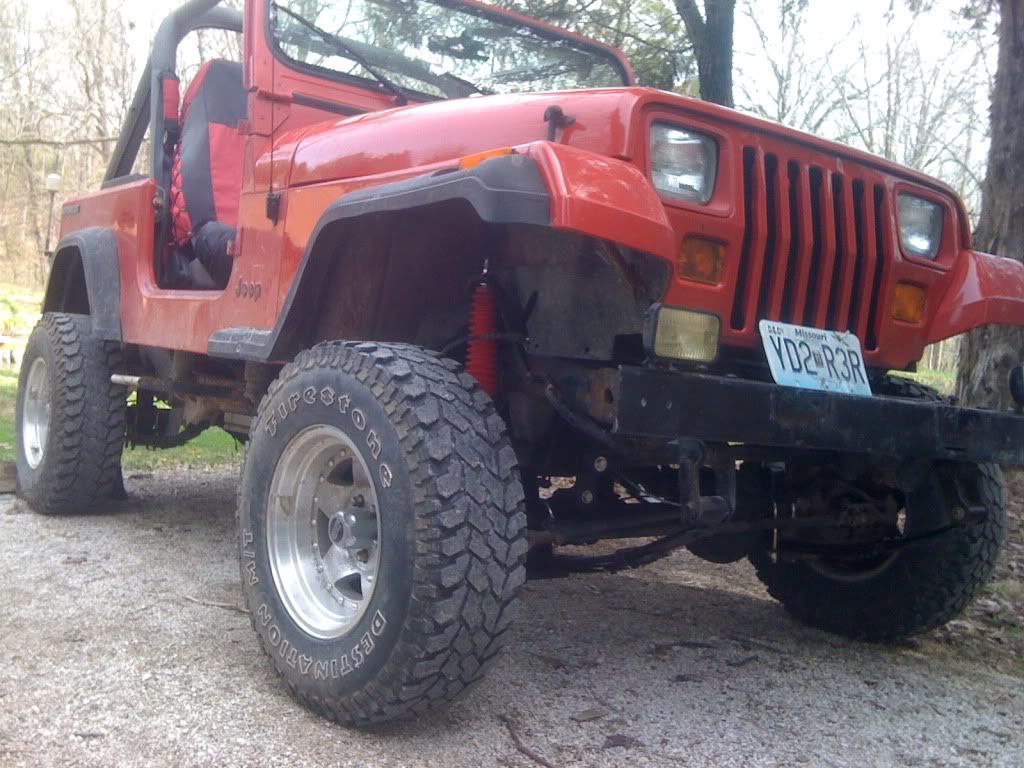

I did mine Saturday. Took all day, I had to use a cut off wheel on 3 of the spring bolts, and the Pittman arm was a *****, but it was nothing I didn't expect. All in all I'm happy with it so far!
Some attempted flex pics, but the springs are still pretty stiff. This was the day after I put the lift on.
