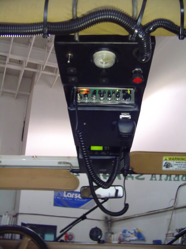

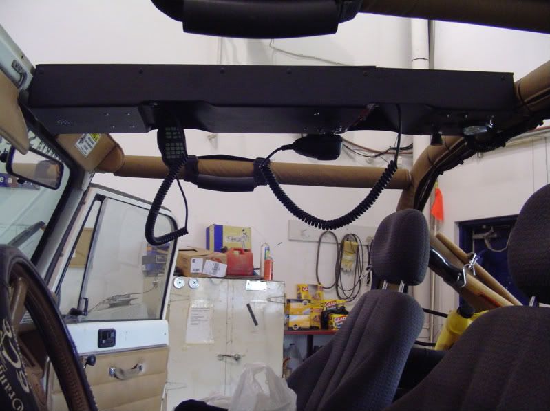

Personally I think that's a waste of usable space. Get a minivan console to replace the stock one in the Jeep and build your own overhead to hold your comms and aux light and winch controls. I copied the Tuffy design since I wasn't about to spend close to 400 bucks up here for it. This only cost me about 50 bucks to build.

I like that...........any more pics?

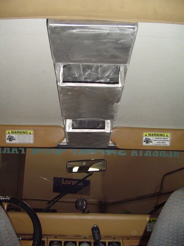

Here's one when I was still fitting it.
All Aluminum TIG welded together. Machine screws tapped into the windshield frame and U-bolts to the roll bar...just like the way the Tuffys mounts.

Thats really nice! I was thinking about making mine out of a 1/2" board of MDF with padding and polyester water-proof fabric. And I really like the dome light. Where did you get it? I have discovered that the right one is harder to find than most would think. Except I found one on NAPA's site for around $8 that would hopefully work.

Thanks That's exactly where I got it...NAPA. It's one of the flush mount backup lights that you put on trailers. It's wired to the switch right on front of it and direct to 12v power from the radios.

I know that this is an old thread... What were the dimensions of this console that you made? Im looking at doing this as well and would like to copy your design as well.
