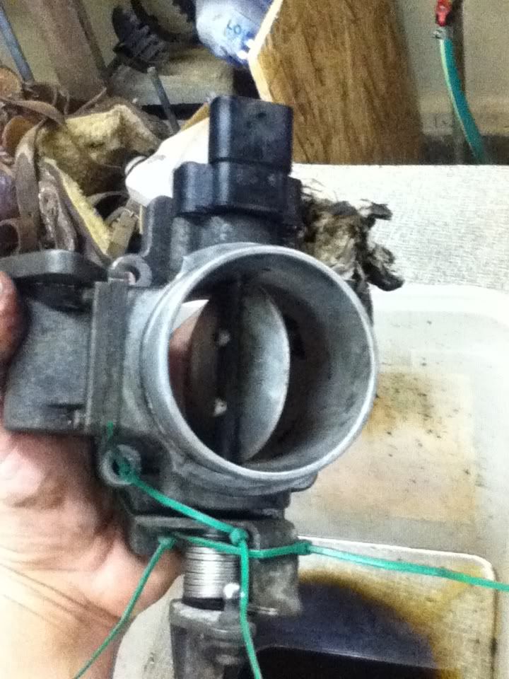

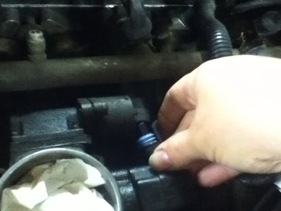

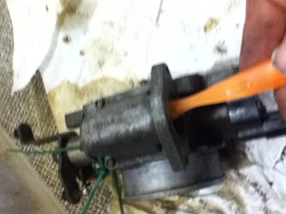

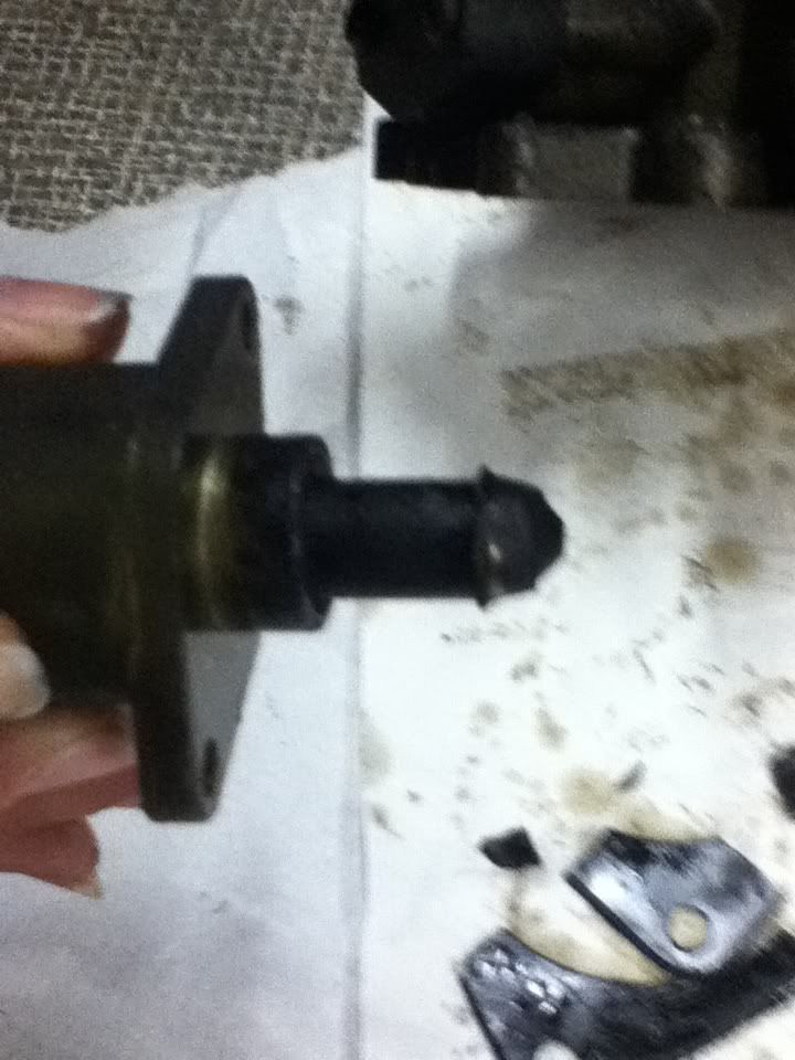

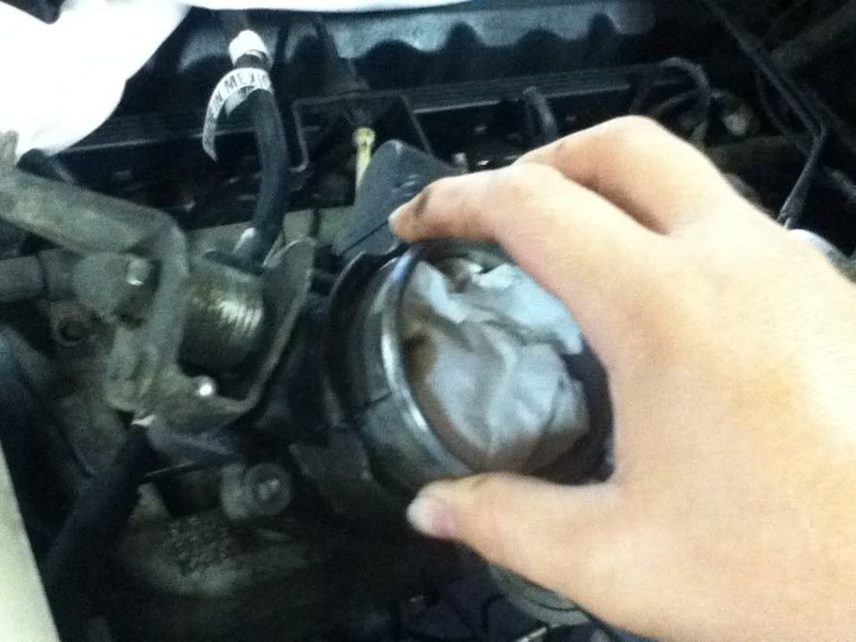

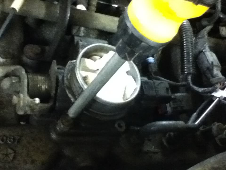

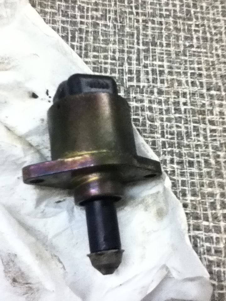

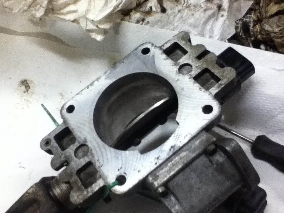

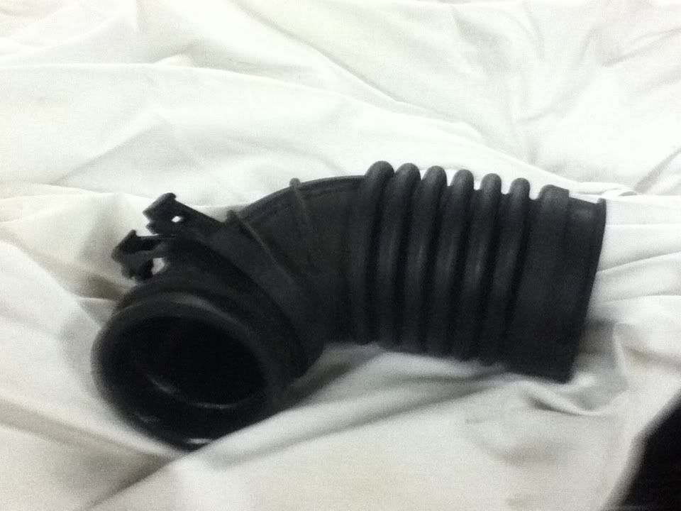

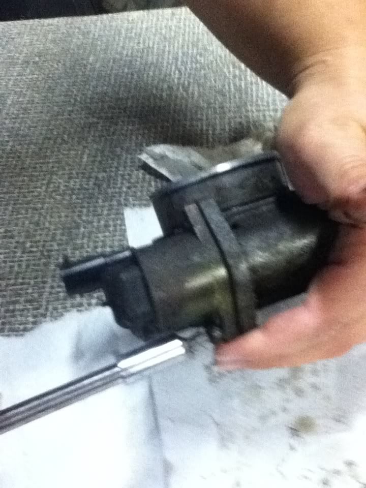

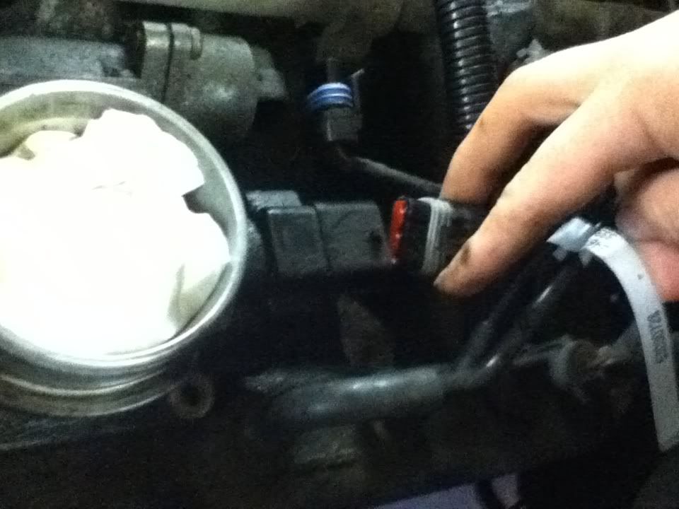

Thanks guys. I've gotten most of it done I think. Here are a few pics.. am I missing a part that is removable? I removed the IAC, didn't realize the TPS comes off. I'll have to go back out and look at that again. (feel free to correct anything I use the wrong terms for)
removed air box tube
Removed the throttle cable (no pic)
Disconnected the TPS
Disconnected the IAC
Removed 4 bolts holding the TB
Remove TB
Remove 2 small bolts holding the IAC & separate
This is where I started cleaning.
Halfway - I used zipties to hold the TB open to make cleaning easier
Done cleaning
Newk76 is offline   Reply With Quote

If you really want to get it good you can take a security torx to this housing and remove it too. But it's probably just fine how you did it.

Looks like you got it pretty good! Getting the IAC squeaky clean on the business end of it will probably make the most difference of all.
