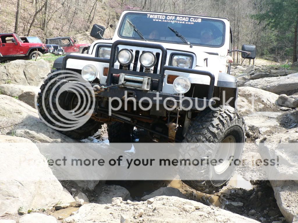

I run the 37x12.5x15 Radial Rockers. Great tire on and off road. I have 11 oz of air soft bb's in each tire and they are balanced perfectly. No serious vibes all the way up to 80mph. I have around 1500 miles on my tires and the tits on the tire is still there. Im confident I will get a good amount of use from the tires. I run mine at 24psi on the street. I also have a 15x10 wheel.
They are somewhat loud driving down the road, but not super loud at all. About as loud as a regular MT I would say.
With your amount of lift you will be fine running the 35s. My step dad runs them as well (35x12.5x15) with 4" RC lift and 1.25" booms and has no rubbing at all. You will be fine.
Oh and offroad...well yeah...they kick ***.
Blue YJ is mine (37s), white is my step dads(35s)
