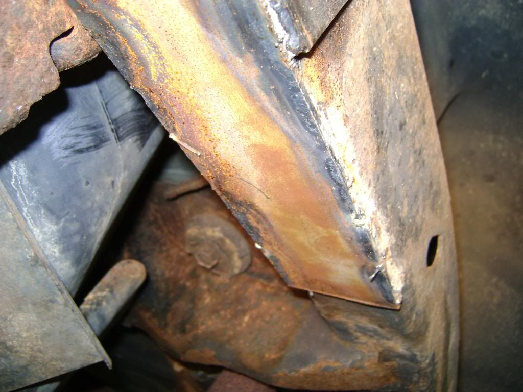

I will agree that it's not fender gauge metal, but it's far from 1/4".... The first photo shown appears to have heat buckling on the side that is not welded. There is no way that 1/4" would do that and even 3/16" would be a stretch to get up the heat needed to warp it out like that. I do think the bottom patch is thicker than the sides too. Photos can lie, so without looking at it, there is no way to tell, however, for a patch, it's not up to par on gauge, prep, or design. I am also not a fan of a straight weld seam on frame repairs, a better repair would be to have them diamond the ends, and allow the new section to over lap about 3" of good clean steel. Then add a couple plug welds in that area in addition to the welded patch.
Better still would be section the rail from the same diameter as the stock rail and then fishplate over the repairs with full edge welds and plug welds in the middle.
Here is a photo I grabbed off Google to show what I am talking about. (not mine, but it is from a Jeep.

Oh, don't get me wrong.... I think the replacement plates are a great repair, and the welds on yours appear to have great penetration. A couple 1/2" plug welds would of been perfect at the ends of the cut frame areas. Also, a proper application of weld-through primer on the patches and the old frame will help keep the rust at bay. Followed with a rustproofing sprayed inside the frame. I like a mixture of chainsaw bar oil, and automotive rust-proofing. Not a big fan of spray under-coating as it seems to just love to flake and cause more rust. In a pinch, brush application of Rustoilzum rusty metal paint seems to really stop/slow rust and it holds up well.
I would love to see a photo of the edge of the side patch just to see how thin it really is though. It's obvious left over scrap in the shop based on the odd rust patterns and crop circles present on the patch.

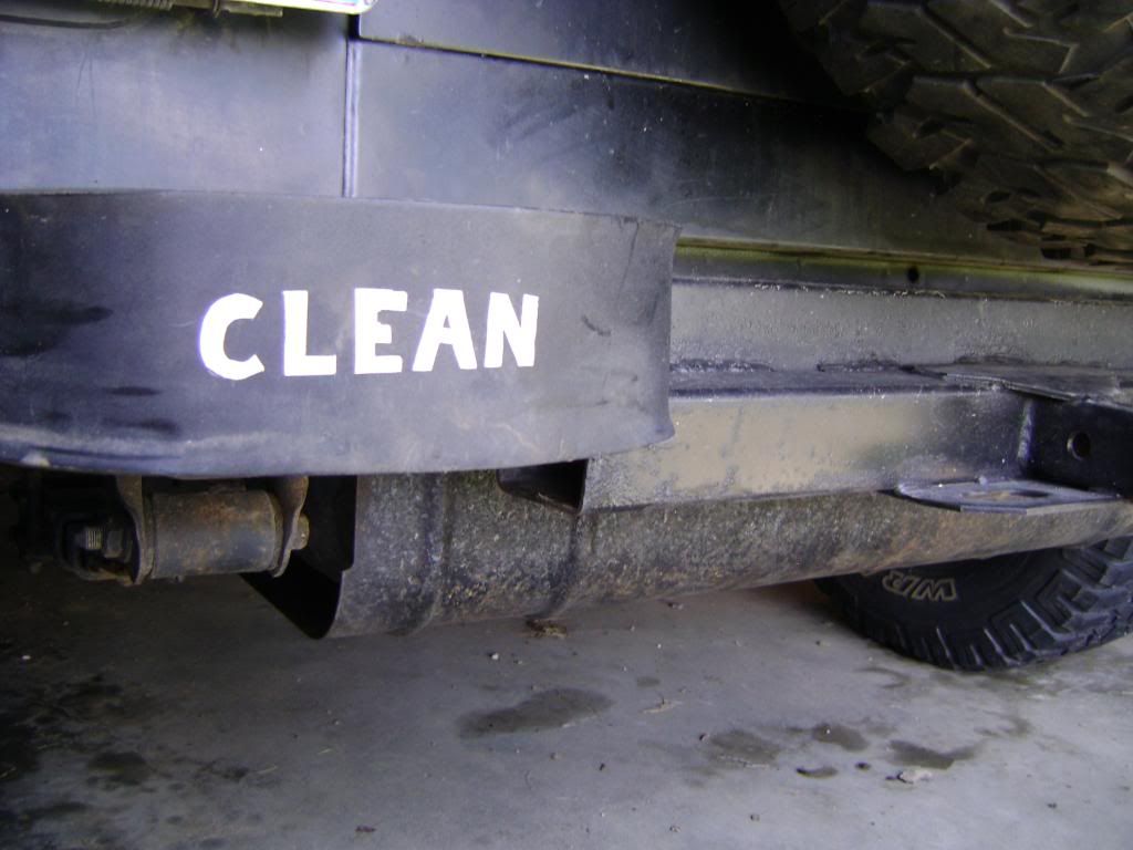

Ok ok ok ok... I'm going to take a bunch of quality pictures of the hackey patch for you all and post them as I have tomorrow off. Those are crappy cell phone pics. I also have some of the original cancer, which was pretty hardcore. Also going to measure the metal that they decided not to weld so I can get a thickness for you all to think about. Clearly, this is an example of HOW NOT TO DO IT so I might as well get detailed!

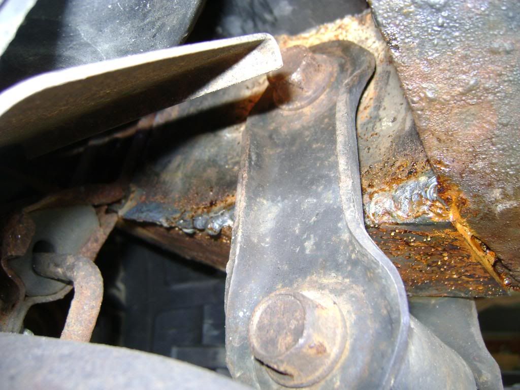

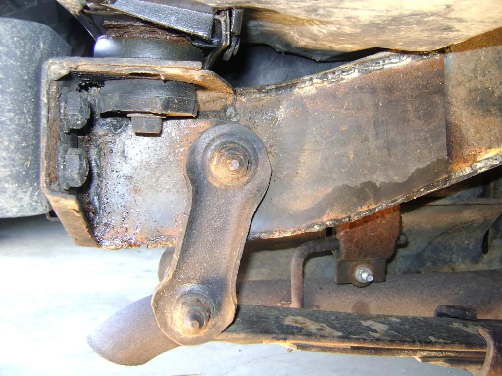

Ok, scrath the productive. A girl came over and distracted me all day on my day off, then band practice, so nothing much got done...

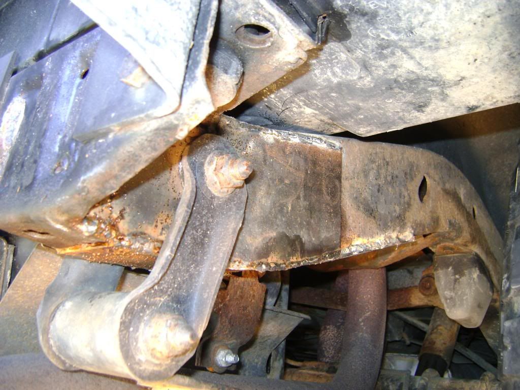

BUT today, I went to meet with the head welder over at my auto shop. He says that yes, it's an ugly, unprofessional job. However, the welds seem to have penetrated deep enough as far as he's concerned. He also says that you should NEVER weld vertically along the frame and that's why that one side is not welded (though he seemed to think that it should have been a V shape horizontally into the rest of the frame to be stronger).
He says that having seen what it was, this should suffice for a solid fix for the time being, but that I should consider getting the weld-in sections. He says I got more than my money's worth for the $200 hack job or no.
He said to grind it all down and treat it with frame saver when I drop my leaves for the lift. Camera fogged up with the moisture in the area (storming hard as hell). Pics soon.

IMHO, that is a LAME excuse not to weld the side! I agree, it needs to have a > or better still a Z section. But to say it was better to just not weld it and let all that water and dirt to fill into it?? Come awn...
There may be a slight butt covering on both sides, but I think that there are some welds good enough to keep it on there and not let the spring fall off for road use. I have said all along that for $200, it was not enough to properly do this and you did not get taken too bad on that end. The point is that there is no excuse to hack a job that bad as a welder for hire. If the guy can not afford to do it right, don't hack a repair to save them money... That is a sure way to a heavy lawsuit down the road.
I would not grind it down, leave it as is for now and get some paint on it. Those sparks are going to fly heavy around the gas tank doing so. Too risky for little to no benefit other than to polish a turd of a repair. Wait until it's chopped right out and do it right. I highly suggest the repair ends that Q-Tech sells though. Replace them and fish plate over the sectioned ends for a great repair.

That's the plan for the future. A REAL fix. For sure.
Only real grinding I'll be doing is getting rid of that bead that seems to be touching the shackle. Just one little glob. I could probably get away with hand-filing it, to be honest...that minimal.
So, next up on this thread is going to be the lift process and the problems I'm sure I'll run into installing it. If I can ever get to it, pictures are surely on the way.

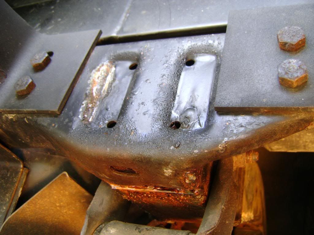

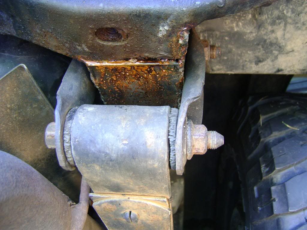

OK...time for some pictures! First, the cancer itself:
aaaaand the crappy patch job:

Welcome to the Wild World of Corrosion. Anybody get their booster recently?
