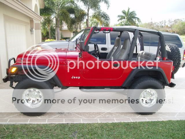

i put tj flares on my yj gave me a lot of room in front an rear

[IMG][/IMG]
